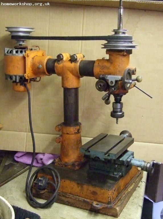

                  There are (or were) some files on the DW Yahoo group, but they seem to be invisible at present .
                  But here's what a Westbury looks like (except this one has a non-standard short table)
