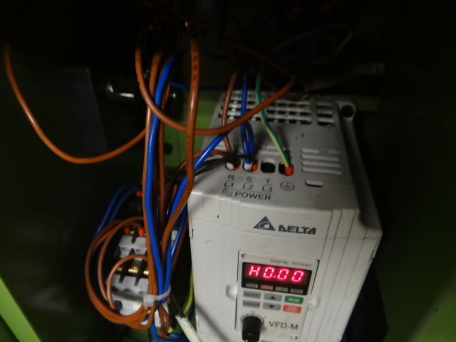

          Just spotted you have a new problem David. I agree with Les, the symptoms sound like a a loose connection, quite likely caused by your recent rummagings inside.
          With luck me taking a few photos in anticipation of another visit from the gremlins will keep them happy and you'll never have another problem! However, what you may be looking for next is behind the back panel.
          First, top view of the VFD and the power input connections. Might be one of these loose.
          Note that the VFD is switched on, there is no error code displayed, and the (blurry small) red STOP light is on, meaning the VFD is ready to go but the motor hasn't been activated. This is normal.

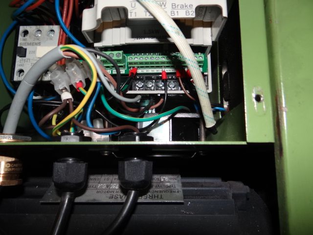

          Second, on the lower front edge of the VFD is a flip up cover guarding the control and motor connections. The red-ended control wires connect to the small green terminal block . The larger terminal block underneath is the motor connections.
          One of my red-ended wires looks suspiciously loose. If so I just did it by rummaging around…

            Thanks Dave for posting those two pictures of the VFD. at least it looks like it is easy to get to for D.A.G to check the connections.
            PS. I have copied them for future reference.
            Les.
