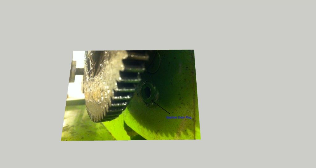

      I've had my Ltahe now about 5-6 months and the manual says to change the gearbox oil and recommends Mobilgear 627 – I just wondered what others were using. But also I don't like the look of the drain plug for the gearbox, almost looks like there is some weld around the plug. The oil in the sight glass still looks like new and I'm wondering if I should leave well alone – by the time it gets dirty I will likely looking to upgrade the Lathe anyway?
      The manual makes no mention of there even being any oil in the Apron but it clearly has a sight glass and there seems to be a 'plug' of some sort under the Sight Glass on the bottom of the apron? The oil in this sight glass is dirty as you can't even see through the glass so I guess I should at least change this. Does anyone know if there is a seal I should get for the plug before doing – the manual shows the 'plug' as a screw on the parts diagram – but I don't think the manual is completly up to dat maybe..
      Sorry I've done this very quickly and the photos are terrible..
      Maybe this model lathe is a bit new for there to be many looking at oil changes yet..
      Just wondering really how often others change their oil in these type lathes, what oil they use and if I should leave that gearbox plug well alone, for the time being anyway..
      Thanks
      Garry

        #200318
        Simon Collier
          @simoncollier74340
          I changed the oil on mine once, after about a year, and not since (about 8 years). I used 46 hydraulic oil I think.
          #200323
          GarryC
            @garryc
            Thanks Simon – wow 8 years!
            I'll have a think but maybe I'll just leave well alone then, for the time being anyway. A lot depends on whether I can use the Lathe for my next project or if I'll be upgrading sooner rather than later as well.. At the rate I'm going it'l take me another year to finish what I'm doing now first though…
            Cheers
            Garry

                Search for "lubricating lathes" and you'll find some information there.
                There is a site http://journeymans-workshop.uk/lathemaint.php covering the gearbox oil change for a Warco WM250V, if you follow this see my entry in the above "lubricating lathes" should you want to use car gearbox oil.

                    Thanks everyone, I've taken a copy of the link (EdH). I'll wait a while I think and see if the Gearbox Oil at least starts to look dirty – its looks like new at the moment. I was half expecting to hear I should have changed it by now but sounds like theres maybe no rush just yet..

                      I just top up the gearbox and apron oil every couple of months, not drained any myself as the lathe seems to be "self draining" if you know what I meanwink 2 Warco head oil for both.

                          I had a jamb up on my WARCO due to letting the cross slide travel too far across the bed, so I had to take it to bits to un- jamb it. Glad I did really as there were bits of stuff floating about in there that shouldn't have been, so it got a good clean out. If you wind the cross slide across the bed, a gap will be visible that allows stuff to get into this gear box. I can't see how you can stop it getting in there. The upside is, that you can dipstick the oil in there to see how much oil should be in there. If you put too much in it will only leak out until its correct level is reached.

                            Big thanks for that – really useful as my 'sight glass' for that gearbox is completely black and so I can't see the Level – I can have a look tomorrow now…

                              Although not new one, when I bought my lathe one of the first things I did was change the oil as a matter of course as I had no idea how long it had been in there and importantly it was of an unknown quality. IMHO it really is false economy to put budget lubricants an any machine of any type.
                              I also fixed a strong magnet in there to attract and keep any wayward swarf that might come out to 'party'

                                From my own experiences with new Chinese lathes it is definitely never too early, at any time, to change the oil or at the very least check its condition, in any oil filled gearbox they have,
                                At our budget end of the market some, not all, but definitely some machines are assembled with all sorts of filth in there, as well as sometimes just dirty old looking oil. The two new Warco 1330 lathes I was given were horrific inside, so I would always check and change the oil straight away, or as soon as you can.

                                      I phoned Warco with the same question, and their response was that the unit was effectively lubricated for life, and suggested I don't bother.
