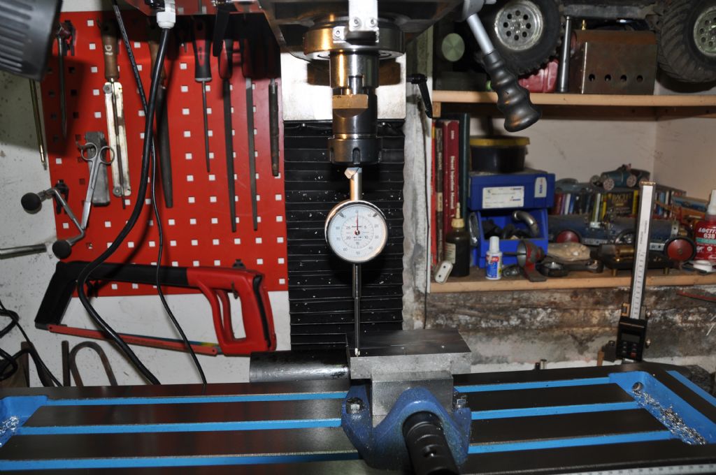

        As coincidence would have it, I bought the Weiss version of your mill, last Friday.
        Fwiw, I thought I would test a piece, to see how it compared with yours.
        With no flaffing around setting things up too much I ran a facemill over a block of
        aluminium.
        The ally block is 70mm x 125mm and the facemill is RDG's 63mm carbide insert.
        I ran two cuts along the block cutting on the x axis, bringing the block forward with
        the y, for the second cut.
        With the dti as shown, I had 0.01mm difference betwixt fore & aft (70mm apart).
        Edited By Daniel on 25/04/2018 15:21:32

            Duh … I forgot the photo smile p
