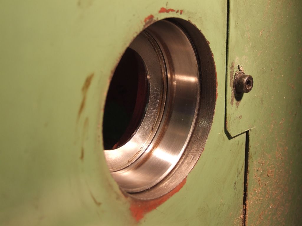

        Hi all,has anyone fitted a headstock lubrication system to a Warco WM250 lathe? Because the only way to lubricate the two taper rollers is to dismantle the whole spindle assy,which is far from satisfactory.I have a pair of drip feed oilers which I was planning on fitting but………………the way the bearings are fitted seems to preclude this idea.Any thoughts welcome.
        Regards Pailo.
        #77441
        MoosE
          @moose
          The WM250 manual leads one to bbelieve that the headstock is lubricated from the gearbox below. Not the case! I agree with Pailo there is no easy way to lubricate the bearings apart from dismantling. Leading on from this: My machine is about 18 months old and recently after working it for about 1/2 hour at full speed, the spindle rapidly decelerated accompanied by an awful noise as the motor struggled. Switched off quick! The whole headstock was very hot and the spindle extremely stiff to turn.
          On dismantling, the split spindle adjusting nut was unbelievably tight and its two lock screws had not been tightened sufficiently to properly lock it. There was very little grease on and around the bearings. So, failure caused by excessive pre-load and insufficient lubrication?
          The chuck-side bearing has a wear mark on the outer race (dark ring in photo 1) and a corresponding mark on all the rollers suggesting point contact and an error in the bearing tapers. Anyone else seen this sort of thing before?
          Cheers,
          MoosE.

                        Moose Hi.
                        Difficult
                        to be precise without actually seeing the bearing but I doubt it is
                        poor manufacture, rather it appears to be a classic “smearing” failure
                        from your pictures. Obviously could be caused by a simple contamination
                        problem but is mostly caused by poor assembly technique, particularly as
                        it has run for 18 months or so. Basically the bearing is assembled with
                        the two races slightly (very) misaligned. The excessive pre-load is
                        applied without rotating the bearing causing the races to fail to align
                        correctly and the rollers to be extremely tight at one point and fairly
                        loose on the opposite side. The rollers then constantly slow down (loose
                        area) and rapidly accelerate and skid (tight area) leading to the type
                        of failure you have. The problem is quickly exacerbated by lack of
                        lubrication. It is sometimes noticeable by a slight tightening as you
                        rotate the shaft by hand but not always as it is easily hidden by the
                        drag of other parts of the drive system.
                        There
                        is a good explanation of failure modes of roller bearings produced by
                        SKF and will easily be found with Google if you have the odd hour to
                        waste.
                        Best regards
                        Keith

                              Hi Gunnar,
                              I had exactly the same difficulty. The drive-side bearing inner race was so tight on the shaft it was impossible to "feel" for it tightening and consequent risk of further damaging the bearings. I carefully eased the shaft down with a strip of fine abrasive cloth, cleaned and oiled the shaft and re-assembled. Much better!
                              Did your bearing race and rollers look like those in the picture above?
                              I couldn't figure out how to remove the outer races without damaging the headstock casting so had to put the original bearings back. Used molybdenum disulphide grease (Castrol MS3) and the machine has since done a considerable amount of good work.
                              Cheers,

                                I had a very hard job getting my 280 spindle bearings out when they suffered the same fate. Managed it in teh end and did get the outer races out of the head.
                                Fitted FAG bearings and it runs so much smoother now but still could not easily judge the load needed to tighten the bearings.
                                J

                                    Easier than getting the spindle out and the bearing off the chuck end but still not easy. I cut a bit of 1/2×1" to bear against the back of teh bearing shell, drilled the middle for M12 clearance and then used another bar against the outside of the head casting and then would it out with a M12 stud down the middle, still needed a lot of effort.
                                    Anyone thinking of changing the bearings on one of these type of lathes would do well to have a look at this article on Arc Euro's site, there is a sketch of how to make up a puller to get the spindle out

                                        Just to put this all in context, I used a 5Ton hydraulic ram in a specially made jig to remove and refit simlar (larger) bearings. The final set up was done by measuring the rotational torque once the bearing was up to running temperature. I left the bearing fit on the spindle as per manufacturer. (damn tight).
                                        #88950
                                          Thanks KWIL, I'll know where to come if I have to do it againwink, hopefully not for a long time and I also added a grease point so I can pump in a bit now and then.
                                          J
                                          #88954
                                          KWIL
                                            @kwil
                                            Jason, there is a photo added for your dilectation.
