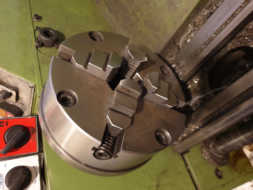

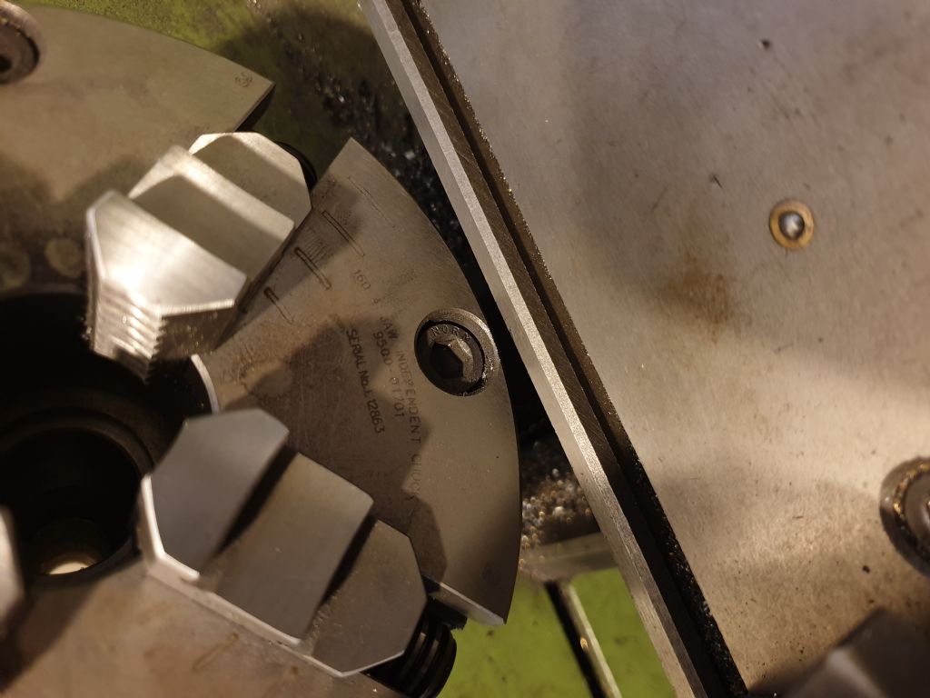

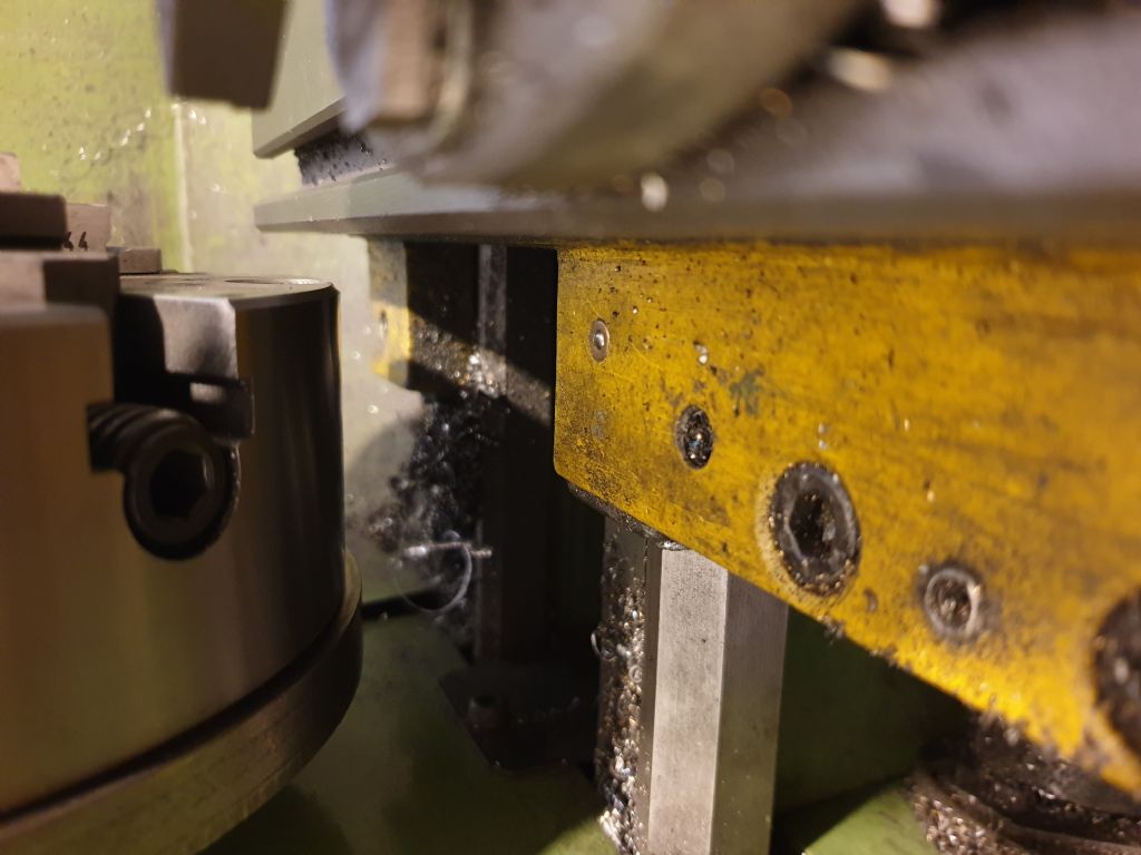

                I have a 160mm chuck on a Warco 250. The leadscrew cover stops the cross slide hitting the chuck body but if you're holding large diameters it is definitely worth checking the jaws and cross slide have clearance.

                  Seeing that 160mm chuck, 6.3" on the lathe suggests to me that even a 6" would be too big. The jaws cannot be positioned much past the OD before hitting the bed, so your 5" could probably hold larger diameter stock.
                  #421354
                  FatWelshBoy
                    @fatwelshboy
                    With the jaws the way around in the pics the chuck can hold 90mm dia stock and just clear the cross slides bed, it wont crash due to the leadscrew cover. Chances are with a tool mounted you'd hit the jaws with the tool tip first anyway. I haven't checked with the jaws reversed but when I took the skin off a 130mm dia piece of cast iron there was loads of clearance.

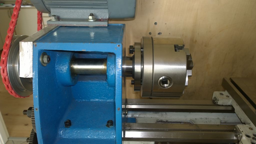

                      From my Boxford days with screwed on chucks,faceplate etc it has become a habbit to take them away again as soon as job is finished.
                      Enterring the chineese bolt chuck country was a maddening expirience.
                      I have thinned the flanges of all the four blue lathes I have had.
                      Chuck change is now less than two minutes start to stop.
                      My advice will be to get the lovely non chinese 6 inch chuck and exchange the 5 inch chucks for 4 inch dittos.
                      4 inch chucks are so much easier to handle and put on spindle and will do 95% of the jobs.
                      Picture is a 5 inch taking off from my WM250 lathe.
