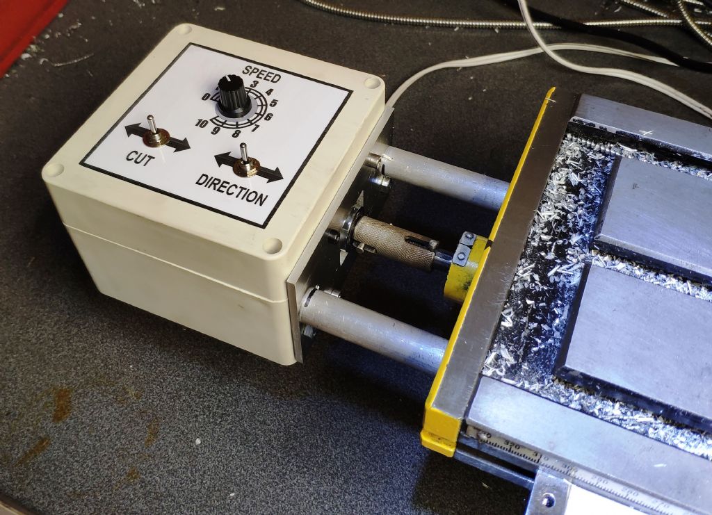

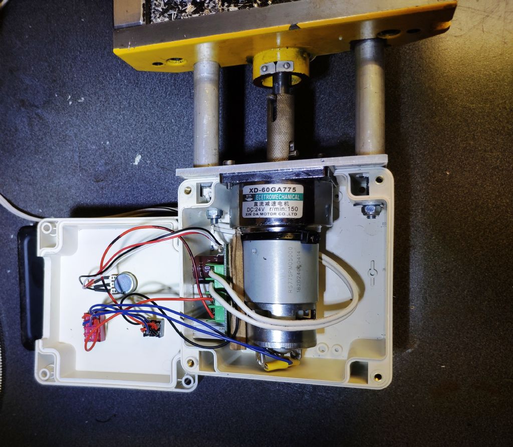

      I've just acquired a Warco WM16 milling machine and wanted a X axis power feed for it.
      I came across Mikes workshop **LINK** and liked his approach.
      I've beefed up the motor/components to cope with the larger mill.
      All the components were purchased off fleabay for around £45.
      24v 150rpm gearbox motor 35W peak.. Runs at 11W on fast return on my mill.
      24V 3A power supply unit
      120X120x90mm Waterproof plastic project box
      20A PWM Speed controller Module
      Couple of switches
      The power supply is adjustable slightly via a pot, so I've set it at 28v . The lead screw is a 2mm pitch and with this motor & gearbox gives 35cm/min fast travel. It slows down to absolute crawl yet still has enough torque to cope. The Power supply is screwed to the wall so the cable to the powerfeed is a safe low voltage.img_20190904_183844.jpg

            Steve, do you know whet the gear ratio is on the gearhead to give the 150rpm at 24V?
            #428479
                Jason, If its the motor I think it is (approx 5000 rpm) then 33/1 but dont quote me on that, there are a number of models in this range 12 volt and 24 volt and the spec given is often not that accurate.

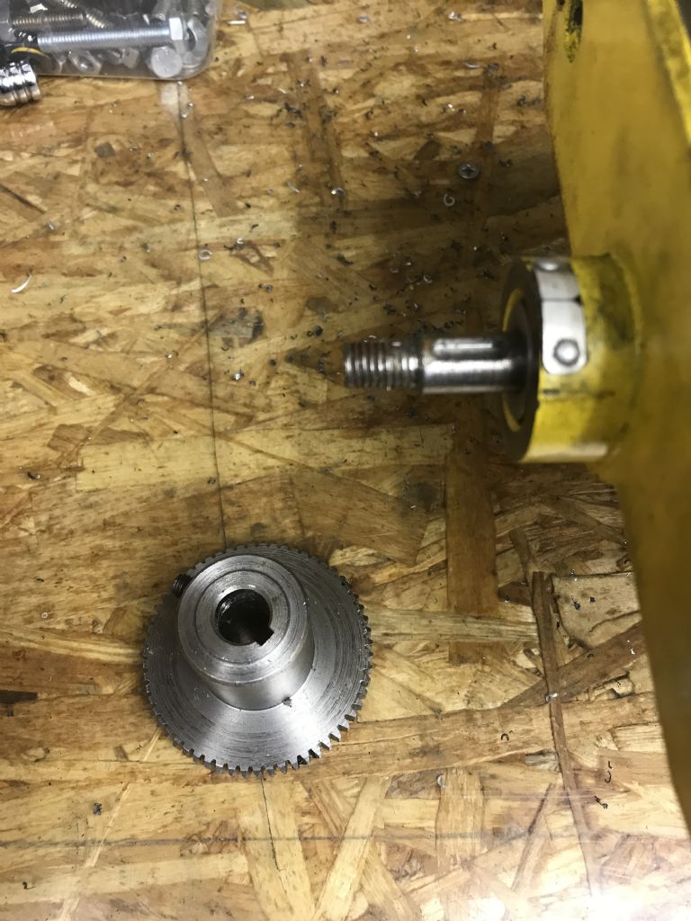

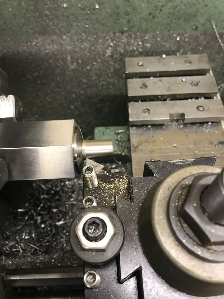

                            I have gone the Purchased power feed route and bought one of these from Warco for my WM16
                            and as expected as its mean't for a WM18 I need to change a few things
                            I will post as I go
                            Trevor
                            #434666
                            Trevorh
                              @trevorh
                              So with the handle removed the first problem was the shaft size vs the gear bore

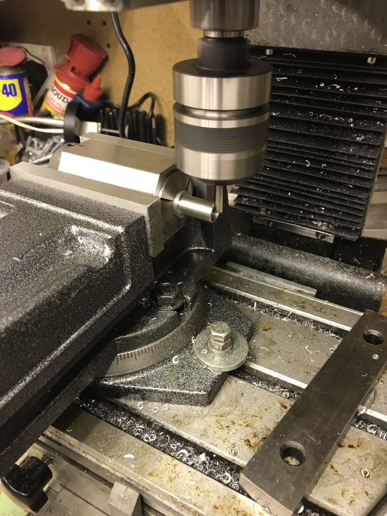

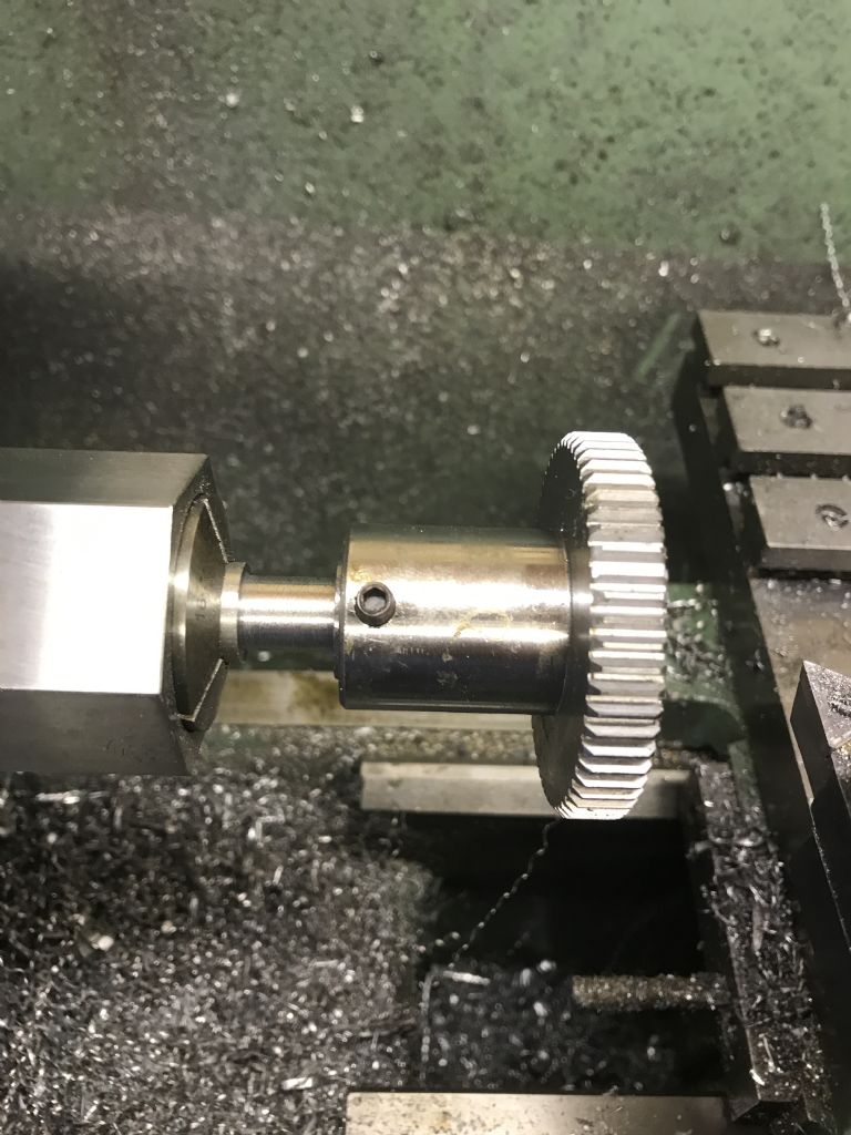

                              not a sliding fit – more a throw on from a long distance so I machined a bush
                              This at least got the gear fitted nice and true
                              next keywayed the bush keeping it in the collect
                              next onto the actual main body but thats for another day
                              trevor

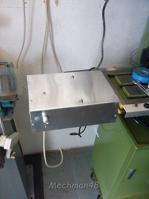

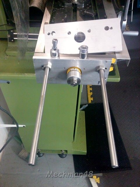

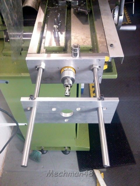

                                I have fitted a similar system to my WM16 using a 12v wiper motor free gratis, a 240/110v to 12v dc transformer eBay, approx £12, a PWM with on/off switch, eBay again, approx. £5, 2 pieces of 10 mm aluminium plate free gratis, some bit's n' bobs from scrapbinium box, universal joint from defunct socket set, stainless steel sheet from skip diving, 'e voila' a working 'X' drive. It doesn't have fast forward/reverse ( yet thinking ) but on full PWM speed it copes very well, can't remember what mm/min it does at the mo'.
                                George.

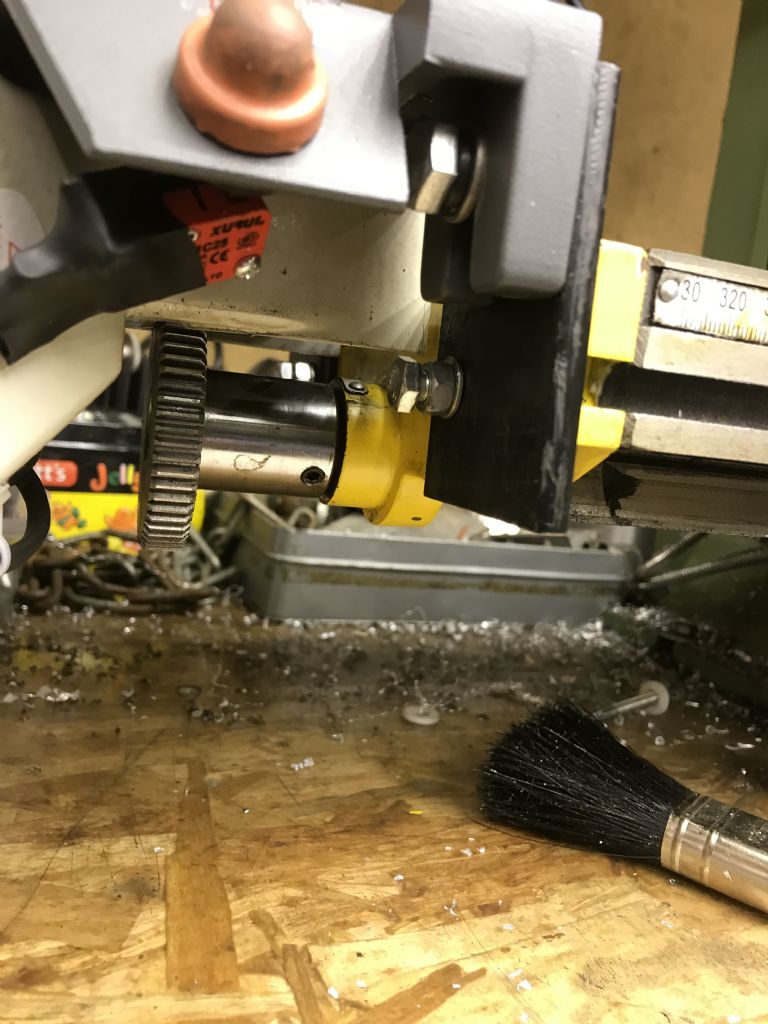

                                  Hi George, very nice, honestly yours would have been beyond my abilities, so this is what I ended up with
                                  just had to add a stand off plate to get the drive gear in the right position as shown below
                                  and we were good to go
                                  Not sure that I am going to fit the auto return end stops and switching gear tho' 1. takes up quite a lot of room 2. I will always be there operating it so the chances of it traversing that far is quite slim
                                  Trevor
