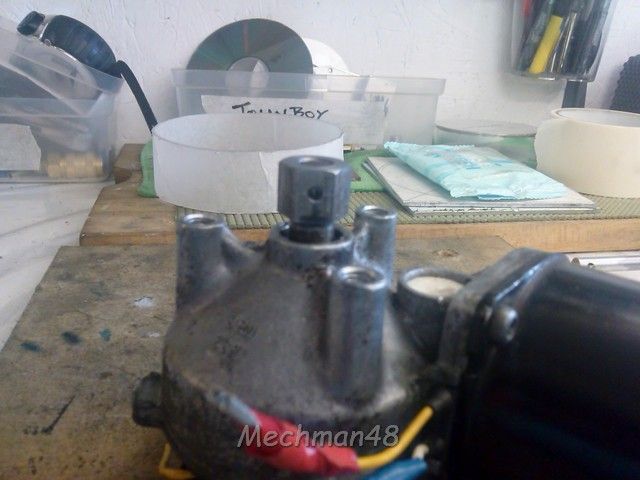

        #161291
        mechman48
          @mechman48
          Have found the pic for setting up the backlash…
          Have also included my fitting up of X drive using 12v wiper motor & aluminium plate & bar…
          Modified motor shaft…
          used spare socket set universal joint for coupling…
          Fabricated Ally' sheet cover…
          So far it works ok, am contemplating using 24v motor instead, have got vid of it operating in my you tube folder ..if I can figure out how to link to it…?
          Had posted these in an earlier post but have put it here under the common thread ..
          Cheers
          George
