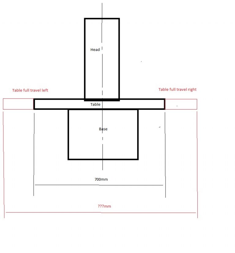

        Just clarify what the distance from the ctr line of the mill to the end of the table when adjusted all the way left and what's the distance when adjusted all the way right. Also watch the distance from the rear most edge of the mill to the front of the table when table adjusted out tmaths ksmaths ks

                Posted by mechman48 on 24/03/2013 12:00:24:
                See above description
                G
                Opps, sorry
                so the max needed working width is 560? Why do they say the width is 950, I am confued  mill.jpg
                Edited By petro1head on 24/03/2013 14:51:33

                John Stevenson 1
                  @johnstevenson1
                  You need the actual length of the bed [ including handles ] plus the travel.
                  That is the bare minimum you need but you do need clearance to get hold of the handles.
                  As George shwed in his picture across a corner is good but you don't have to be at a dead 45 degrees as mostly you only use a mill from one end, which end is personal preferance.
                  If you remove one handle and replace with a spacer, or just remove the sticky out bit and slew to say 40 degrees you can get better access to the handle you use and make the most of the space.

                        Posted by John Stevenson on 24/03/2013 14:53:52:
                        Yes, that the dimension I am after

                          Les Jones 1
                            @lesjones1
                            Hi petro1head,
                                         Machine width     Table travel           Space required.
                            WM14          800 mm +     220 mm =        1020 mm
                            WM16          930 mm +     485 mm =        1415 mm
                            These values are from Warcos website.
                            You could reduce the required space a little for the WM16 as John has allready suggested.
                            Les.
                            Edited By Les Jones 1 on 24/03/2013 17:01:54

                            #115185
                            John Stevenson 1
                              @johnstevenson1
                              Les, I get the WM14 table size to read 400 + 220 = 620
                              where did you get 800 from ?
                              Also WM16 reads as 700 + 485 = 1185 ?
                              Judging from the pics you need to add about 120 – 150mm for a handle and probably 50mm for a space on the other end.

                              Les Jones 1
                                @lesjones1
                                Hi John,
                                I have read the sequence of dimensions back to front. I transposed the width with the height. I am assuming the width dimension is the total width of the table including handles. (These values are from the Warco website when you download the PDF file if you click on "Spec sheet"
                                For the WM14 I get the width as 500 mm and the table travel as 220 mm (= 720 mm)
                                For the WM16 I get the width as 950 mm and the table travel as 485 mm (= 1435 mm)
                                Sorry for the error but we still have different values for the total width of the table so it looks like we need someone that has these machines to measure the total table length including handles.

                                  John Stevenson 1
                                    @johnstevenson1
                                    Les,
                                    Dimensions are packing case sizes. if you look on the spec sheet, above the drawing for the tee slots it gives you the size of the table as 400 x 120.
                                    Can't go on 500 as being total width as probaly shipswith the handles off to save space.

                                    Les Jones 1
                                      @lesjones1
                                      Hi John,
                                      Under the table of dimensions they say "Measurements taken to end of handle
                                      grips and with head at maximum elevation" So for the WM14 the width given is 100 mm longer than the table length which would be about right for the single handle. On the WM16 the width is given as 250 mm longer than the table length which would be about right for the two handles on the WM16.
                                      I think petro1head needs to wait for someone to take an actual measurment. There is also a difference in the table travel (WM16) of 485 mm quoted by Warco and the value of 520 mm given by George.
                                      Les.
