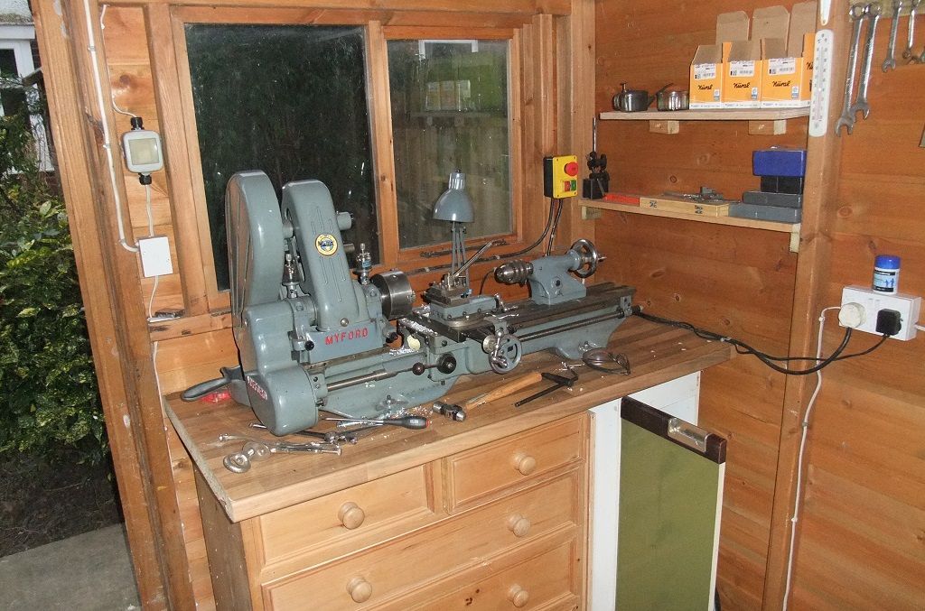

        Hi
        i have my lathe which I use quite a lot for all sorts of job, now I am after a milling machine.

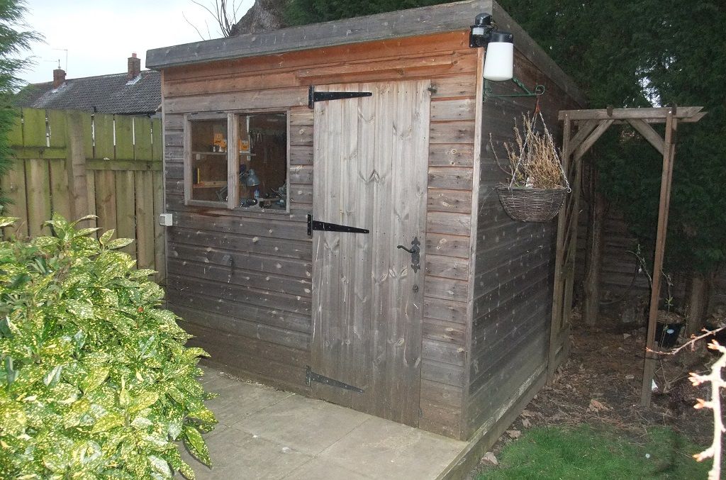

        My workshop is not huge 8' x 8' so don't have the room for a second hand Bridgeport so was thinking bout somit the size/price of the wm-14.  Would the wm-16 be a better choice, could prob stretch to that
        i have about £1000 to spend but within that budget will need tools etc.
        So what do you think, other options or suggestion

                                          Thanks for that George I would prefer to have the larger machine as I always with you got the next size up A few on here seem to own the bigger Mill, WM-16 or Champion 20V. I have taken some photos and drawn a rough sketch for you to have a look at. I suppose you need enough room to be able to stand at the machine and operate it, max height, max table travel left and right. Have a look and see what you think. Also could you tell me how much space your need as you already have the machine. MODS what does my return key not work in the reply box, I am using IE10, could it be that??
                                          Edit – Works fine with firefox so must be IE10, also the photo insert is flakey with IE10
                                          Edited By petro1head on 23/03/2013 18:23:32

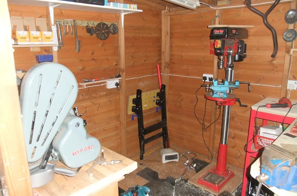

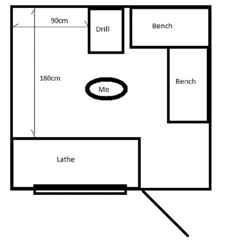

                                                Nooooooo, I have just spent the last 2 days rearranging the shed. The lathe was on the bench but on the wall that's now free and the vice was on the end of that,
                                                When I moved the lathe To the window i had to cut down the work top to fit. So I have just built that bench an strengthened it for the vice. It's staying put now
                                                The only place for a mill in the space left. By all means havea ply about tho

                                                      So can someone who has the warco wm-16 or equivalent let me know what space I will need based on table max position left and right and max height required, thanks
