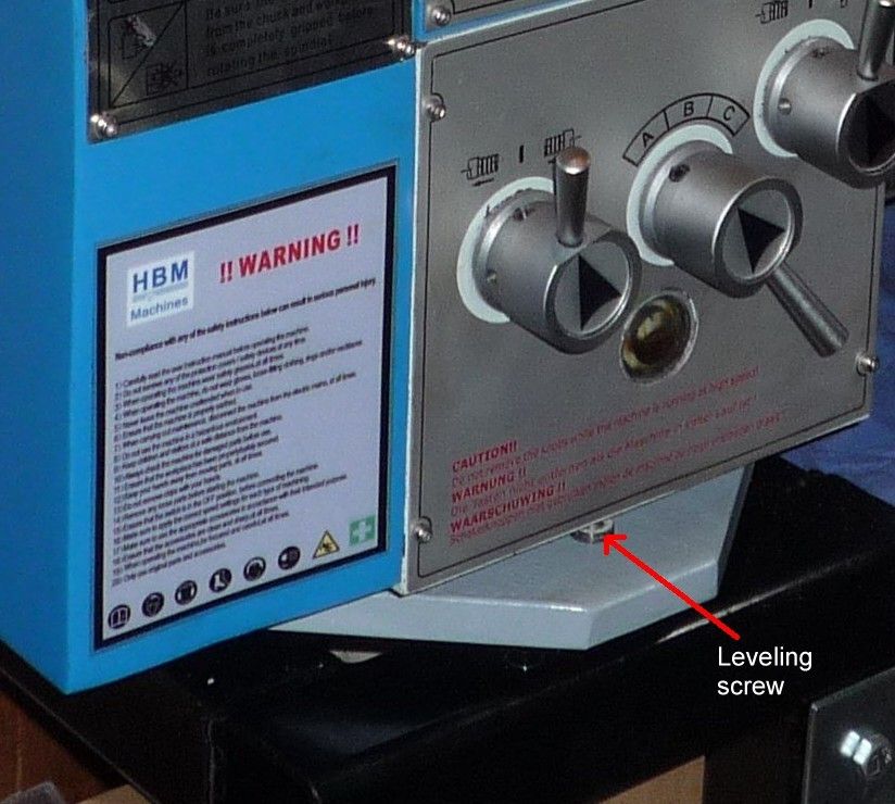

                          Mark – when I mounted my 290 lathe on a (homemade) stand I first mounted the lathe on a 15mm steel plate with some threaded holes. The holes at the front and rear end with MF 14 x 1. In these holes I have hollow heightadjusting bolts to level the lathe (see photo below).
                          When the lathe bed was free of any twist I tightened the M8 bolts going through a hole in the M14 height adjustment or levelling screws.
                          Thor

                            iv studied your pics, and it looks an excellent way to solve the problem, I'm sure the problem I have is theses stupid machine stands, there's just to much movement in them, and the stand does need to be screwed to the floor to aid stiffness, I phoned warco up and they insisted the stand should be bolted down, so bolted it will be! May pour some concrete to form a platform and sink the bolts into concrete while wet save on drilling, cause I'm going to lose some height if directly bolted to floor. Once that's done with stand secured and lathe bolted to stand, I'm still left with alittle shimming to correct any twist, I know the advice is shim under stand, but no chance of lifting all that, so shall be shimming under tail stock, was thinking of using alittle jack once bolts loosened to give enough gap to place shim! Someone going to tell me don't do that I know!
                            mark

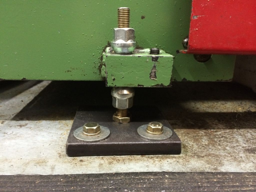

                                    This was my solution to securing the base cabinet of my lathe.
                                    Obviously I made 4 of these.
                                    100 x 100 x 12 steel plate was drilled in the center and tapped to 12mm. The length of 12mm threaded rod was locktighted into the base and additionally secured with a half height lock nut. This is then secured down to the floor through 2 extra holes in the plate.
                                    The height is then adjusted up or pulled down via 2 more nuts either side of the base mounting point. When level nip everything up both sides of the cabinet feet and recheck level. "Rinse and repeat" !!!

                                          If you do similar to that photo I posted on the last page you will not need to. smiley
                                          Nick

                                            i shall be trying that out, although my thread studs will be embedded in concrete base, if I can get stand to be rigid enough with adjustment nuts tightened , problem solved! If not it's will be bolted down directly
                                            mark
