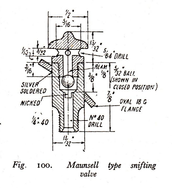

      The details for the snifting valve for my large boiler Tich is missing from the sheet plans and also not covered in "the book".
      I am quite new to all of this and have never seen a snifting valve Not even sure where it is best mounted .. when it has been made!
      Is anybody able to give me some help with what the internal details look like???
      Any help would be very much appreciated.
      Cheers Mike

              ME design for a 5" gauge version to illustrate features. The valve body is attached to the smokebox wall by the 3/8" thread using a suitable nut.The 5/16" thread is piped to the wet header. The valve allows air to be drawn into the header when the regulator is shut whilst the loco coasts. Steam shuts the valve when the regulator is opened.
              Its positioning can be anywhere convenient.

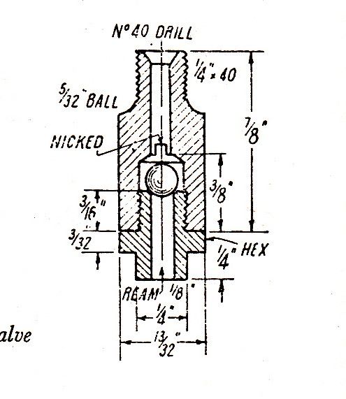

                Mike, These snifting valves are From LBSC The Live Steam Book.

                  This is great info guys !!!!
                  Many thanks to all 4 of you ))
