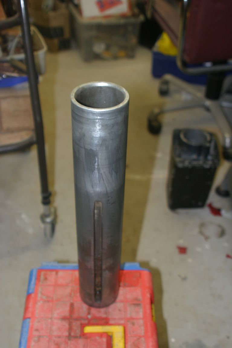

                                I have a piece of steel tube which is there or thereabouts for your requirements. How specific are the dimensions? I've only just done a quick dash to the shed and put a plastic vernier on it but if you are interested, I can do a more accurate check tomorrow. The tube is a 'pull' from a Shopmate radial arm saw and (to my eyes) is a rather nice piece of material. PM me if you need more info.
                                rgds
                                Bill
                                #261992
                                Cornish Jack
                                  @cornishjack
                                  Roger
                                  As mentioned above, I have now more accurately measured the tube referred to and photos below.img_9110.jpg
                                  Photos to show the modifications to the tube – keyway and attachment holes.
                                  The measurements are Imperial 'cos I can't find my metric vernier!blush
                                  Tube diameter – 3.01"
                                  Wall Thickness – 0.305"
                                  Overall length – 17"
                                  Distance top to start of keyway – 6"
                                  Keyway length – 9"
                                  Keyway depth – 0.3"
                                  The keyway does pose a problem but someone with John Stevenson's ability to convert 'Sow's Ears into Silk Purses' could undoubtedly make the full length useable.
                                  If this is of any use please let me know.
                                  rgds
                                  Bill
