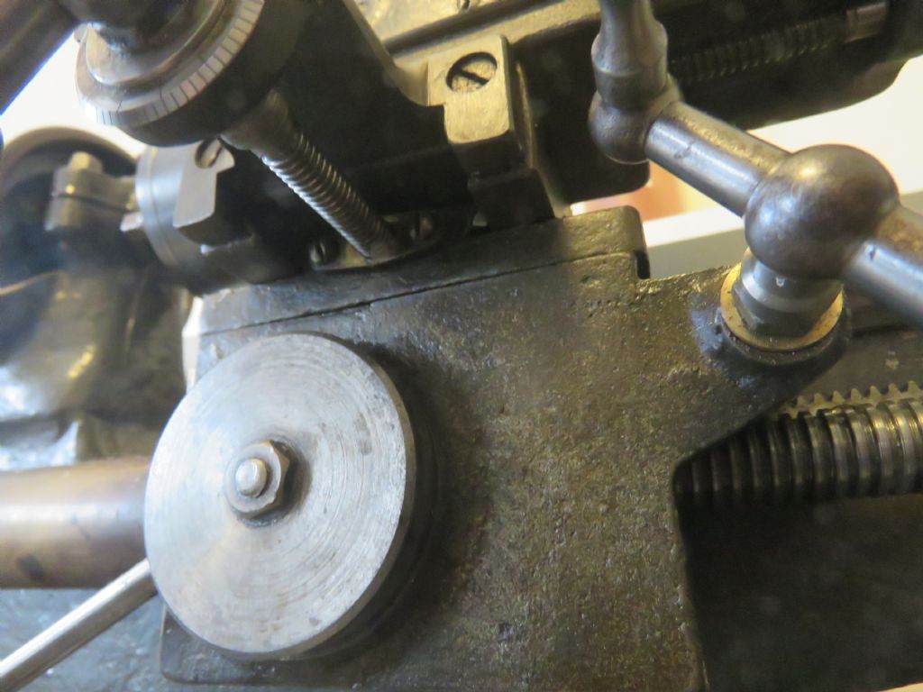

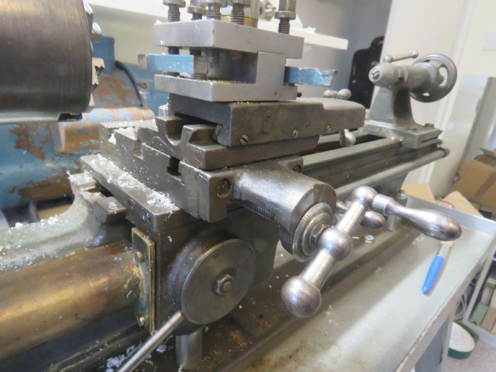

        Arthur, glad you are making progress. Back to identifying your lathe I notice the cross slide front extension is not per the normal RandA style having more in common with the later Myford design so interesting. Possibly an owner modification but the casting looks professional. More photos pleas. The dial is probably a modification as many lathes had none or small ones like on your topslide so better ones were made available. The scallop on the casting for the fiducial line looks to go lower to align with a small orignal one.
        Instead of trying to make a 62.5 dial consider twice that on a much bigger dial – the largest you can fit. No need to engrave it just use one of the many online dial programs to print one and glue it to a plain disc. Perfectly adequate for the occasional use you say you are making of the lathe.

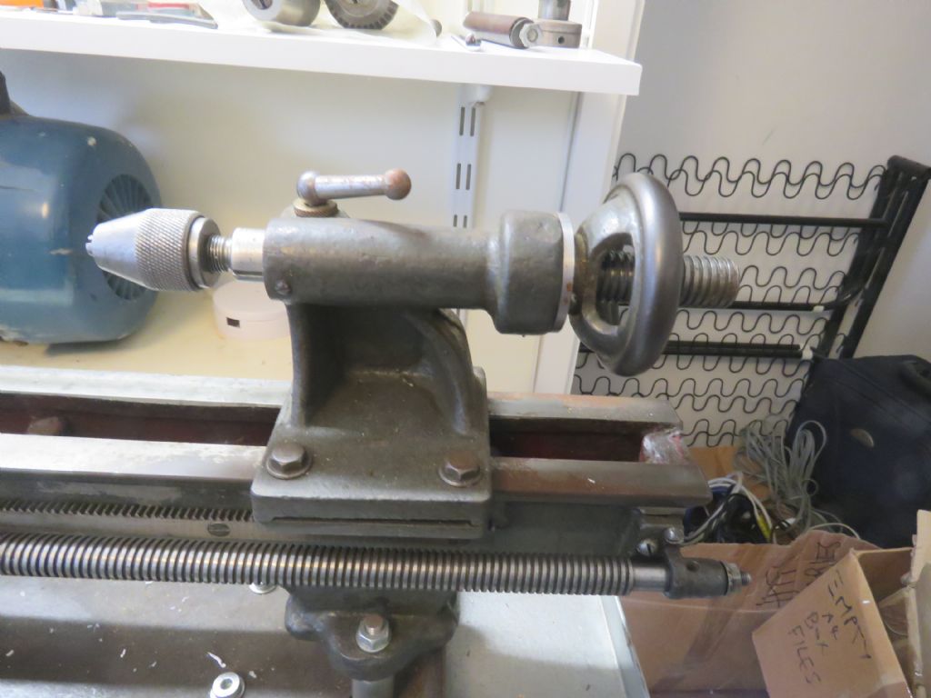

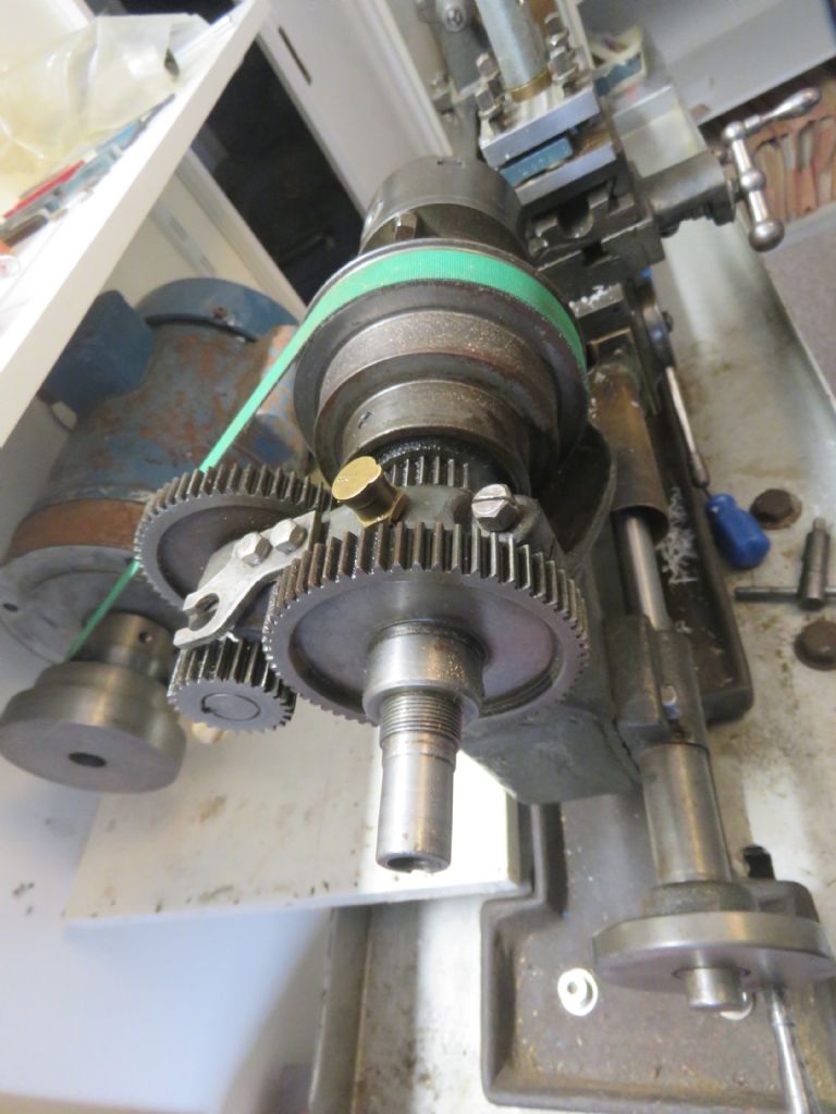

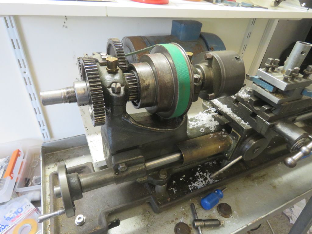

            I enclose some more photos as requested.
            This is an underneath view of the Y lead screw.
            And just for completeness – the tailstock:

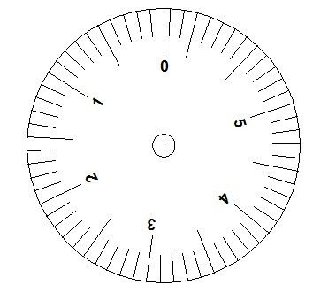

            Concerning the dial, I am a member of Nottingham Hackspace which has an 80W laser. It won’t cut aluminium, but it will engrave anodised aluminium, which removes the anodising. I have never tried it, but Autocad will do a polar array with any angle or number of divisions.
            I enclose a sketch which I have just produced on Autocad, so is this the sort of thing I would need?
            We move into tier 4 tonight, so Hackspace will be shut down, but I will try it next time I can get into the space and see if I can etch a dial, which I will then just need to cut to size.

              I was envisaging a dial with the graduations on the circumference.
              But if there is no space for such a dial, your face dial (basically a thin disc ) would be OK, with a pointer (Fiducial mark if you want to be pedantic ) at the outer edge. Similar to my memory of the Myford ML1, ML2, ,ML3 and ML4 set up, I think.
              Within reason, the larger the diameter, the better, since any "interpolation" / guessing, between lines would be easier and or accurate, because the line spacing will be greater.
              Howard.
