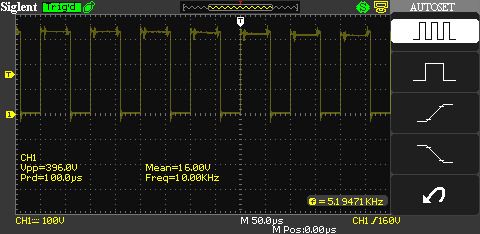

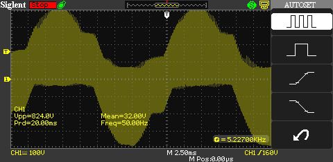

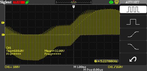

        Posted by Michael Gilligan on 19/06/2017 07:40:44:
        Posted by Tony Pratt 1 on 19/06/2017 07:22:19:
        Hi Guys,
        I can hear a massive amount of buzzing on the radio.
        Tony
        VFD basically synthesise their "sinewave" so it looks something like this: **LINK**
        That's right, but the waveforms aren't so neat in the real world. Just for interest, here's some screenshots of the waveform output by my VFD on dead slow.
        As you can see the waveform is a very rough approximation of a 50 Hz sine-wave.
        Zooming in on the detail reveals how it's been built up
        The 50Hz 'sine wave' seen by the motor is synthesised from a 10kHz square wave. Square waves are wonderfully efficient because the semiconductor switches inside the VFD are either fully on or fully off, which means they don't get hot. But those very fast on-off transitions create radio frequency energy. While DC and AC tend to stay with the cable RF has no such limitation. Rapidly alternating currents produce mutually supporting electric and magnetic fields that expand to infinity. Although most of the power produced by a VFD behaves like 50Hz AC, a proportion of it is RF that will radiate if it can. A good way to stop it is with earthed metal shields and perhaps a filter..
        Sharp spikes produced by VFDs might cause grief inside older motors (pre 1980, allegedly). Although most old 3 phase induction motors 'just work', there are reports on the web of insulation failures and unwanted currents flowing in the bearings.
        RF currents produce counter-intuitive effects. If, for example, you connect a 50Hz power source to the base of a large air-cored inductor, nothing much happens. A 100kHz power source connected to the same coil will produce spectacular effects like a Tesla Coil. A Tesla coil can be made by accident. If your motor/VFD combination starts producing big sparks, suspect a loose connection. It's important to fix it quickly; although RF created voltages are unlikely to cause much damage in themselves, they can start an arc that ordinary AC will sustain with thoroughly bad results.
        Edit: checked it twice and still didn't see the typos before hitting save.
        Edited By SillyOldDuffer on 19/06/2017 13:50:23

          Posted by SillyOldDuffer on 19/06/2017 13:46:40:
          By definition an RF signal is AC. They're one and the same thing, not different things. Any AC signal will radiate an electromagnetic wave, unless of course Maxwell got it wrong.
          I'm afraid you're getting confused about Tesla coils. They are a resonant transformer, not a coil as such, and it is the Q of the resonant circuits, and the step up ratio, that allows very high voltages to be generated.
          By the way the waveform you 'see' from the output of the VFD will depend upon whether you measure phase to phase or phase to 'neutral'.
          Andrew

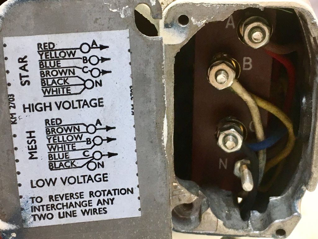

                some picture of the Star wiring that i need to make Mesh/Delta so i can then connect the Inverter which i believe connects from U,V,W to any of ABC on the motor.
                Any helps would be great
                Thanks

                  Need a better picture…..
                  If that is a Star wired motor, you need the star point accessing to change to Delta….
                  What motor is it?
                  There are threads on here giving advice in how to change from Star to Delta…

                    Hi John
                    i have seen a few posts on it but no simple explanations i.e remove all wires and connect Colour/Wire to A,B,C,N etc
                    The white cable in the picture is going to the electrical control unit on the lathe itself so i presume that will be disconnected altogether and the remaining wires i are to the motor which then need connecting Brown to A, White to B and Black to C with nothing on N to make it Mesh/Delta
                    Thanks

                            Lee,
                            I am totally confused……
                            The white cable is connected to your motor's terminals marked A,B and C, yes or no?
                            Is the machine currently running from a 3 phase supply or not?
                            You want to run from a single phase supply using an inverter?
                            Connected to the motor's terminals A,B,C and N, there are coloured wires as per the photo depicting Star…..?
                            #303443
                            Lee Goulding
                              @leegoulding74917
                              Hi
                              Yes the cable is connected to ABC
                              The machine was running from a phase before it came to me
                              Yes it will be run from an inverter with Pendent for control
                              Yes it looks as though it's in Star
                              Thanks
                              #303447
                              John Rudd
                                @johnrudd16576
                                In that case, connect the coloured motor wires as per the diagram, for Mesh, then use the White cable ( if its long enough..) connecting to terminals U,V and W on the inverter, the free end to terminals A,B and C on your motor.
                                There should be no wires connected to the N terminal.

                                Lee Goulding
                                  @leegoulding74917
                                  Hi John
                                  Ok thanks for that will do but I'm going to replace the white cable with some SY shielded cable as it's not long enough
                                  Thanks

                                    Posted by SillyOldDuffer on 19/06/2017 15:19:20:
                                    Good point about looking at the waveforms phase to phase, which is what the motor actually gets as input. I'd have put my oscilloscope across two of the phases except I couldn't think of a quick way of doing it without accidentally shorting one of them to earth.
                                    You need one of these:
                                    ….a differential probe. Essentially the potential divider is split on either side of the measurement resistor. So the ground of the 'scope' may be connected to ground on the EUT but through many megaohms, so not a problem.
                                    I bought mine to look at gate drive and output signals on high current (2500A) half bridges running from rectified three phase.
                                    Andrew

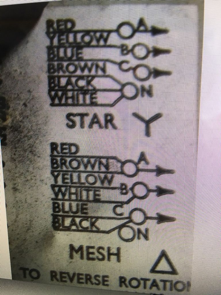

                                          Lee Goulding
                                            @leegoulding74917
                                            Ok so here's my attempt at wiring into the Mesh configuration any advice if this is correct.
                                            A – Red/Brown
                                            B – Yellow/White
                                            C – Blue/Black
                                            N – No Wires Connected
                                            Edited By Lee Goulding on 20/06/2017 22:31:07
                                            #303558
                                            Les Jones 1
                                              @lesjones1
                                              Hi Lee,
                                              You now have it wired correctly for 240 volt delta (Mesh) operation.
                                              Les
