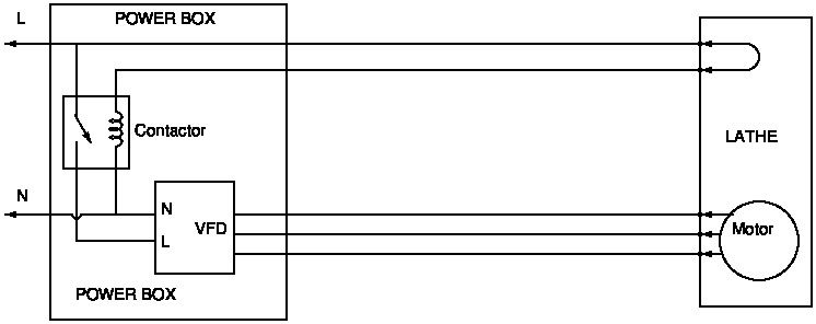

          An interesting challenge, designing interlocks for safety!
          My suggestion: an extra pair be added that loops back to enable a contactor. Suggested circuit:
          Earth omitted for clarity. This would stop the VFD powering up unless the lathe was connected. Is it good enough? Designing safety interlocks isn't my thing!
          Fixed circuit labelling error!
          Edited By SillyOldDuffer on 12/02/2020 20:24:05
          #451918
          old mart
            @oldmart
            Excellent from a safety point of view, but as in a lot of ideas which are good in theory, it has a possible drawback. The power in wires need to be very well shielded from the vfd to motor ones. That would make a single plug and socket problematical. Having the two circuits ganged together rigidly, but held apart to keep the interference low could be done. If the plug and sockets were at the power box end, the mains loop would not have to extend to the lathe

                #451921
                Robert Atkinson 2
                  @robertatkinson2
                  Dave (SOD),
                  The idea of passing the interlock through the connector is a valid one. It will however only be fully satisfactory if the interlock pins disconnect before the power pins. It would be even better if the interlock was low voltage.
