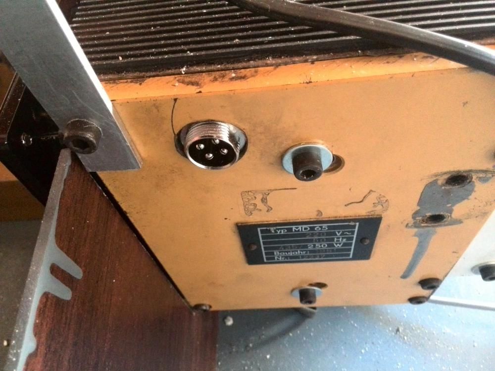

      I'd like to install a 3-phase motor (0.37 or 0.25 kW would fit) into my Hobbymat MD65, and control it with a VFD. I've been reading on the topic of VFDs, and looks like the most proper way to install one is to hardwire it to the mains, as well as to the motor.
      But in my case, that is not very practical. My little lathe normally sleeps on a shelf, when I want to use it, I take it out and bring it to the workbench. Ideally, I would like a portable VFD unit that would normally stay on another shelf (the lathe takes a whole shelf), and can be brought out and connected to the lathe, when needed. It would be also possible to have the VFD permanently mounted on the wall, but still it would need some way to quickly connect it's output to the lathe when I bring it to the workbench.
      I'm contemplating a metal enclosure (perhaps an old PC case?), with an IEC socket for connecting the mains power. Inside would be an EMC filter, the VFD, and possibly a braking resistor (maybe overkill for such a little lathe). Both the lathe and the VFD enclosure should have some sort of 4-pin sockets that could be connected together with a suitable pigtail. Another option would be to pass a cable from the VFD out from the enclosure (through a gland), with a 4-pin plug on it's end, to connect to the lathe.
      For forward/stop/reverse/E-stop/speed control on the lathe, I'm thinking about adding RJ-45 connectors on both the VFD enclosure and the lathe, connected via a shielded patch cord.
      I have a couple of concerns:
      Safety. Most VFD manuals mention that the motor should never be disconnected from the drive during operation (this could destroy the VFD). With 1 or 2 plugs/sockets which could be disconnected, this could be an issue. So the connectors must be lockable, to prevent accidental disconnecting. It might also be a problem if, when setting things up, the VFD is plugged in first and turned on while forgetting to connect the motor. This can be fixed either by proper discipline, or adding an extra pin to the motor connector, which would be a part of safety interlock circuit (until it's connected, the VFD can't be turned on).
      EMC/RFI: Reading the VFD manuals and information available on the net (mostly geared towards professional industry), it appears that there are many requirements in wiring up a VFD to avoid excessive interference (I'm in residential environment – my "workshop" is in a cellar inside an apartment building). The connection between the VFD and the motor seems to be an important aspect of that wiring, using a shielded cable, correctly grounding that shield on both VFD and motor sides. I couldn't find any info on properly wiring an arrangement like I'm imagining. I wonder how the plugs/sockets on the motor power wire will affect EMC.
      I would like to hear opinions, whether or not this plan makes sense or should be forgotten. If it makes a bit of sense, I hope someone can offer suggestions on implementing this project, for example which connectors would be good to use for the power wire, how to deal with the wire's shield, and any other advice
      Thanks!

        Steviegtr
          @steviegtr
          1st of all that 4 pin plug is the sort of thing you fit to a microphone. Not suitable for 3 phase work. Ideally you would fit a 3 pin & E plug & skt like a reyrolle. Look under electrical supplies or ebay. Yoy can get one with threads on to lock it. They sell every kind of fitting you will need. Like a chassis mounted one. for the lathe end.
          One thing to note. I used to fit these in industry a lot of them including building panels to enclose them. The screen you talk about should only be connected at one end. So say at the VFD end you would connect your earth & screen together. At the motor end you would only connect your earth. The screen needs cutting back & either taping over or fit heat shrink. So basically the screen is earthed down to the mains , but remains open at the motor. That will stop RFI. I have done mine that way & have a DAB radio directly over the lathe & do not have any interference at any frequeny. I run mine in jog mode at 1.5 HZ so the chuck just creeps round which is great for marking out & any detail work you need to do. Also to see if the work is going to clear everything before speeding up. I make a bit of jewelry so it's ideal for me. Down at those low frequencies the drive has very little torque & you can stop the chuck by hand. I have a dedicated panel I built & will show the pics under here.
          The other thing I did & also glad I did was to fit a 10 turn speed potentiometer. I got a bit of a slating over it by some members. It was something we always did when building panels. The thing is it is only a lathe & I can understand why some say you do not need accurate speed control. That is true. But if you fit a single turn pot,, you actually only have 3/4 of a turn from off to max. That's the nature of a single turn pot. As an exercise the other day I tried to select various frequencies going up at 5hz a time & also trying to select a certain speed. I know again it is not essential. But if you said take the machine to 275rpm I can do this pretty quickly Also be careful of overdrive. The VFD I have can be set from 0 to 400 hz. I should imagine at 400 hz the rotor would explode. But I know I can safely go to 100hz.
          Because these motors we mostly fit are the 4 pole high torque version. If you fit a 2 pole version the motor standard would be 2800 rpm. But as we know a standard 4 pole motor on 50hz is 1400rpm. Some will argue but it can be slightly higher but never over 1470 ish.
          So as you can see if you ran your motor at 100 hz the speed will be around 2800 rpm. Which the motor & housing can cope with. But another thing to be wary of is that.
          Some lathe's & mine is such that it only has a plain phosphor bronze front bearing lubricated by an oil wick. Running at high rpm may not be a good idea. So far with all the materials I have cut I have not gone over around 900rpm. EDIT. Thinking about it you would really need a 4 pin & earth plug & skt because once the wiring leaves the VFD the earth & screen need to be separate. Some other safety features you can program into the inverter is things like e-stop. So set you machine to wind up to speed over a few seconds on start & on stop wind down in a few seconds. But when you hit e-stop it will stop imeddiately. Sorry for bad spelling. Hope all this helps. Any further info don't hesitate. You may get some varying answers to your thread. Another thing with an inverter is you can see the current being drawn at any set speed.

          Robert Atkinson 2
            @robertatkinson2
            100% second what @Steviegtr says. That metallic microphone connector is potentially lethal and is illegal to use on mains.. If you want something more compact than the "commando" type 3 Pin and earth connector suggested by steve, have a look at HAN connectors. Again you heed 3pin PLUS earth. This is subtly different from a 4 pin connector in that the earth contact is designed to make first and break last. This means if there is a fault and you are touching the motor as you unplug it to fault find the case cannot become live. The FEMALE goes on the FVD output , Male on the motor
            An example is **LINK**
            Other sources available
            Robert G8RPI.
            Edited By Robert Atkinson 2 on 12/02/2020 07:52:44

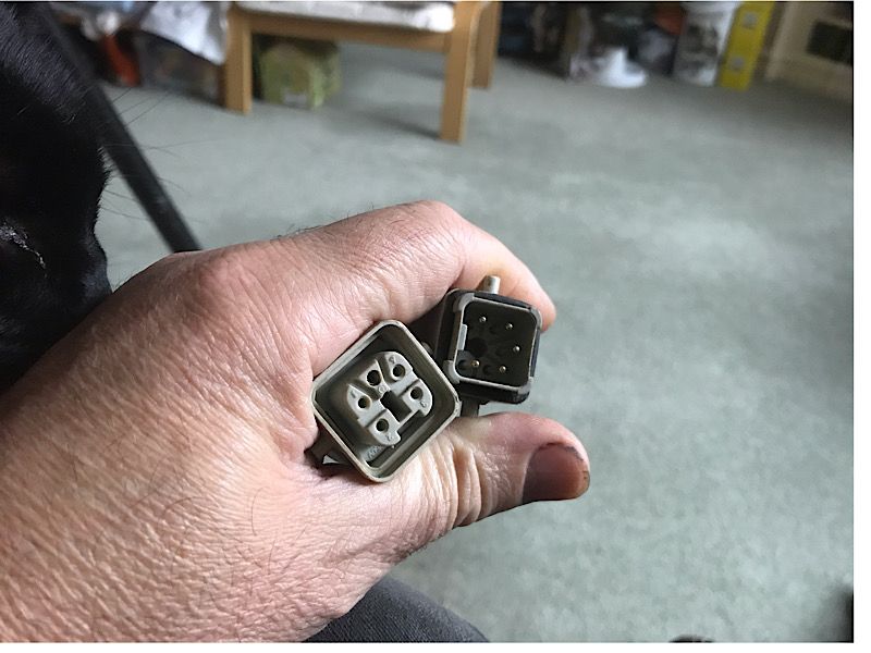

              Whilst I quite agree that the plug and socket pictured gives me the willys they are fitted as standard to high frequency spindles used in woodworking routers and Cnc machines carrying 240v 3 phase up to 400 hz
              #451813

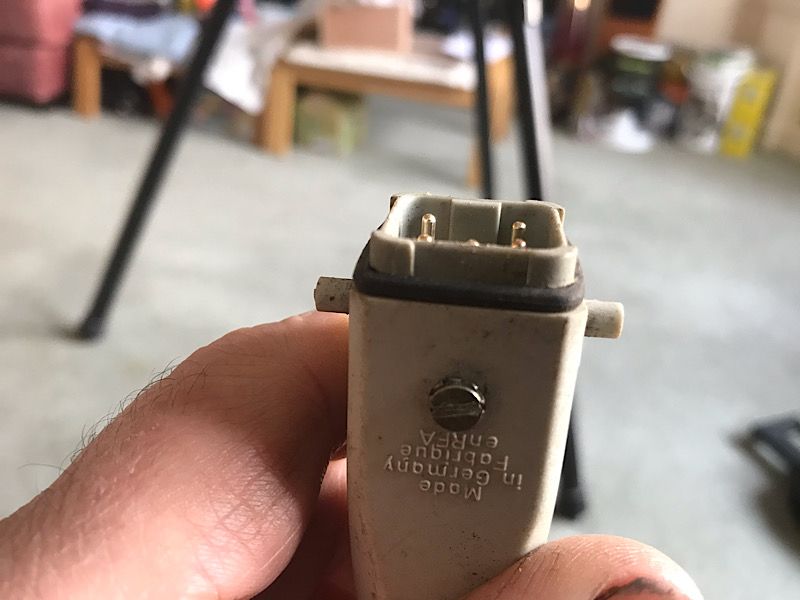

              Ian Parkin
                @ianparkin39383
                What about these then Robert?
                widely used on German printing machinery for 415v3p
                ef642be2-91ee-4350-9440-85211821bdf2.jpegAre these illegal?
                  Those and other variations of Harting connectors also widely used on machine tools for 3 phase connections – check the connector voltage rating to be sure (IIRC Harting are 600V).
                  Bear in mind that the cable screen also needs to be continuous through any connector, so 5 pins required (3 x phases, earth & screen) not 4.
                  It is always best to read the installation manual for the equipment you intend to use, as it is not unusual for VFD power cables to specify that the screen is connected at both the motor and drive ends.
                  I would avoid connectors if at all possible – you are adding a large number of additional connections, all of which are potential failure points. It is also possible that the VFD installation instructions will specify no cable breaks.

                          Posted by Ian Parkin on 12/02/2020 09:03:25:
                          Yes, they are safe and legal as long as they are the +E (earth type. That is the HAN connector I referred to in my previous post.
                          Robert G8RPI

                            #451831
                            Ian Parkin
                              @ianparkin39383
                              Well those are harting brand and as you can see the earth doesn’t disconnect later than any other of the pins

                                  #451836
                                  Robert Atkinson 2
                                    @robertatkinson2
                                    Posted by Ian Parkin on 12/02/2020 12:43:20:
                                    Yes that one pictured does.
                                    The 5th pin at the top is longer than the others.
                                    Not ALL HAN connectors do, They have to be nPin + PE or similar description to be safe for external mains power connectors.
                                    Robert G8RPI

                                          Ian Parkin
                                            @ianparkin39383
                                            This one and all the others on the machine that these came off are all the same
                                            #451847
