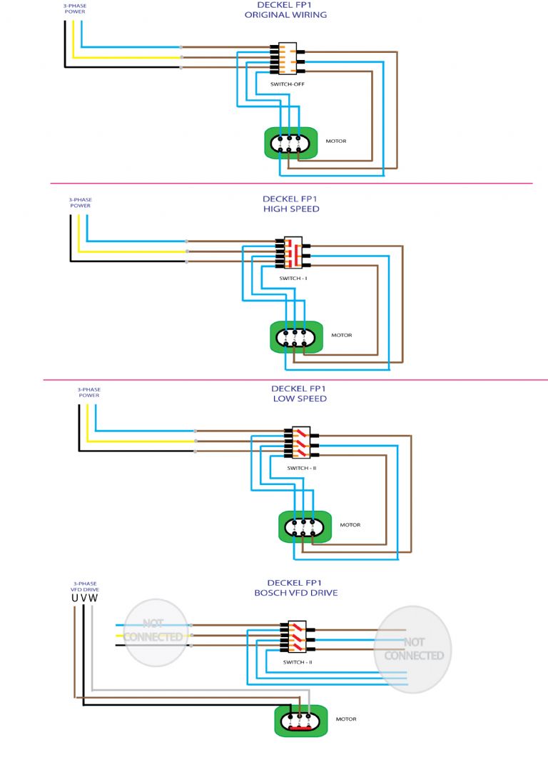

          My motor, which is the original motor fitted, is marked Siemans-Shuckert , 380V, 2.7/2.8 A, 0.8/1.1kW, cos ó 0.64/0.8, 700/1420 U/min
          There is a switch to switch it from low speed to high speed. This switches it from Star to delta ( or Delta to Star – I will have to check)
          It is running satisfactorily on VFD with 230V and 29Hz.
          I notice that the motor draws almost the same current in low or high speed ( 2.7 or 2.8 A ) and the power rated is 0.8 or 1.1 kW.
          Thanks again for all the help.
          For now I might just leave it alone as I do not need the very high speeds it is capable of
              It may be switching from star to delta, but is also pole switching from 4 to 8. The key is the last part of the plate:
              700/1420 U/min
              In other words 700 and 1420 rpm in low and high speed respectively.
              Andrew

                Hello Gerard from the information you recently posted it would suggest your motor is a two speed one, with POLE changing switching to give the two speeds,and NOT Star/ Delta. John

                        The Dahlander diagram may be correct. The description I have, translated from the German, is "pole-reversible motor 700/1400 revolutions" – even though the plate clearly shows 700/1420 U/min
                        i am only using it in the low speed (Delta) configuration .And as I have the base frequency set to 30Hz , I am not even getting the maximum of the low speeds.
                        What would happen if i switched to the high speed(double star ) connection? Would i achieve higher speed or would I damage the motor?
                        Sorry , I just realised that I can not connect the neutral so unlikely to be possible.
                        I have a cheap digital tachometer, like this one, which I could fit to the mill and measure the speed accurately.

                          When the VFD was fitted, I traced the wiring on the switch deckelwiring2.jpg and the wiring in the motor motor wiring.jpg

                            Gerald: It should run fine in star. If you look at your diagram in high speed mode wires 4, 5 and 6 are connected together, but they don't go anywhere. You don't need a neutral line to run a motor in star. In theory the current in a neutral wire would be zero.

                              Thanks Andrew. really good to know. I will set up the tachometer and try to see what speeds the motor produces.
                              Gerard

                                          I eventually fitted the digital tachometer and measured the speeds on the mill in comparison to the speeds given on the gearbox plate for low and high speed . The VFD was set with voltage set at 230V and base frequency at 31.5Hz
                                        Low Speed High Speed measured Speed
                                        95                    190                       128
                                        150                  300                       205
                                        235                  475                       322
                                        375                  750                       389
                                        600                1200                       637
                                        950                1900                     1040
                                        It would seem that the motor is wired for high speed and is achieving over 50% of the expected speed.
