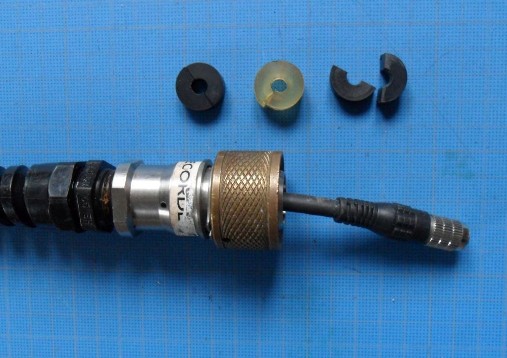

      I need to 'near hermetically) seal a cable where it passes through a panel without removing its moulded-on connectors.
      Ideally a 'Polo' mint soft rubber washer is stretched over the connector which is then passed through a shouldered bore, on either side of the rubber ring are pairs of 'D' shaped blocks (thick washers cut across the diameter). End pressure is then applied so that the rubber sandwiched is compressed so that it seals on the bore and on the cable OD.
      I know my soft/stretchy' description is like a piece of string but normal 70 Shore O rings are far to hard and probably would not stretch to suit a cable of 5mm and a connector of 20mm dia. On examples I have seen the rubber is more like Jelly Babies, if anyone remembers those!
      Googling for soft rubber rings is likely to lead one astray! so I'm hoping someone here might know of a suitable source.

                              Ian P
                                @ianp
                                Some good suggestions, thanks all.
                                Picture is of an existing 'Pass-Thru' that is used on underwater camera housings, some used at depths over 100m and the housing and contents might be valued in tens of thousands of pounds so failure and leaks have to be avoided.
                                The rubber ring shown is one that split when stretching. As supplied it has a bore of about 6mm and an OD of 20mm. Because this particular camera is made in different lengths the sealed joint needs to be re-makeable to suit the cable on a particular setup.
                                The one shown is a standard commercial item so this size is not a problem, what I am trying to do is custom make some to suit very small (1.5mm) diameter cables that have 12-15m diameter connectors moulded on both ends of the cable.
                                I suppose that more important than the hardness of the rubber, is its stretch-ability, I have never used Sugru or similar products but it seems unlikely to me that its unlikely to have the properties of common or garden elastic bands, which is a bit what the ring shown feels like.

                                                      I required a similar solution to seal the tether command cable for a small underwater UAV – I found two options – SKIFFY, a company that supplies plastic and rubber fittings, screws, grommets, etc. They had a pale white grommet that was very soft – It was not a doughnut, but a panel grommet, ie, with a slit on the outer periphery to fit the sheet metal panel. The one I used was 8mm ID and 16mm OD and stretched over a 24mm plug with some lubricant applied. Some did snap in the process.
                                                      The second, and finally better option, was Silicon tubing from the local hospital – used in the peristaltic pumps, OD of 14mm, ID of around 6.5. I fed the tube into a metal tube of snug length, let an 8mm section protrude and cut it of with a Stanley type knife blade. That little ring stretched over 28mm internal without snapping. Make sure to get the silicon stuff – they also have what looked and felt like polyethylene which is unsuitable.
