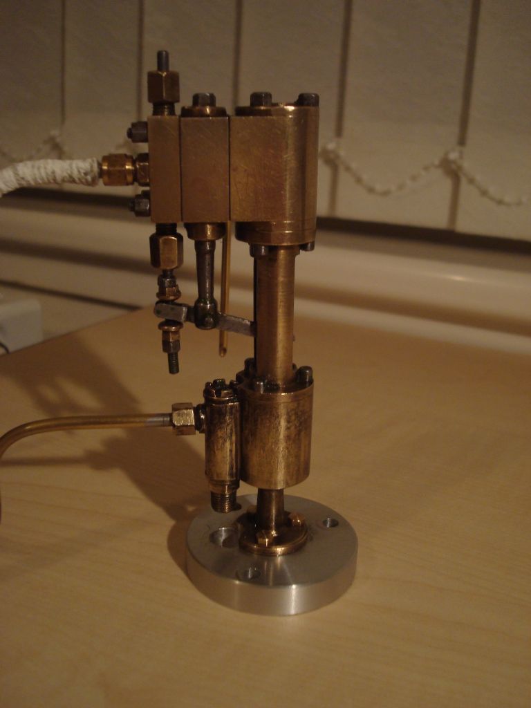

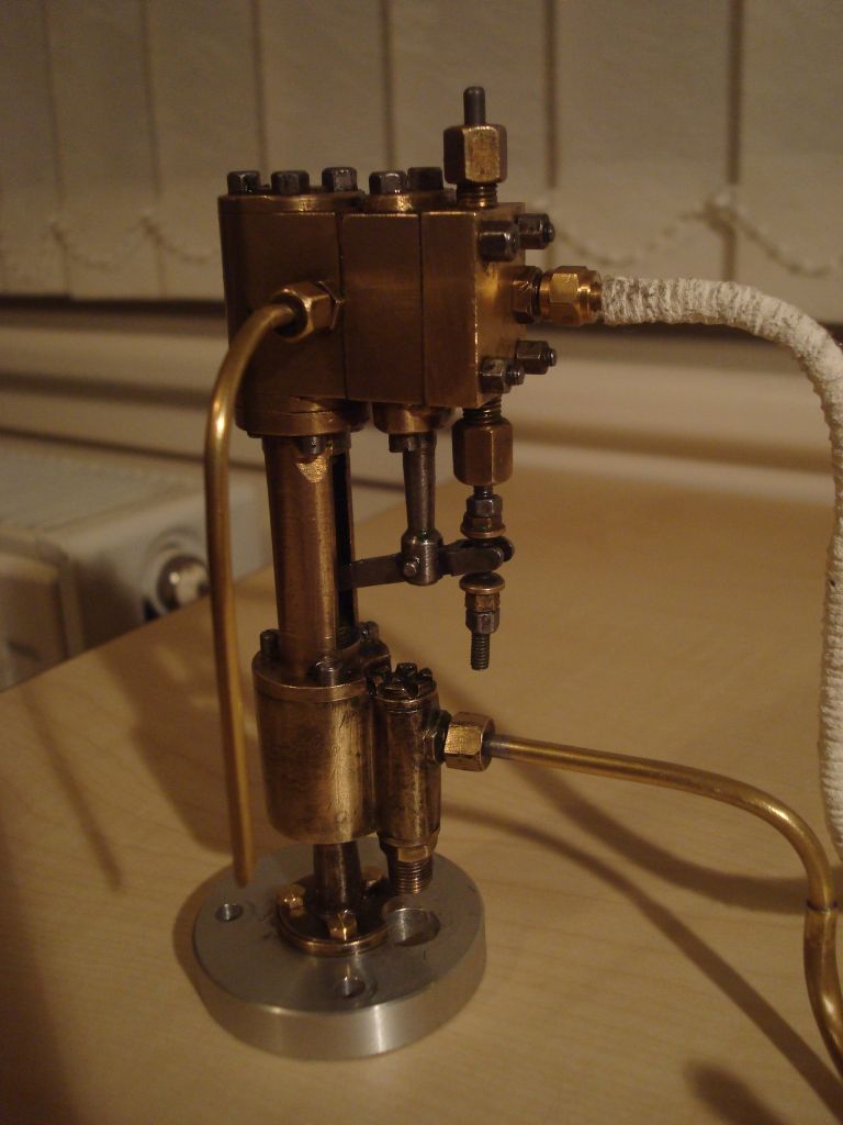

      I was given this 4″ high vertical pump and after a little cleaning and lubrication it appeared to run well on compressed air and after fitting to a horizontal marine boiler, it did the business – on air.>>
      On raising steam, the pump failed to run and just rested in one position. No proding or forced action could encourage it to run. Adjustments of the steam valve stroke also failed to get any movement.>>
      Back on air it runs well !>>

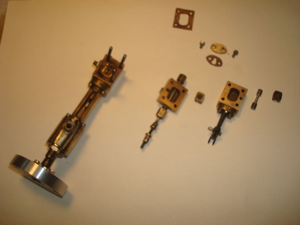

      Disassembling the valve chests at the top end, I could not understand the complicated double steam valves and fail to comprehend how it should work.>>
      Is there anyone out there who can tell me the name of the pump, perhaps has a set of drawing that will help me or has previous experience of the little beast ?

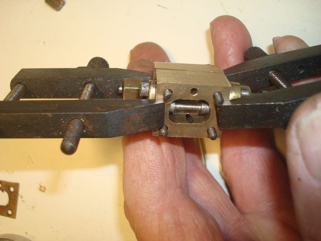

            The steam passages in the valve chest appear quite complex and difficult to follow. There are two slide valves, one on top of the other. The first and nearest the steam inlet is operated by the valve rod seen in the photographs. The other side of this port face and between it and the cylinder is another slide valve which can only be operated by movement of the first. The port face of this second valve is on the side of the cylinder. If only I could ascertain how it is designed to operate, I might then be able to understand the prblem.

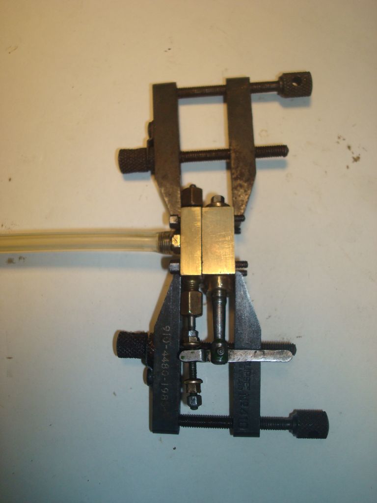

                  As a means of progressing my investigation, I intend detaching both valve chests from the pump, bolting them together, applying (A) air and (B) steam to check the operation of the slide vavles by moving the valve rod by hand. Does this sound feasible ?

                        The description of this sort of pump which made sense to me was that the second slide valve (that which controls the inlet of steam to the main piston) is a shuttle operated by the steam admitted by the first slide valve which is controlled by the valve rod you can see.
                        Does that shed any light on how it is supposed to work or just muddy things further?

                              Having removed steam valve chest and shuttle chest from the cylinder, I re assembled them temorarily of the cylinder and applied air to the steam inlet.
                              By operating the valve rod by hand, I was able to observe the shuttle move up and down correctly.

                                Just started on here, looking at this pump and the top half and trunk is pure LBSC Westinghouse pump, whereas the LBSC pump was an air pump this one seems to have been converted to a boiler feed pump. I have made two of these pumps at the same time one works perfectly on air and steam, the other fine on air and tetchy on steam, the problem with it was the different expansion of the metals for the shuttle valve and its housing. Another issue was the gasket I had made needed cutting away to fully clear the ports for the shuttle. Plans for the pump are obtainable from My Hobby Store ( no association)
