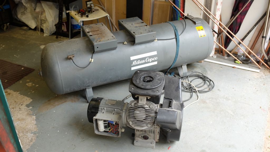

                          Posted by Carl Wilson 4 on 28/01/2017 17:50:50:
                          Thanks for the replies. Of course I'd thought of putting thecompressor in a shed. I can't for various reasons.
                          That's why I thought of picking up a second hand vane compressor unit (not a full compressor as some seem to have thought) and adapting my current machine.
                          Noise wise I think they are something like 65db from what I've read.
                          Atlas Copco sell a silencing hood for the L series V twins that brings the noise down to a similar level. They sometimes come up on Ebay.
                          This is the one I'm on about…..quite often see them for sale without the tank.dscf9317.jpg
