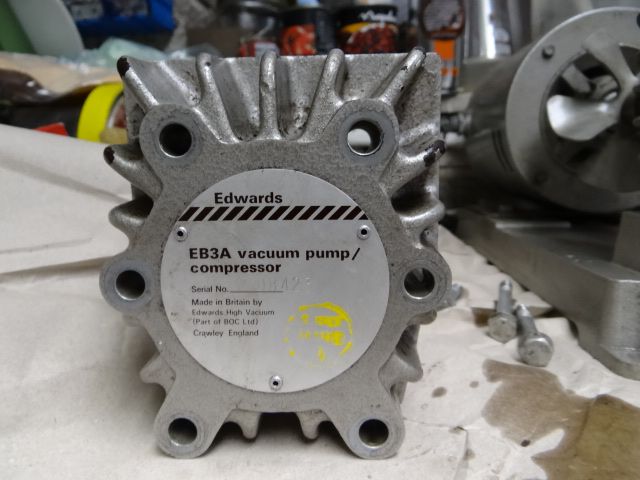

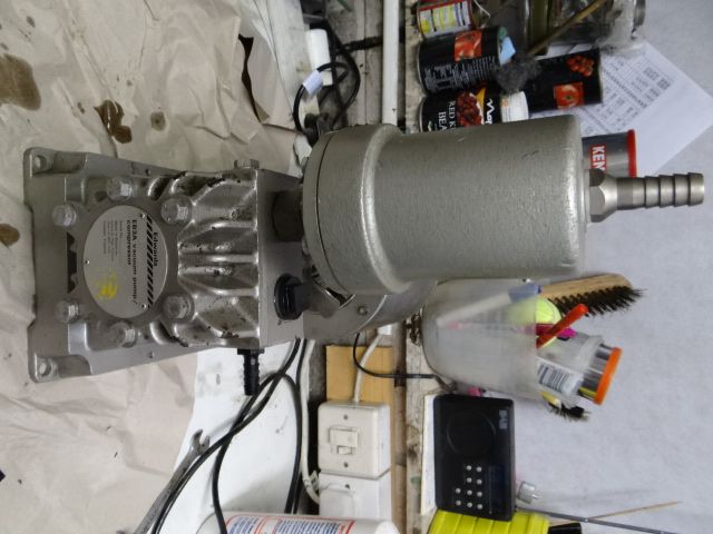

      Another fine mess I've got myself into. I'm building a clock (which doesn't work yet) intending to run the pendulum in a vacuum. Years ago I bought an Edwards 3B vacuum/compressor from a nice man at a car boot sale who assured me it was a high-vacuum pump. Was he a naughty fibber?
      Got it home, fired it up for a quick test, seemed to work but not good today. The motor runs but the compression and vacuum fail to impress. No manual or info on the web.
      Suspected it needed oil and have the right sort. Sprayed myself & workshop, I think by filling the pump through the wrong hole at the top. Fortunately the big output filter was off and the oil came out without fuss. On second thoughts this type of pump may be medical, and not meant to be oily.

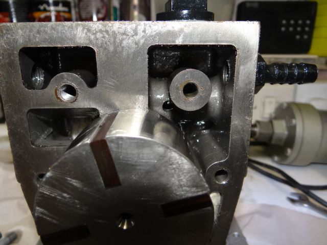

      Opening it up revealed a rotor with four fibre vanes running in an offset circle – a vane pump.

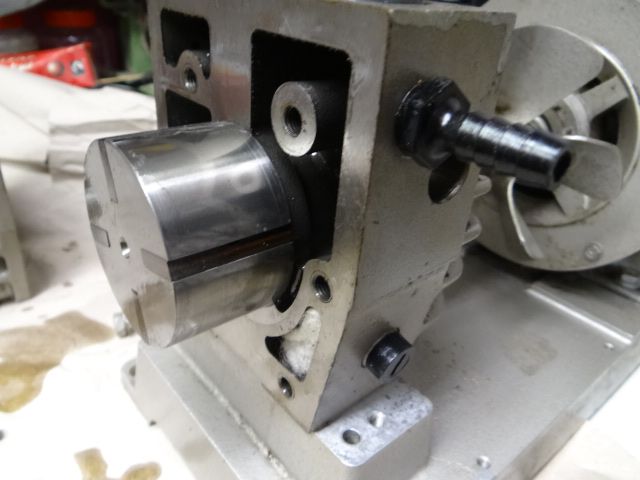

      The black nozzle top right photo above is for the vacuum hose. Below near the base is a plastic screw screw cap covering a felt pad with access to a chamber filled with coarse fibre: could be a filter, or an oil pad. Anyone know if this is the oiling point? The pump would have to be tipped sideways to use it.
      Just underneath and to the right of the black vacuum connector is a big spring loaded slotted steel screw ending in a rod fitting into a hole. It probably communicates with the vacuum side – see below. I think it's a valve of some sort. Anyone know what it is?
      The vanes don't seem worn and there's no physical damage inside to speak of.
      As the pump is covered in cooling fins and has a 500W continuous motor I was expecting a more powerful vacuum and better compression. Have I bought the wrong pump and am I expecting too much?

          Are the vanes free to move in and out? They might be spring loaded or move out under centrifugal force.

            You've not said the vanes are free to move? beaten to it
            This sounds like to be an oil trap for the bearing breather, perhaps to stop it pumping all the oil out.

              anyway check that the vanes are free to slide in and out and don’t expect much of a vacuum with it..

                The vanes slide in and out freely – no springs. The construction doesn't seem to provide much of a seal at the ends which implies low compression. Could be it's a dental spit sucker, designed to run continually without enough power to disembowel anyone!

                  It looks like a dry pump, As Ian Parkin mentioned the oil pumps tend to have steel vanes. The vanes you have should be free to move in their slots. The Felt pad etc is probably a filter to remove worn vane debris from being blown out by the pump. The slotted screw is probably a vacuum valve (the reverse of a pressure valve) to stop it drawing too much vacuum .

                                      Pleased to report the pump is much better.
                                      Took it apart again and went over it carefully. There are no valves.
                                      I believe the improvement is down to putting oil in the right place. Not just a lubricant, I believe it's part of the sealing system. When the pump is running I think oil is pulled out of the padded reservoir and into the gap between the cylinder end and the rotor block where it fills the gaps and makes it difficult for air to leak past the rotor blades. I cleaned a thin layer of caramelised oil off the end-face that may have stopped oil flowing into the gap properly.
                                      Anyway, the pump now pulls a markedly stronger vacuum on a rigid cylinder. Wish I could find the missing gauge to see how good or bad it is!
