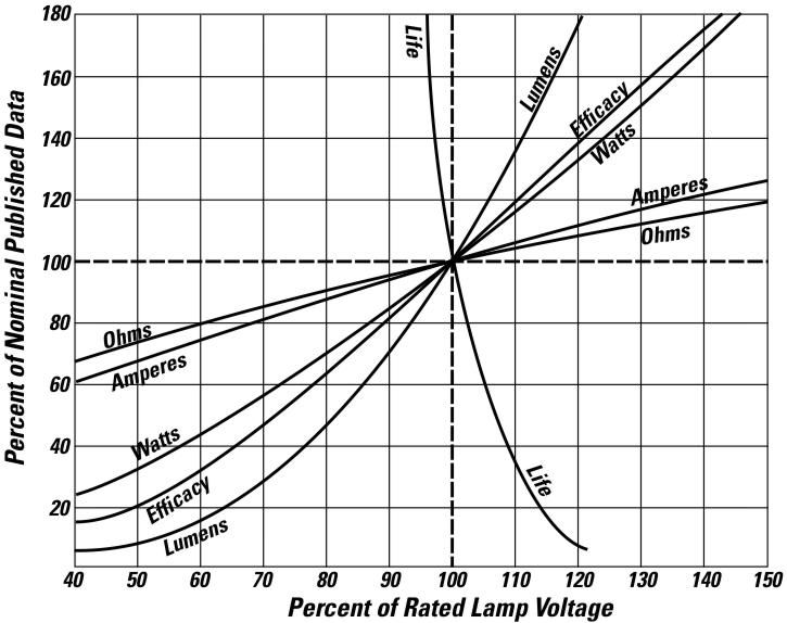

      I think the graph on this page is what we are looking for –
      **LINK**
      small changes in the supply voltage have a dramatic affect in the fife of the bulb

        Yeap! – that look like the one. Thanks.

            I'm not helped by a supply voltage very close to the maximum.
            I've always fancied having a big old meter on the wall reading the supply voltage.
