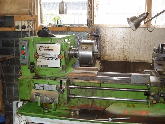

                            dsc00993 (640x480).jpgMy Taiwanese 13 24 Belt head, back geared lathe has 40 imperial threads, from 4 . 5 tpi to 112 tpi, metric 23 pitches from 0.25 mm, to 11 mm. Diametral pitches 23, 8 – 224 DP. Module pitches 15, 0.25 – 3 MP.
                            The power feed: long .0036" – .1005"? rev
                            Cross .0012" – 0.690"/ rev, 40 of both.
                            I would say a reasonably versatile machine, I think there should be something similar available, probably from PRC.

                              Ian. That is a Warco BH600 style discontinued through lack of interest as gear heads got cheaper but still available as the Chester Craftsman. Price ….£2800 so not piggy bank more like HSBC swiss bank. It has gone up about £500 as far as I can remember in the last year while slightly smaller lathes as we see above seem to be coming down.

                                That's a very nice lathe you have there, I remember them here in the UK. Warco used to sell them as the 1327 in the 1990's, the last quoted price was, I think, £3800. They also did two geared head versions during the same period, one with an open Norton type gearbox like yours, and another with fully enclosed box which cost around £5500 back then. My £3000 when new Warco 1330 is the Chinese version of that one.
                                The BH600 that Bazyle refers to is a Chinese made version of another good quality Taiwanese made lathe that Warco used to sell in the 1980's, I think they called it the 300B, or something similar, and these were also marketed as LAM and Lantaine elsewhere. These had the rare feature of a triple V bed, with the carraige guided by two V ways, as on Boxford and Southend, this feature was lost on the Chinese made version.

                                  At the time when I bought the lathe, the same factory was producing lathe beds exactly the same as this, and in longer sizes for Colchester. I would have liked either the 1336 or 1340 size, but at the price I payed, I'm very happy with what I have. I could have had two of these plus some change for the price of a Myford Super 7.
                                  The lathe has a 38 mm bore in the spindle, and I run Power Twist link belts.

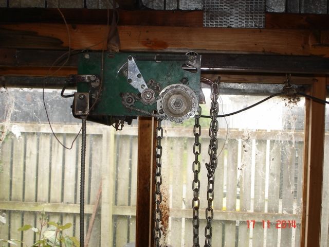

                                  Please note that the chuck is hanging from my home made electric hoist,  8" chuck, quite heavy. The hoist is powered by a garage door opener, normally 36volt, but running off my 18volt power supply.dsc00994 (640x480).jpg
