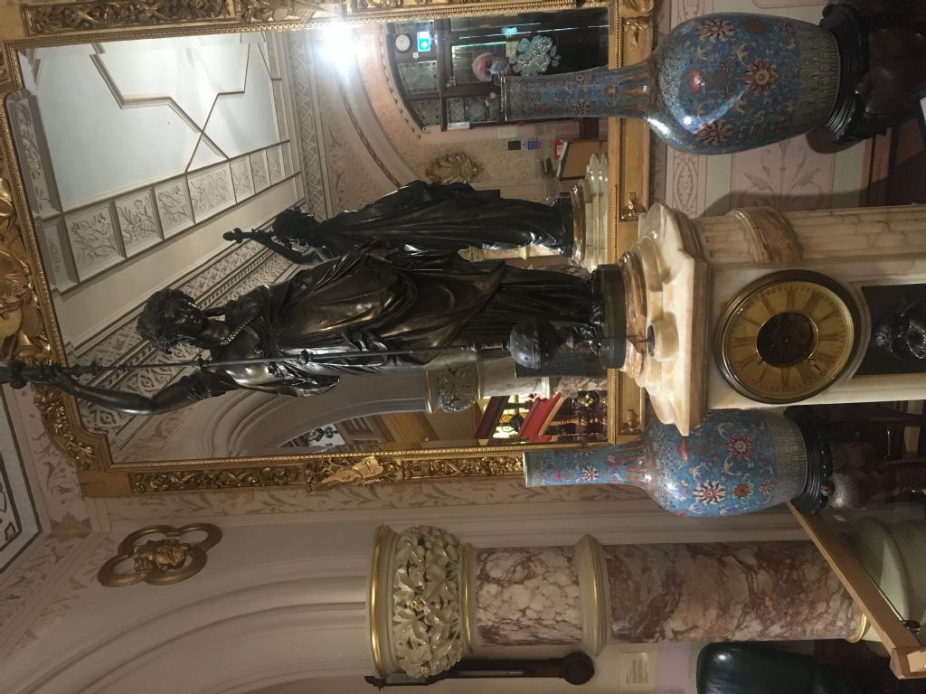

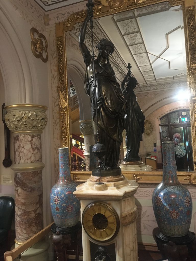

      While on holiday recently, my wife and I visited a stately home where i saw this clock. Viewed from distance, I couldn't see how the pendulum was getting an impulse until I looked closer. As I'm a new clockmaker, I hadn't seen anything like it. It seems to have solved the inherent problem of inertia when the wheels stop and start.

          Looks amazing but I don't really understand what's going on here. Was the clock running when you saw it?

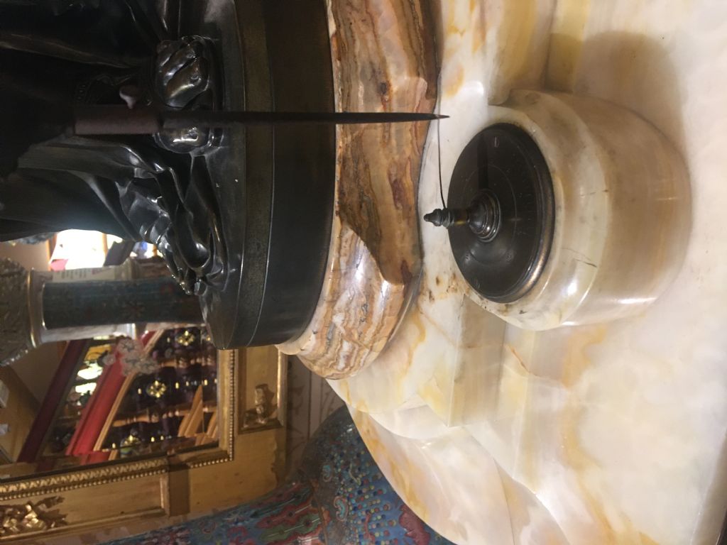

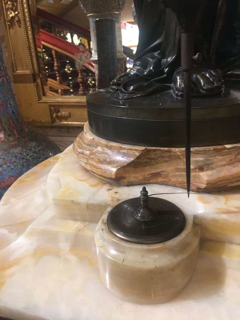

            Yes the clock was running. In the middle photo, you can see a spindle coming out of the clock which was rotating and pressing onto the base of the pendulum. I suppose strictly speaking, the pendulum is describing a circle rather that oscillating.
            The title of my post is also misleading as it isn't an escapement in the true sense.

            Sam Stones
              @samstones42903
              Hi David,
              I just had to turn your pictures around.
              Cheers,
              Sam
              PS I haven't figured out how the impulses are transferred.

                There are no impulses! The thin needle is driven from the clock mechanism and without the pendulum, would be free to spin out of control. With the tip of the pendulum pressing on it the spin is restricted as it tries to push the pendulum away.

                              Is the 'pendulum' working like a governor? The needle rotates with a constant torque, which drives the suspended bob, which moves outwards, increasing the cirumference of its rotation, until the forces are balanced? Hopefully that point would be associated with the correct rate of the clock. Sounds like there would be a lot of room for error in this arrangement.

                                  Is the connection from the string to the motor shaft offset from the rotation axis? If so we would have a different model to the one in my original link
