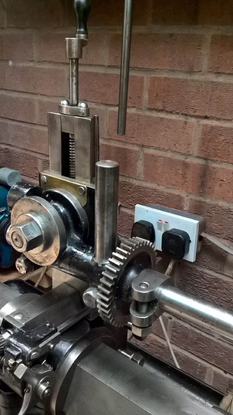

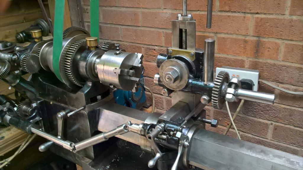

      An unidentified attachment that came with my Pittler C3 lathe that fits on the toolholder thread of the cross-slide. It has a see through spindle with a gear wheel fixed on and the spindle has a small taper and but not MT or anything I recognise, it can tilt to different angles and be raised and lowered with a handle like an elevating slide rest. connected.jpg

          I think that it's most likely a gear cutting attachment. The hollow spindle holds the blank via a drawbar and tapered arbor. The vertical shaft must be fixed as it crosses axes with the rotating spindle so that's most likely a mount for a direct-indexing fixture. The gear is probably swappable with other lathe change-gears or it might be a handy integer like 48T. The 45 degree each way scale makes it handy for making bevel gears.
          Can it be mounted 90-degrees rotated from it's present orientation?

            As Pete says, and possibly other indexing operations. Presumably would require a verical milling head to make it usable? The spindle casting has an additional boss, so perhaps a home-brew made from existing parts or own castings.
            The fine adjustment on the cross-slide is interesting. Seems overkill for adjusting depth of cut for gear teeth, or maybe its for grinding?

              It can be swivelled or mounted in every conceivable direction also taking into account the round saddle of the lathe. It could be swivelled to face something held between centres, also the saddle casting can be turned over so that the cross-slide is installed from the nearside. I haven't counted the teeth on the gear, I'll check it
              The gear is fixed to the bolt casting you see on the photo so no way to add different gears.

                The milling head normally supplied by Pittler would make this thing cumbersome by comparison. If using one then the cutter is held in the headstock as most likely with this attachment.
                No home made stuff, the whole thing is really well made with jib adjusters etc, also parts have beautifully engraved single letters here and there.
                You mention the cross-slide but it is not part of the attachment, what you see is the normal Pittler C3 slide lots of photo's in my album if anyone is interested

                  Is it all there? I would maybe expect a worm wheel fitted to the vertical rod mating with the skew spur gear and then indexing plates. That is if it is an indexing attachment.

                    Vic, I didn't make clear that I was referring to the slide at the bottom of the attachment. The surprising feature for me is the small worm and wheel, is there a ratchet that operates it? I can't see a micrometer dial to indicate the amount of travel.

                      This has to be something rather different from a gear cutting attachment

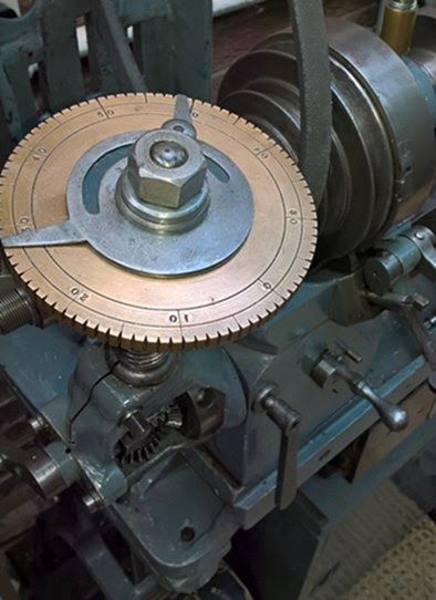

                      Pittler lathes were the worlds first universal milling and turning machines, they specialised in being able to do all sorts of ornamental turning and attachments were made for cutting of spirals, worms, wheels, bevel cutting, ball turning etc and non of them look anything like this.
                      The standard equipment included a dividing spindle as in this photo from my other Pittler, using this in conjunction with the standard milling head would make this attachment utterly pointless. It just doesn't add up, the long length of the spindle makes no sense either, very odd indeed

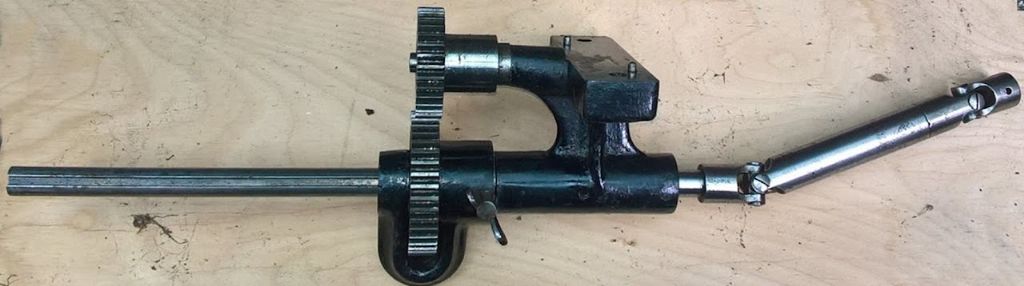

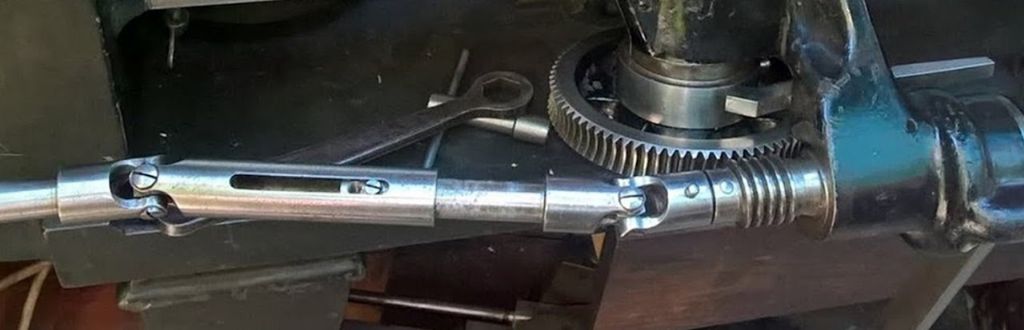

                              the worm and wheel are for power cross feed via the universal joint, because the leadscrew is inside the bed this is how von Pittler got around the problem. The machine also has a power circular feed using the same UV
                              here is a video of me testing it out Power cross-slide on the Pittler C3

                                    I'd go with it being for e.g but not solely, gear-cutting using the cutter in the chuck, and a gear (one of the lathe's own change-wheels?) as divider. The sturdy stanchion would hold the detent, and if that's missing it ought be reasonably easy to make one compatible in style and quality with the machine generally.
                                    The power cross-feed would be part and parcel of such use; but presumably also for plain turning. Though the universal-joints look rather close to their angular limits for consistent rotation: can their first shaft be set further back?
                                    It is all a beautiful machine-tool anyway, evidently made for fine work.

                                        If you look closely at the photo, the gear that is on it at the moment is not a straight cut spur gear. Its teeth are sloping/skewed/helical. That may support the suggestion someone above made about a worm to mesh with it which may be missing.
                                        Why did they drill out the 'wings' of the wing nut? Is that like a loud exhaust pipe or go faster stripes?

                                            I see what you mean! It has a very gentle helix angle though, and is definitely not a regular worm-gear.
                                            I looked at the drawing Michael's link opens, of Pittler's patent-application for a universal milling-machine. That is festooned with worm-drives, so it's feasible that Vic's lathe attachment gives the some similar functions. Although the patent drawing shows the worm-wheels are clearly that.

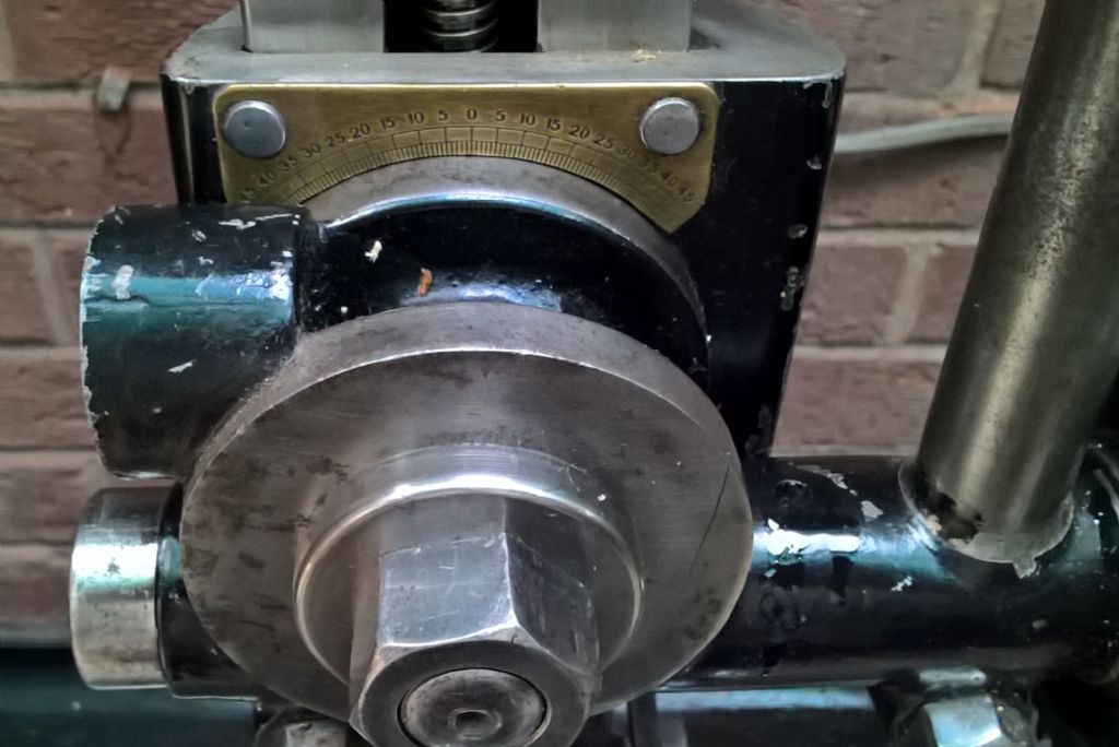

                                            There is another detail about it. Outside of the gear is what looks like a locking detent that engages a hole faintly visible on the second photograph. There appears only one hole in the wheel, and the detent does not seem a quick-release type.
                                            Vic – I reckon you'll have to carry out some careful experiments!

                                                  The universal joint still works at acute angles and is intended to be used near the headstock end of the lathe, it's long shaft has a keyway slot that locates in the inline gear wheel so can slide along to it's limit. there is also a short further extension as in the photo below which shows a gear fitted on the end of the cross-slide stem for ball turning

                                                    The holes in that wingnut were made by a previous owner, the other one at the rear that locks the cross-slide stem is as original with no holes in it

                                                      The hole you mention is for oiling the spindle as it goes right through

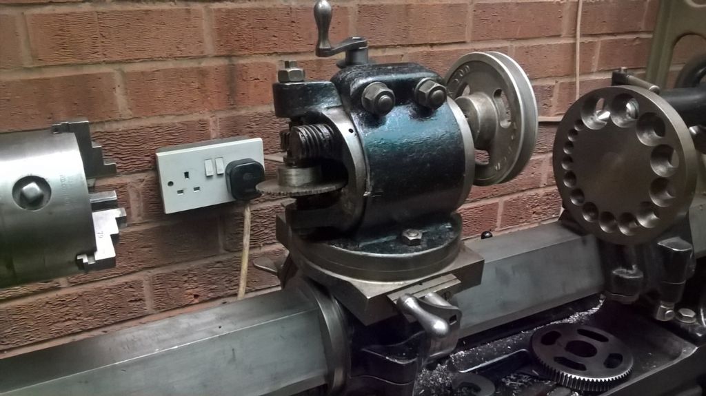

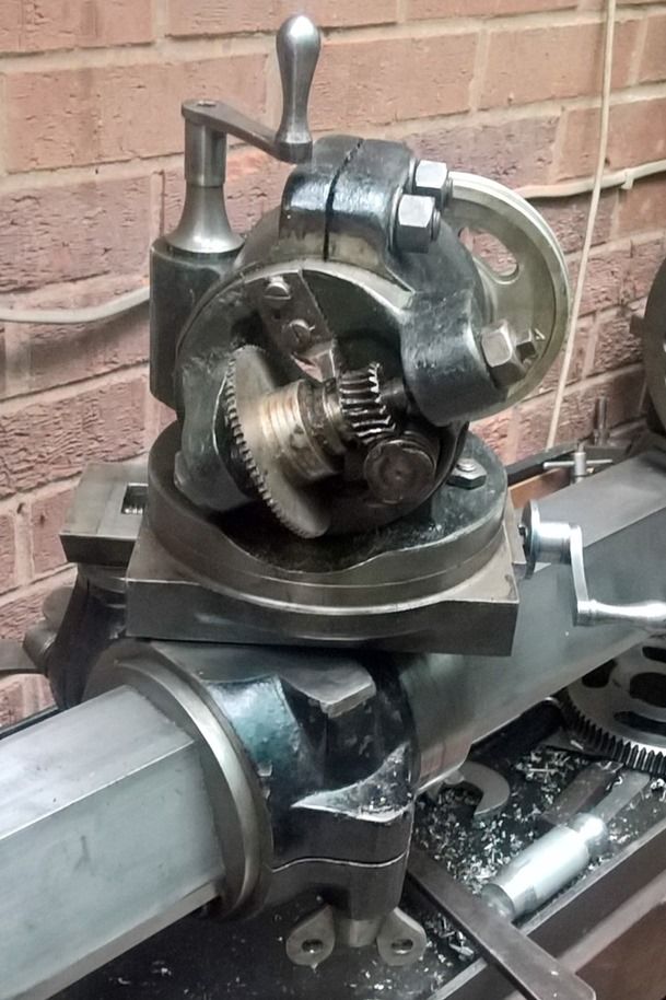

                                                      however here is a rare type of drum type milling head I got with the machine, it has a stem that fits in the saddle casting in place of the cross-slide and is powered from an overhead drive.
                                                      It has a cross-slide and and rotation of the drum and it's cutter via top handle. It's cutter can be turned to any angle and runs via the worm and wheel mechanism. Not got the overhead pulley set up so not tried it yet.
