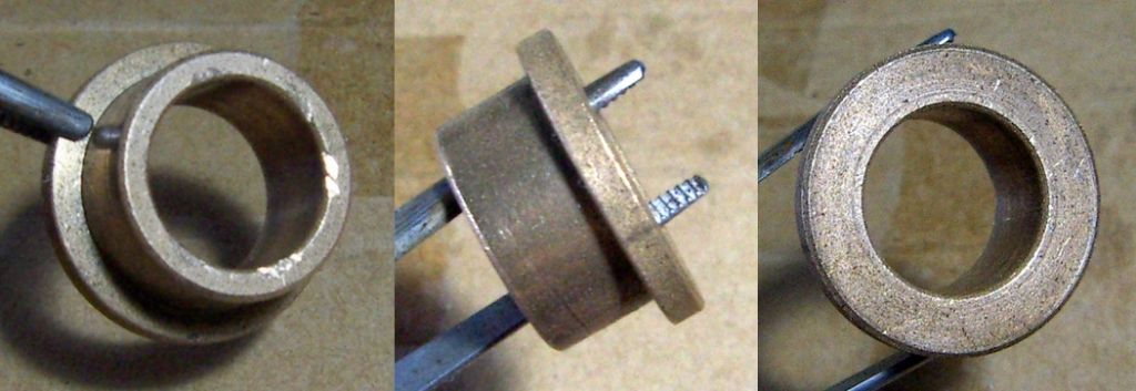

                                #625462
                                  #625469
                                  Julius Henry Marx
                                    @juliushenrymarx92355
                                    Hello:
                                    @ Michael Gilligan: Thank you for fixing that for me.
                                    I was able to remove the bushings, slid out very easily.
                                    But I hould have used a wooden dowel, I tapped them very softly, did not expect to leave any marks. 8^*
                                    The nominal dimensions according to the post by Dan Hook above are:
                                    ID 15.0mm, OD 20.0mm, depth 12.0mm with a 25.5mm flange.
                                    The samples I removed have these dimensions, taken with a caliper:
                                    Bushing #: 1 2
                                    Height: 11.9 11.9
                                    ID: 14.8 14.9 <— has 0.1mm wear / must be the lower one
                                    OD: 20.0 20.0
                                    Flange: 25.0 25.0
                                    I am now on the search for a new, modern version of these bushings ie: harder, less friction or maybe the possibility of a set of bearings which could be just 'dropped in' without much ado.
                                    The F6802 bearings mentioned here are still available but to use them I'd have to get someone to put the quill on a lathe, not the Unimat 3.
                                    Best,
                                    JHM

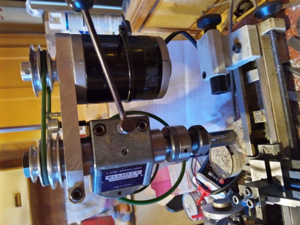

                                          #625529
                                          david bennett 8
                                            @davidbennett8
                                            img_20221220_142201_3.jpgI became so disappointed with the bearing system that I changed the whole thing to a sl/db head. No comparison.
                                            Sorry for sideways view (again) dave8
                                            Edited By david bennett 8 on 20/12/2022 14:54:00

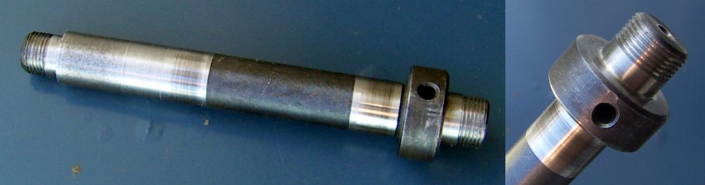

                                                #625644
                                                Julius Henry Marx
                                                  Hello:
                                                  Thank you for the prompt reply.
                                                  > … easily distinguishable by the dark, nearly black band …
                                                  Here's a photo of the spindle I have, seems to fit your description.
                                                  > … your spindle is about right … … about 0.009 mm of wear. (Based on the 14.98 mm figure)
                                                  I see.
                                                  I don't have much/any experience in the tolerances field.
                                                  Is this amount of wear reasonable, should it be less or should there be no wear at all? ie: is it the result of the lack of proper maintenance?
                                                  As I unmounted the spindle, I was rather surprised to see practically no oil, just some some traces of a black and rather dense (very hard to wash off my hands) grease.
                                                  > … Oilite bush when inserted will probably give up to 0.05 mm total clearance on your shaft.
                                                  The bushings I have found to replace the OEM ones are the SKF mentioned earlier and a locally made set (a company with 40+ years in the market), with what seems to be the same spec as the SKFs. I'll be getting the exact data via email later on.
                                                  > … well be better than this if Emco made the Quill Housing bearing register deliberately undersize …
                                                  The quill housing diameter, measured with the same caliper/eyesight setup used earlier, read 19.90mm and the extracted bushings read 20.0mm. Is that what you are referring to?
                                                  > … replace the bushes with SKF sourced originals.
                                                  Yes, I would not go for any other except the locally manufactured ones but I still have to confirm availability and price for the pair of SKFs. The locally manufactured ones will set me back ~ US$10.00 for the pair with the only caveat that they are 18mm long instead of 12mm, which I don't see as a problem as I can fix that on the U3 or even leave it at that if it does not cause any issues.
                                                  > … remember to reduce wear you need have a film of oil for the shaft to rotate on. Get the clearance too small
                                                  > and there is no room for the film of oil and the parts will wear prematurely.
                                                  Will do.
                                                  The quill does not have a way of being oiled, would packing grease on reassembly (like the chap in the video does) help?
                                                  In both the bushing options I have available the nominal ID is 14.0mm.
                                                  I suppose that I will have to touch that a wee bit to be able to slide in the spindle and have enough clearance for film of oil needed.
                                                  With the spindle races clocking in at 14.98mm, what ID should the bushings have before insertion?
                                                  What would be the best/more reliable method to achieve that ID sizing?
                                                  > … full length bearing also increases the amount of power required to drive the spindle …
                                                  Makes sense.
                                                  Thank you very much for your input.
                                                  Best,
                                                  JHM
                                                  Edited By Julius Henry Marx on 21/12/2022 13:10:18
                                                  #625652
                                                  Graham Meek
                                                    @grahammeek88282
                                                    Hello Julius,
                                                    The Quill housing bore is as I suspected down on the Nominal 20.00 mm bore size. This will tend to close in the bore of the Oilite bush and give you a closer running fit. I don't think you will get a very precise reading with a vernier on this bore size. I would anticipate the actual size to be in the region of 19.95 to 19.97 mm.
                                                    The Oilite Bush I would expect to be around 20.03 mm diameter before insertion. It is best to press these bushes in or use a large washer and some studding to draw them into position.
                                                    As supplied an Oilite bush is impregnated with oil, and just for good measure they should be soaked overnight in oil before insertion. They should go for many, many hours before the need to replenish this oil.
                                                    Grease will tend to clog the bearing and stop the release of the impregnated oil in the bearing. Plus grease in a cold workshop will provide a huge source of drag on the spindle with such a small motor. As I said earlier I would oil using an ISO 32. If you oil in the recess at the top of the quill and leave it to stand, the oil will find its way into the quill. Failing that if you really want to be sure, immerse the whole quill for 24 hours in a container filled up to the flange with oil. Then allow the excess to drain out afterwards before use.
                                                    I cannot see why you are going for 14 mm bore bushes. When 20 x 26 x 15 bushes are widely available, or was this a Typo error?
                                                    Regards
                                                    Gray,

                                                      I didn't think so either but I don't have the right instrument for that yet, it is quite dear.
                                                      > … would anticipate the actual size to be in the region of 19.95 to 19.97 mm.
                                                      Right.
                                                      > … would expect to be around 20.03 mm diameter before insertion … … best to press these bushes in > or use a large washer and some studding to draw them into position.
                                                      No press immediately available. Will have to use some other reliable method.
                                                      > … bush is impregnated with oil, and just for good measure they should be soaked overnight …
                                                      Yes, I've read about that.
                                                      > Grease will tend to clog the bearing and stop the release of the impregnated oil …
                                                      Right, no grease then.
                                                      > … oil using an ISO 32. If you oil in the recess at the top …
                                                      Yes, I'll do just that.
                                                      Thanks for the heads up on the grease.
                                                      > … why you are going for 14 mm bore bushes.
                                                      No, no error.
                                                      I only found 14×20 in the SKF catalogue and the local chap offered me the same type.
                                                      I have sent them an email asking about 15×20.
                                                      Does it matter if they are longer than 12mm?
                                                      Best,
                                                      JHM
