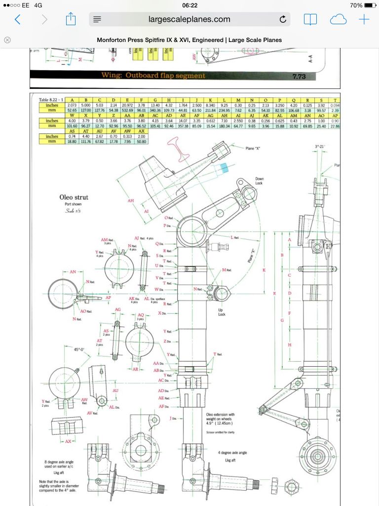

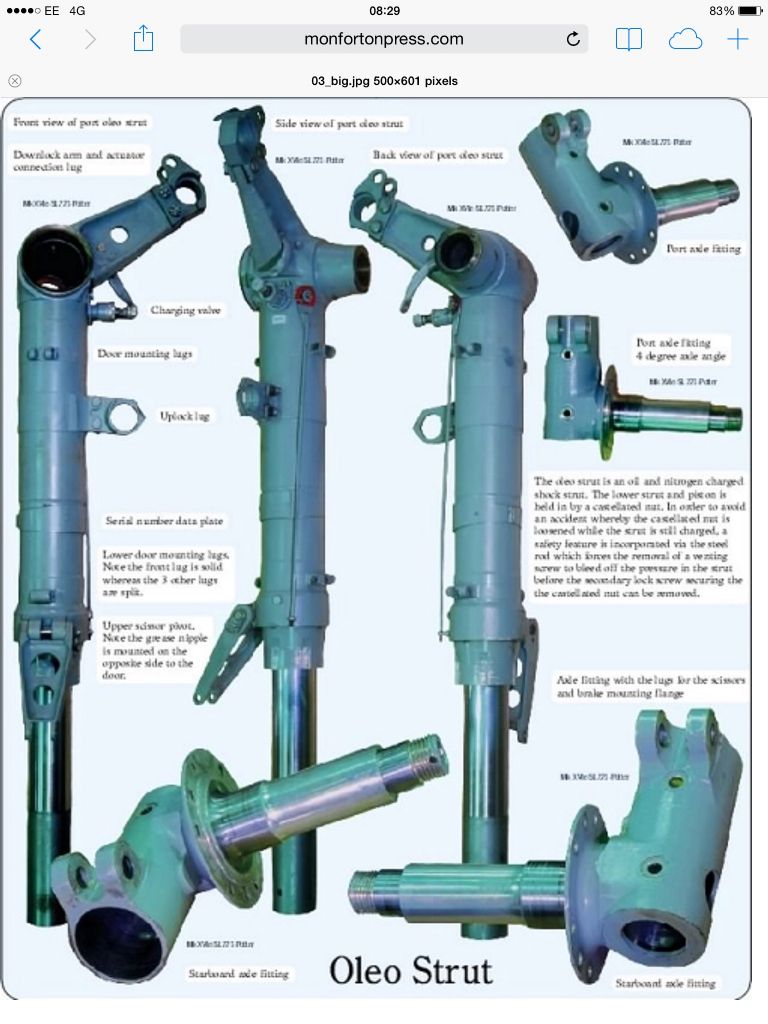

        I'm building a 1/4 scale rc spitfire I need some advice on maching the undercarriage
        Would it be possible to mount a solid piece of alu into a 4 jaw chuck carve out the outer detail and bore the inside to correct diameter to allow an oleo tube to fit inside and machine the rest with a milling machine I know it's a big job can you also suggest a suitable lathe which for the job ?

          Possible but certainly not an easy task for someone new to turning.
          The angled part at the top will dictate the size of lathe needed as you need to allow that to swing while turning the main leg so that puts it a 5" swing and over but for comfort I'd be looking to allow quite a bit over that size.
          An easier method may be to make it drom 3 bits of steel tube silver soldered together and then add the detail, depends how much weight you can afford to add

                          I think you will need a gap bed lathe if I read the dimension of the upper section correctly at 9.25" and not easy to hold. I would be inclined to cast the upper and lower sections with a tube for the middle. I would screw the sections together Loctite to seal and hold the position.

                              Bob I took it that these were the full size dimensions and the part would be 1/4 of that.
                              3.92" sounds about right for the OD of a full size strut

                                  As for the Oleos, I think you need to go down the Lost Wax Casting route

                                      I agree with Nick, . lost wax casting for the axle fittings maybe with the master 3D printed in wax.

                                        Having built both model planes and having a lathe etc…If I wanted an undercarriage like this, to good scale, I would do a 3D model and then have it cast by lost wax, as suggested by others above. There would still be some machining to do, but you could have a good quality job. As I see it there would be two castings, the lower piece with a steel stub axle pressed in and the upper piece. There would be a steel tube leg, with a spring inside. This would make the job quite similar to making the full size one, and if you paid someone to do it no doubt the cost would be similar. Still, the necessary machinery to do it yourself would not be cheap either.
                                        It doesn't strike me as being the ideal first job for a newcomer to machine tools.
                                        Having seen what can happen to model undercarriages, I'm not at all enthusiastic about gluing one together with epoxy, or any other sort of glue. When they use glue on airframes it is for large areas of sheet metal with good contact areas, not for highly stressed local loads.
