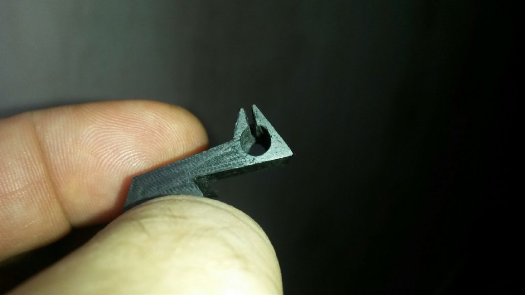

            #304906
            Chris Baetens
              @chrisbaetens16442
              These 2 pictures tell it all.
              The green part is printed on one of my older printers. Many people will think, not bad at all.
              But looking at the second picture, that black part is printed with my Ulti-Printer, judge for yourself. The quality of that perimeter is far better compared to the green part.
              Edited By Chris Baetens on 30/06/2017 08:14:56

                            #305077
                            Nick Hulme
                              @nickhulme30114
                              I printed this yesterday on the same printer Neil is using
                              You can't see in the photo but it's 18mm deep and the side you're looking at is the top, it works too
                              #305078
                              Chris Baetens
                                @chrisbaetens16442
                                Posted by Nick Hulme on 01/07/2017 13:58:11:
                                Nicely done (too)…yes
                                How about the perimeter, good too..?
                                #305080
                                Nick Hulme
                                  @nickhulme30114
                                  Thanks,
                                  Yes, the perimeter is very nice too, a couple of wipes with wet and dry and it's as flat as a flat thing, I didn't show it because the post-processing is already done
                                  – Nick
                                  #305081
                                  Chris Baetens
                                    @chrisbaetens16442
                                    That's just what I try to avoid in the first place, it has to be perfect without post-processing.
                                    as matter of fact that's what the built of this printer is all about, perfect perimeters.
                                    This part is ok, but still has some minor issues. I keep working and searching until they're gone to.
