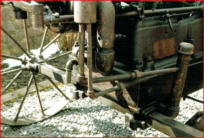

                              Brian and Phil, I want it for the side rails of a cart to mount a hit and miss engine on. I need to play around with some sizes as this engine was usually mounted on a simple wood sled with cast wheels but I have been asked to do it on an all steel cart that is more often found on the larger HP engines.
                              This is a rather poor scan of what it is likely to be like, not sure if you can make out the two inward facing channels with a timber cross piece. Hubs should be fun toofrown
                              J
