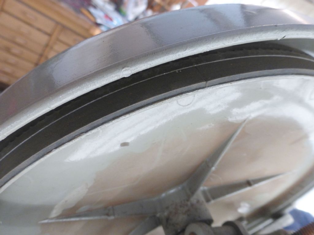

        I've inherited a Naerok bandsaw for wood, it looks exactly like the Clarke 360.. It hadn't been used for a number of years and the drive belt had stretched so I replaced it with a polyurethane one. When I tried sawing, it kept shedding the blade. I thought I'd fixed that and then one of the two tyres disintegrated. Further investigation suggests that there should be 3 tyres – one for each wheel, but now there is only one.
        Can anybody suggest where I can get replacement tyres please?

          When I replaced the tyres on my 14" wood bandsaw I used self amalgamating tape as used by electricians. It's still on after 10 years. Others have used Plasticote and Plastidip, both available from online suppliers. Nathan.

                    Thanks for the suggestions. Scott+Sargeant are far too pricey so I'm going to try Nathan's suggestion of self amalgamating tape.

                      Gary, if you're going to use the tape as I did you must make sure that the wheels are clean and abraded. I used two separate layers with the joints 180* apart on the wheels. Hope it works for you. Nathan.

                                    I also have one of these Naerok machines, and was faced with the same wheel tyre problems putting it out of action. Thanks to your post, I have since used the method suggested by Mark Smith 20 with complete success. I used 12 x 1.5mm neoprene.

                                      I purchased a roll of the self-amalgamating tape but since it was 20mm wide and the tyres are only 12mm I put it to one side while I figured a way to accurately trim the width.
                                      I then saw Alastair's and Mark's posts about neoprene and bought a roll of 12×1.5mm, cut lengths equivalent to 75% of the circumference and superglued the ends together. When stretched over the wheels the tension is so great that I didn't bother with glueing them on. They worked perfectly. We'll see how long the superglue holds.
                                      Good result, the saw is back in service. Thanks everyone.
