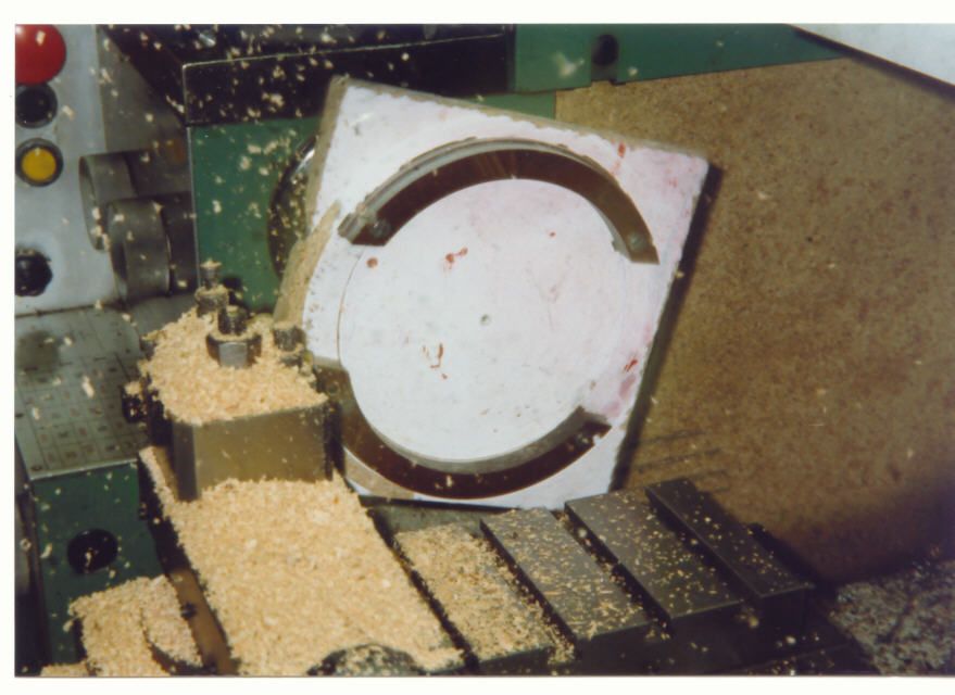

        Been making a couple of disks from 1/4 inch paxolin. The tool traverses from right to left and as it leaves the left hand side a small amount of delamination takes place. Not serious for this application just not a tidy job. But how do I avoid this happening – turn from each end towards the middle perhaps. Or is there a better way?

          You could place a sacrificial piece of wood or maybe metal behind it to support the edge.

            I think those are the two ways – back up the piece with another piece of waste stock or cut from both sides to the middle.

              I used a piece of chip board as a backing when turning sections for my traction engine brake blocks in Tufnol. Mike.Tufnol
