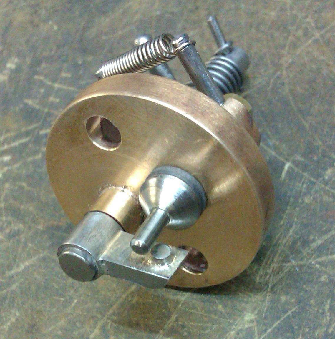

              We don’t know if the OP is using a modern CDI or a traditional coil in which case Tungsten will perform just like it does in a car’s distributor but will not look ugly like a set of points screwed onto a model engine can.
              The tig rod also works well for ignitors which see the ignition spark jump between the two contacts insid ethe cylinder.
              Example below, the small disc on the hammer and the round shaft it breaks contact from are where the spark jumps between are from a tig electrode.

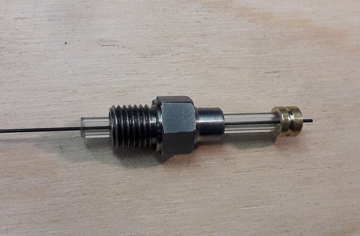

                You can also use Tig electrodes to make your own spark plugs. These are 1/4 x 32 thread, just needs the excess cutting off once the top cap has been soldered.
                20191124_162021

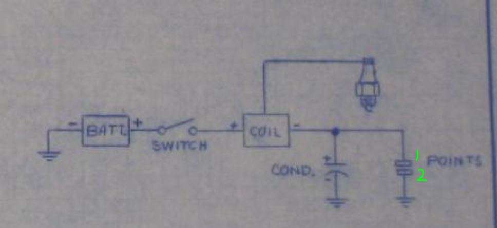

                    Fairly standard circuit. When the points are closed the circuit is complete. When they are open the circuit can’t get to ground as it stops at the insulated contact.
                    points 1
                    points 2

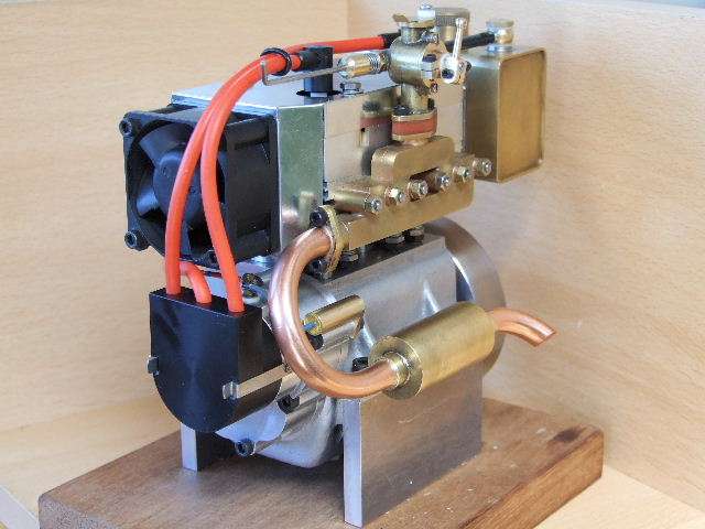

                      I get a much fatter spark on my Farm Boy with its Chinese Hall effect magic box than I do with my Wyvern with its MiniMag coil and points.  The Farm Boy is a much easier starter, just a flick of the flywheel.
                      However, regarding the points and correct me if I am wrong but I think the only reason to use Tungsten is because it resists pitting from the spark.  Is this important on a model that will only run occasionally?

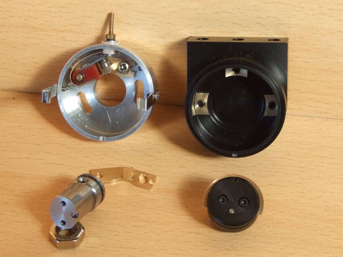

                        I also use a Chinese magic box on my Farmboy but can’t immediately see an easy non conductive mounting for the trigger magnet. Like yours mine will start first flick as well. Something tells me that the more complicated Wyvern Will require a bit more trial and error to start with!
                        Jason – Thanks for the schematic, it all makes sense now.

                          Rod, Like you my practical experience with model IC engines shows that there is no problem, just a theoretical one that won’t manifest itself.
                          Combine the much slower running of even a throttle goverened Wyvern let alone a hit and miss with the short run time most will see and it is never going to happen.
                          Worth saying that if using a CDI and just two of the three wires that go to a hall sensor as the two contacts then they see a minute current and can be whatever you want from mild steel to a brass strip and will not show any pitting or carbon build up. This 2 wire setup is how I tend to run my CDIs then you don’t have mounting the sensor to worry about.

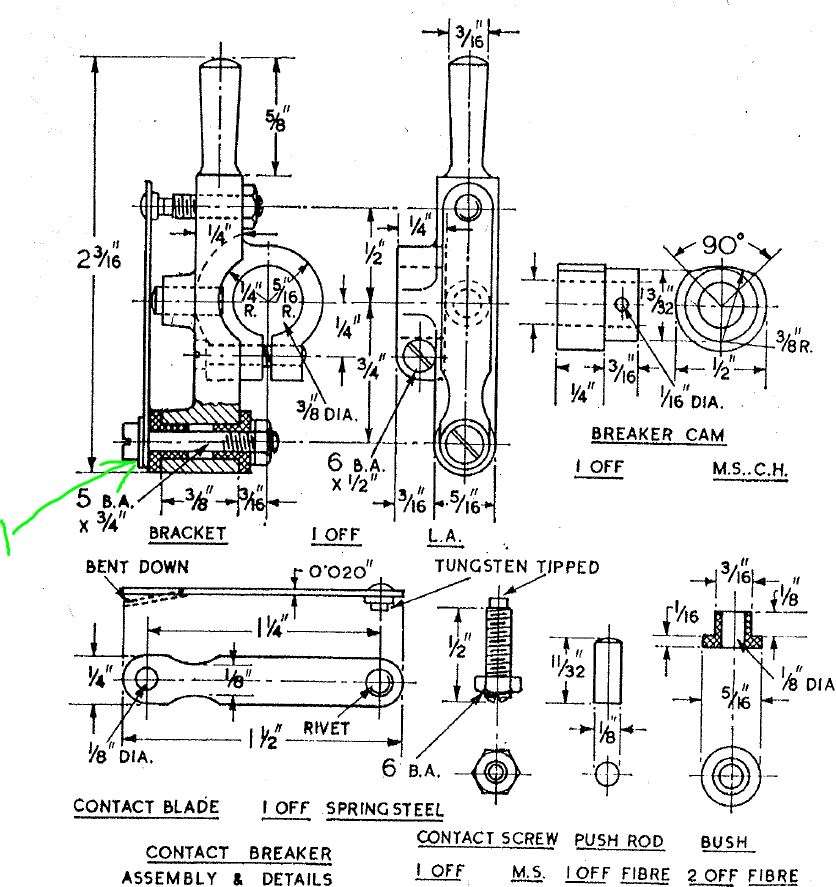

                                        Not sure exactly what size you need, but have you considered ex GPO/BT/Strowger relay contacts??
                                        Ebay is one source, but there will be others. Many sets are twin contacts, but some are a larger single contact, and there are even more exotic materials such as platinum or palladium.
                                        I spent many happy hours adjusting these in a former life.
                                        See fig 4 in this document
                                        https://britishtelephones.com/relay3000.htm
                                        Bill

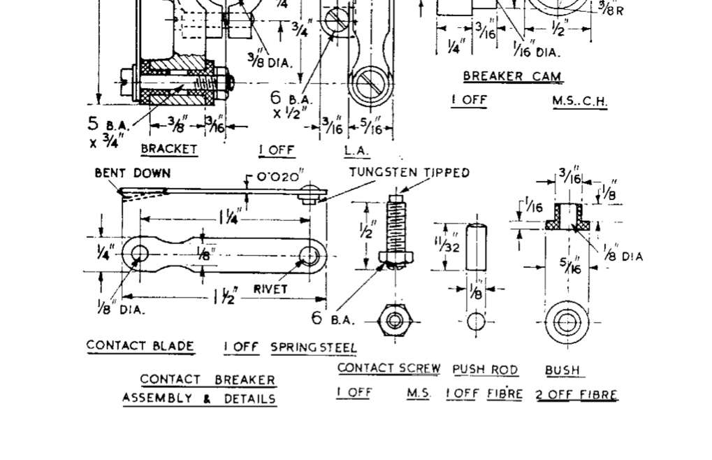

                                        #799167
                                          Bill
                                          Here’s a grab from the rather crowded drawing:
                                          Posture
                                          With your experience, you might well be able to “reverse engineer” the design !
