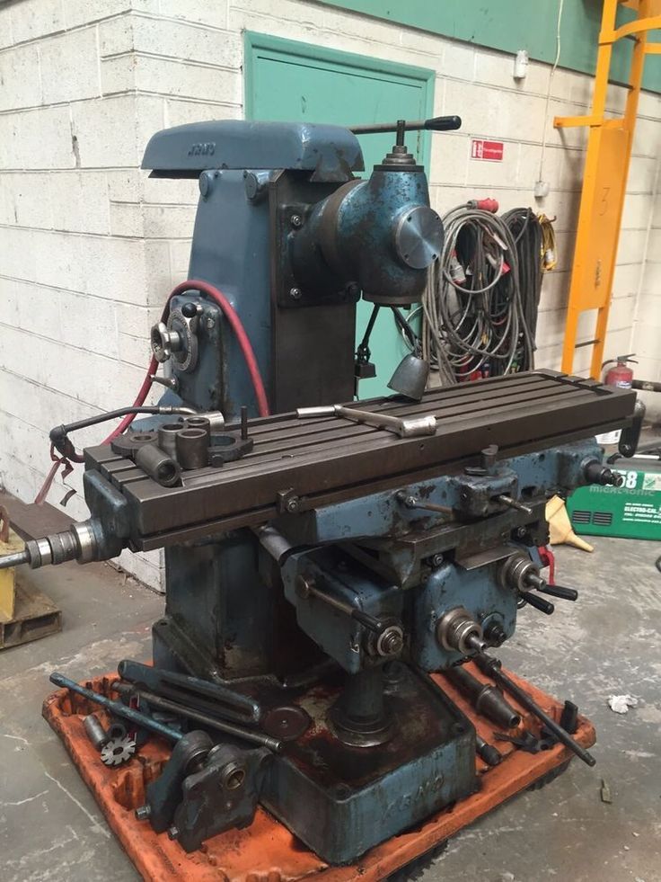

                                        well here she is home , took longer than expected and a lot heavier than expected !
                                        without an engine crane we wouldent have moved it at all!
                                        cant find anything wrong with it yet other than a few oil leaks which are easy fixes.
                                        some slight backlash which is to be expected with a machine of this age .
                                        has lots of coats of paint on , in some areas 5mm thick!
                                        does anyone know what colour this would have been from new?

                                        #231419
                                        John Fielding
                                          @johnfielding34086
                                          Congratulations!
                                          Looks like a good piece of kit to have. If the original pictures of the miller are anything to go by then the table looked in excellent condition. No obvious dings or other damage, so it has been well looked after. Things like slideways etc can always be fettled, but those generation of machines were built to last. As long as no cracks etc then all it should need is some TLC and it will run for another 50 or so years!

                                            #231452
                                            Hopper
                                              @hopper
                                              Looks like a very nice bit of kit.
                                              An archeological dig to the bottom of that 5mm of paint might reveal the original color.
