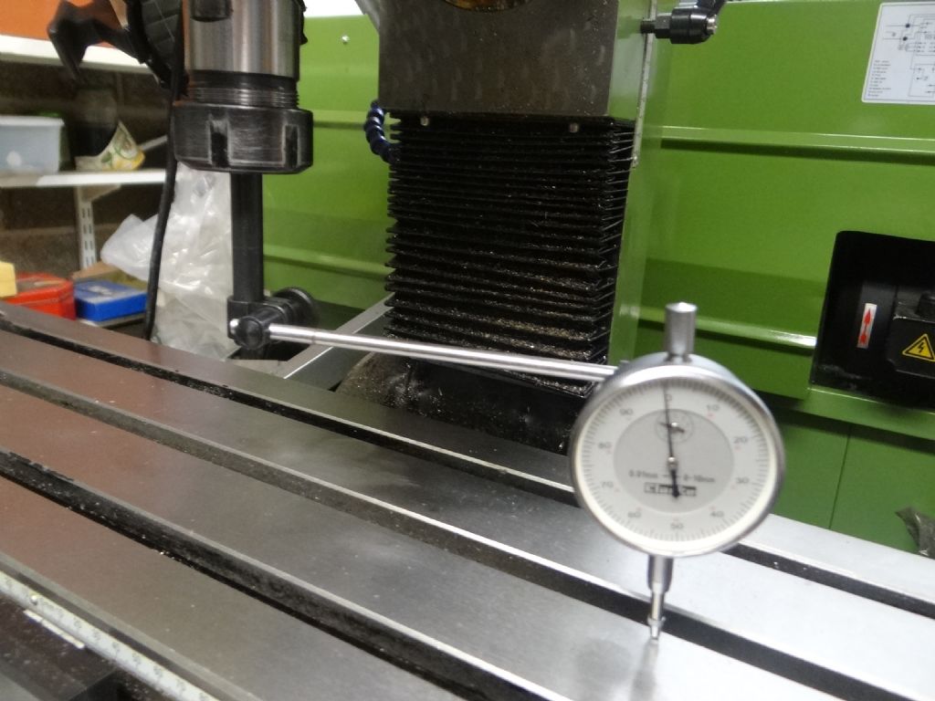

      Not wishing to hijack Edward Crouch's tramming thread so I've I've opened a related question. I've just re-trammed my WM18 after a dig in turned the head slightly. The mill is fitted with a stop screw to facilitate re-alignment but I don't entirely trust it.
      As usual I've done the job by guessing the procedure. This isn't clever given that I could easily have asked on here first!
      My first attempt to measure unwanted tilt involved using a DTI in a collet and a set-square bolted to the table. It was immediately obvious that this method is badly flawed.
      My second attempt used the set-up shown in the photo. A DTI is mounted at right angles to a collet mounted rod in the spindle such that the DTI point touches the table about 160mm away from the spindle axis.
      To check right/left tilt I turned the spindle until the DTI is due east (assuming the pillar to be north). In that position the DTI was lowered to touch the table plus one dial revolution to zero the meter and show any ± movement.
      Then I rotated the spindle through 180° so that the DTI was in the due west position and noted the measurement. (The point of the DTI was lifted carefully over the slots.)
      On my mill due west measured 0.22mm lower than due east, the two points being 320mm apart. After about 40 minutes spanner work, tapping with a rubber mallet, and many, many expletives, I managed to reduce this to a DTI needle thickness zero.
      There are a number of ways I feel this method could mislead, for example the joints of DTI assembly shifting as the spindle is turned, spindle run-out, a bad collet, loose gibs, or the DTI sticking. Am I measuring tilt the right way, and what would the team advise?

          Dave,
          Your general principle seems sound enough, but the support for the DTI does look rather delicate for the job … something more like a 'girder' might be more appropriate.
          That said; if you returned to 'East' and still got a zero reading, then presumably nothing shifted during the process.

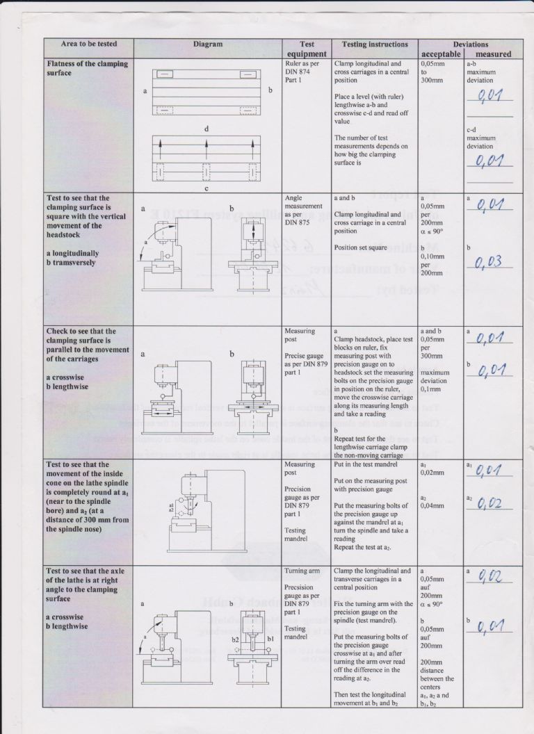

              I have no idea whether the illustration below would be of any use to you.
              It is the test report for my milling machine. The order shown is probably the sequence used in setting up the machine.
              I wish you every success with your machine.

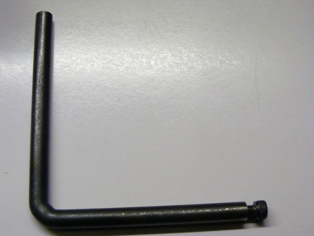

                          Raymond Anderson
                            @raymondanderson34407
                            This is what I use. En 16 bent and tapped at one end for the m6 screw to hold the Indicator. I hold the whole thing in a collet chuck. and as John Reese mentioned dont use anything on the table, just make sure the table is clean and read directly off it. This one has a leg of 120 long so gives a sweep of 240mm.ind holder.jpg

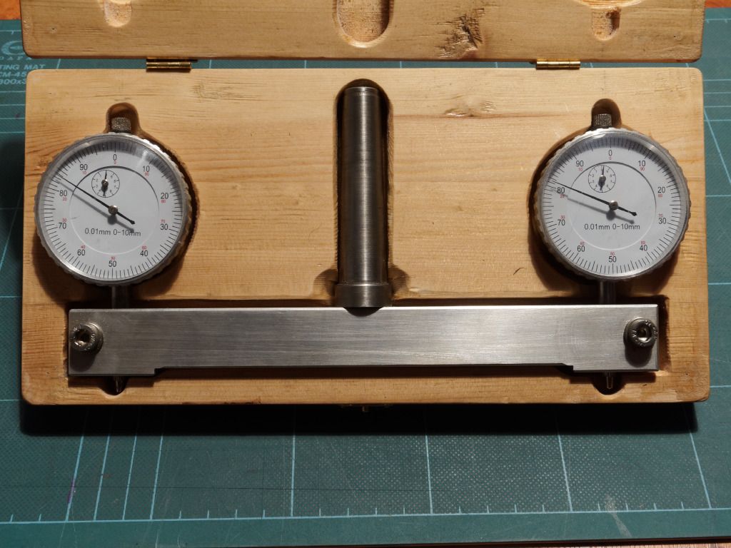

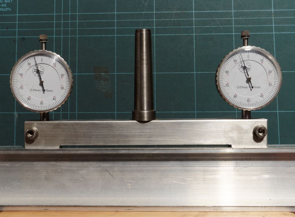

                              I built a spindle square a while ago having read this thread on Model Engine Maker.
                              Seems to work well enough and is a lot less faffing about then using a single clock gauge.
                              I bought two cheapo metric DTIs off ebay, nothing special and something like £4.50 each.
                              Here's a couple of photos to give you an idea, but I can't show it on the mill, as the Centec's in Sheffield, and there's something on the Westbury at the moment over here in Buxton.
                              I made it pretty much according to the aforementioned thread, but on a 2MT arbour as that's what's in the spindle both my machines. I was quite pleased ,when having fitted the arbour to the crossbar, I popped it in the Myford taper and clocked both the bottom two faces. No discernible difference with a 1/10s DTI.
                              Spindle Square
                              And one to show it's set up correctly before adding to a milling machine spindle
                              Spindle Square-2
                              All the best
                              Bill

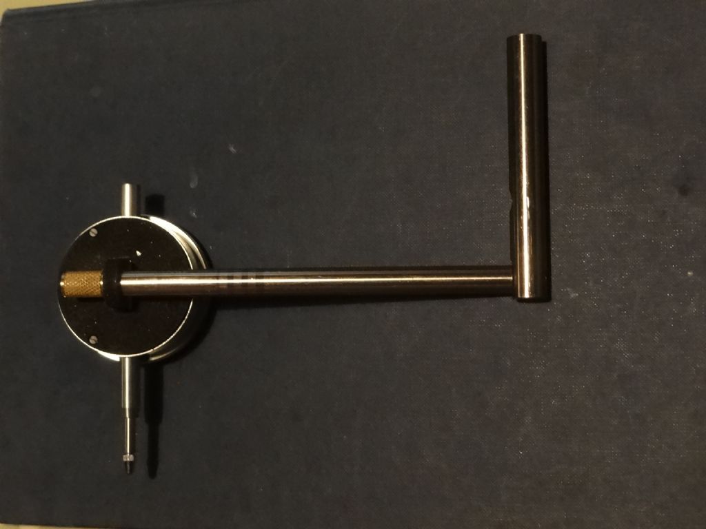

                                Inspired by John, Raymond and Bill I knocked this up today. Quick straightforward projects producing a useful tool are very satisfying, even if it's not as posh as Bill's double DTI!
                                With hindsight there's a design fault. It would be much easier to grip the DTI if I'd made the knurled brass knob 30mm longer. As it is the back of the DTI gets in the way of my fingers. Never mind, I've learned another lesson.
