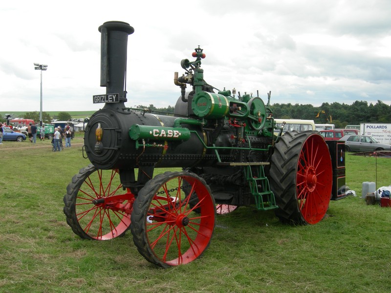

                              It’s a pity you gents aren’t building North American traction engines. The real ones built around 1880-1930 had no rubber tires, steel only, so no rubber for modelers now to worry about. Very few paved roads existed in the time they were used in rural NA.
                              No hornplates on NA engines either, and many engines had the engine built on a separate engine frame, so crank to cylinder centre, and general alignment, was not affected by boiler heat and did not strain the boiler.
                              Oh well. Hope your tire/tyre fastening goes OK.

                                    The bike spokes may not be to your taste, but they actually worked OK, as they were between 5/8″ and 1″ diameter and there were lots of them. There were quite a few engines made with flat spokes too though, Reeves, Sawyer Massey and George White to name a few. The Geo White basket style flat spoke wheel were known as one of the toughest.
                                    I agree today you can see many steam traction engines in USA and Canada with rubber fitted, but I assure you this was not how they were offered originally. people fit the rubber today if they are moving their engines on public paved roads to avoid damaging the pavement. Strips of chevron style tread used pneumatic tires are often bolted on the steel wheel drums, others fit rubber lugs in place of the iron grouters fitted originally.
                                    As to other comments/opinions about appearances of one engine vs another, books closed or open: for me it falls in the category of things that polite people really ought not to comment on. Other things in this category are the appearance of family members, pets, cars, religion etc. I don’t offer comment on those items myself.
                                    I have rarely seen a steam engine from anywhere in the world I didn’t like the appearance of, or some aspect of it. However, if some must make comments I guess we have to indulge them.
