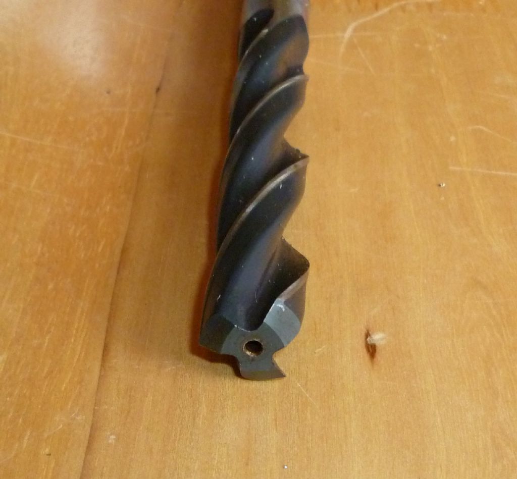

                          #93858
                          David Clark 13
                            @davidclark13
                            Hi There
                            Photo of a core drill. They are useful for opening a predrilled or cored hole but not a lot of use for finishing a hole.
                            regards David
                            Edited By David Clark 1 on 06/07/2012 21:49:02

                              #93873
                              John Haine
                                @johnhaine32865
                                I have one bought from Tracy Tools just under 3/4″ diameter. It needs a 3/8 hole to start and is very useful to remove lots of metal quickly and without chatter when you want to bore a big hole in the lathe. Looks just like David’s photo.
