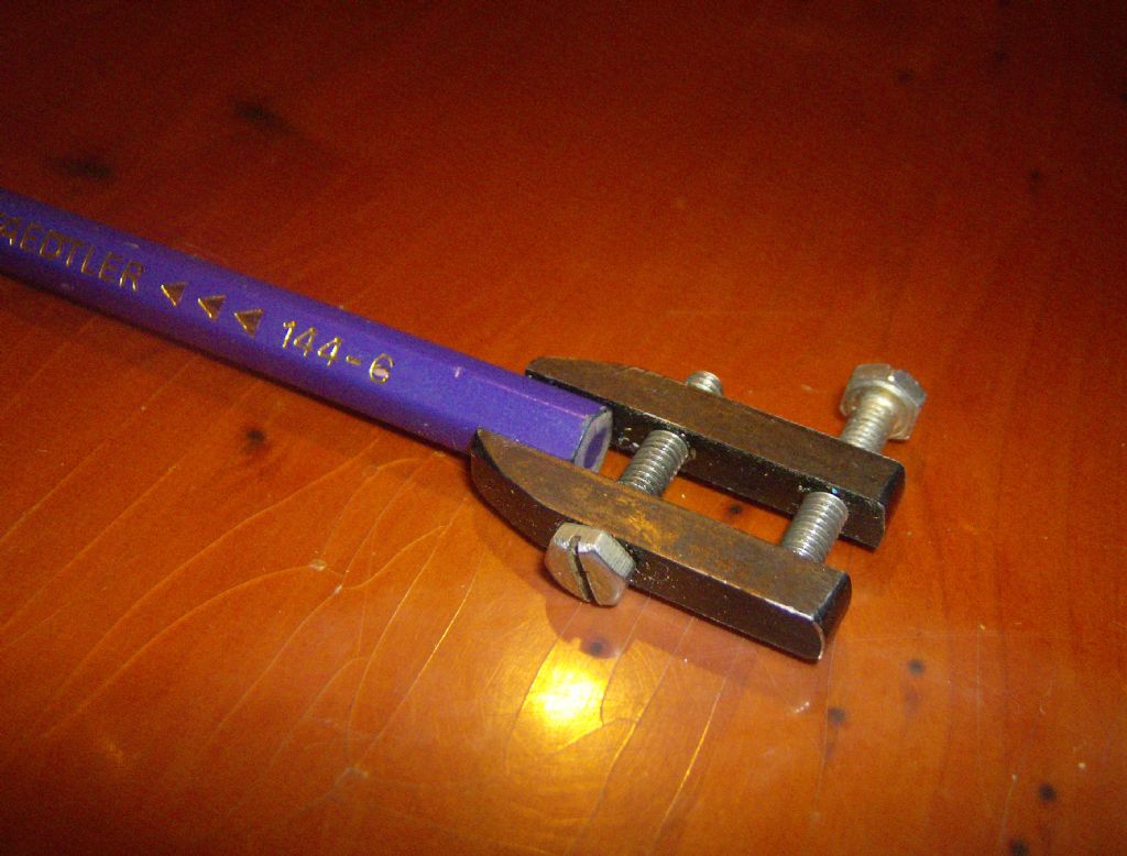

                                              Sub Mandrel
                                                @submandrel
                                                Hi Nigel,
                                                Not quite as small as yours, still 3/16", but 4BA screws because of the strange slotted hex heads so you can use finger, spanner or screwdriver…
                                                20 minutes the other evening, plus a little blacking time.
                                                Toolmakers Clamp

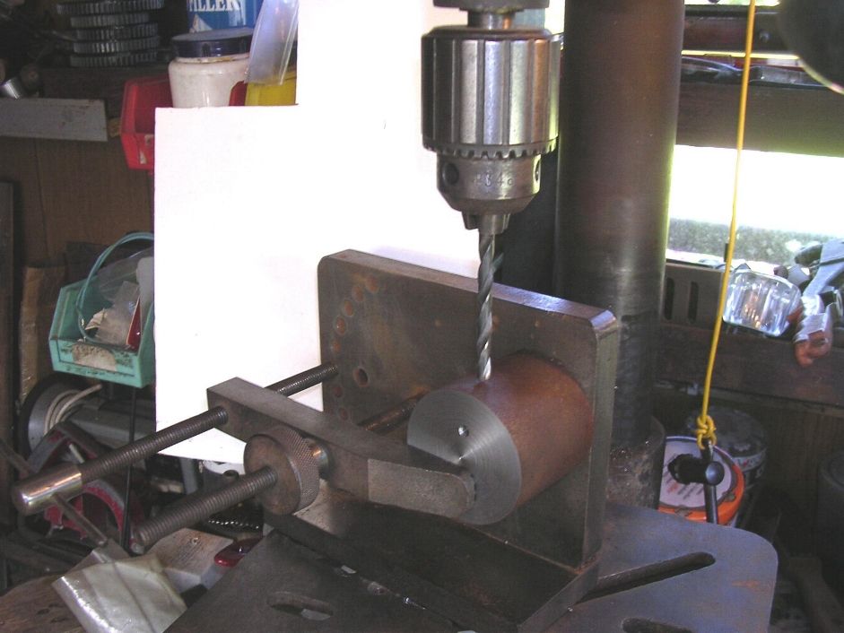

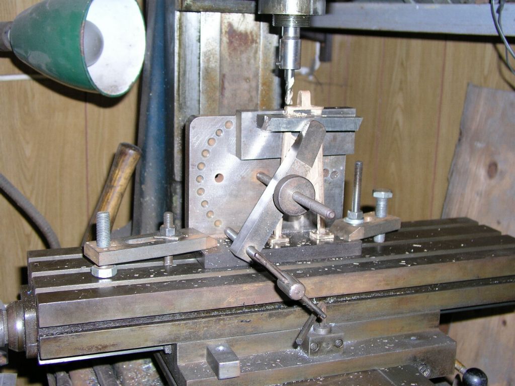

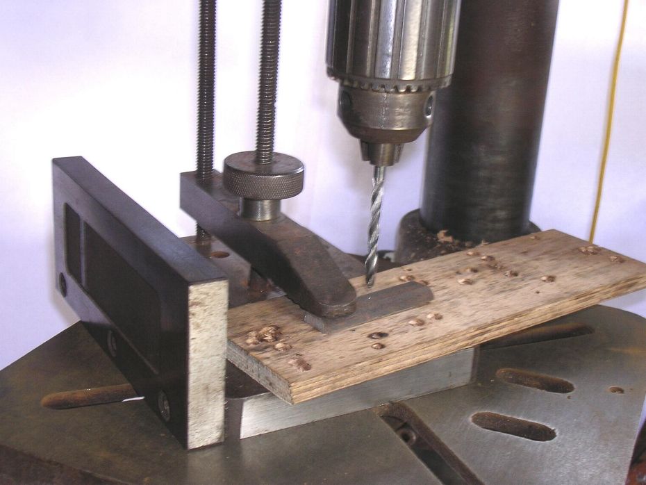

                                                Robert Dodds
                                                  @robertdodds43397
                                                  Hi ,
                                                  Like so many others I love my toolmakers clamps but my favourite was inherited from my father, a WW2 toolmaker, He made this in the 1930's so its stood the test of time. It forms an accurate angle block and can be used in at least two aspects, sometimes three depending on the component size.
                                                  I hope the three pictures illustrate it's construction and at least some of it's uses.
                                                  Bob D
                                                  Edited By David Clark 1 on 17/04/2012 12:44:29

                                                      Hi Robert
                                                      That's interesting, I was thinking of making a similar clamp, but without teh 90-degree angle -now I think I should add that too.
                                                      Also pleased to see someone else with a ratty bit of wood as an essentail drill-press accessory.
