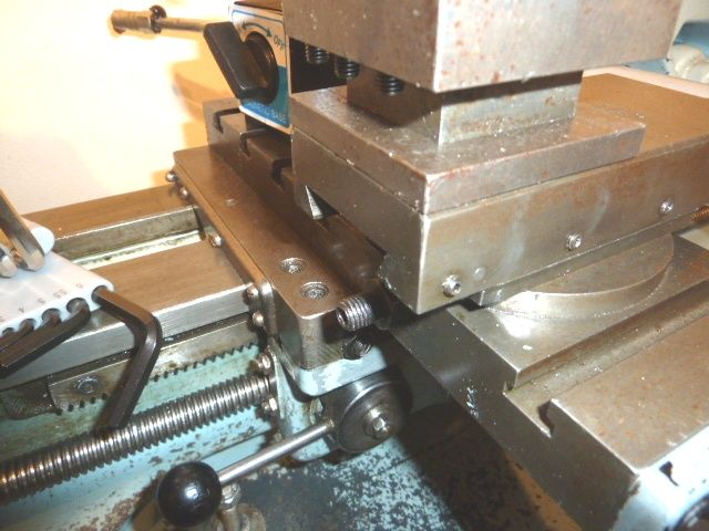

                    This is the best angle I could get.

                          Looking at this photo I can see some ready made screws, and if they were longer, could be the basis of an external detent system that clicks up to form a stop and you press down to move the tool block round.

                                        From the picture of your toolpost it looks like the thread does not go down as far as the surface of the toolpost. Are you sure that the thread does not reach the end of its travel before clamping the toolpost fully. Try putting a thick washer (That fits over the unthreaded part.) under the clamping nut / handle.
                                        As you say that the base of the tool holder is 7 mm thick and will only allow the use of up to 8 mm tools (I assume this is because the centre height of a 10 mm tool would be too high.) then to use 10mm tools the base would have to be only 5 mm thick. I do not think you will find a toolpost with the base that thin.  I removed the ratchet on my lathe as I found in a nuisance when positioning the toolpost.
                                        Les.

                                          Myford tool turret comes with a purpose made thick load spreading washer and this covers all the non threaded part of spindle . On top of that is either the box nut or clamp handle and sometimes there is a loose thin washer in there as well .
                                          Picture of tool turret shows no sign of clamping marks at all – something very wrong .

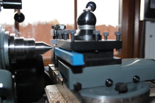

                                                  Ok Les/all that makes sense. I measured the height of a lathe centre above the top slide – it's 16.5mm on the verniers. The base of the toolpost measures 7.1mm. This means a maximum tool thickness of 9.4mm – in fact a bit less as there's a bit of takeup between holder/topslide and tool/holder. Say 9mm max. So a 10mm is never going to work. Here I've been machining the base of the the tool, you can just see that it's still a touch too high. Bit more machining to do. Then on to all the other bits.
                                                  Also you can see another annoying thing – the 10mm tool has 4mm of itself hanging out the side of the tool holder – again would have liked to see all the base of the tool supported. Even using an 8mm tool would have 2mm hanging out. Not the best design from Myford. So the allen head bolts are only gripping the tool on the very inside – plus the bolts seem a bit undersized to me. In future I think I'll be buying 8mm tools.
                                                  Another problem resolved was the ball lock handle – you can see I've added a couple of washers simply because when tightened the handle was positioned directly over the work, I couldn't see anything – very annoying. Now the handle sits on the other side when tight.
                                                  I've removed the ratchet for now. When I tighten the toolpost down I can still shift it by hand with a fair amount of arm power. I guess those sorts of forces don't come into play when machining – however I'm still surprised it's possible.

                                                      There is no way you should be able to move the tool post by hand when tightend down. Are you sure that the conical shaped spacer is not in contact with the shoulder at the end of the thread. Try putting a large washer (Larger than the diameter of the bottom of the conical spacer.) under the conical spacer. The hole in the washer must clear the unthreaded part of the hold down stud. See Michael Williams comment about the lack of any marks on the top of the toolpost due to the clamping force. Also make sure that the bottom face of the tool post is not convex. Ideally the clamping force should be at the outer edge of the toolpost. Make sure there is not a radius on the bottom of the stud which contacts the hole in the tool post before the before the bottom face contacts the topslide.
                                                      Les.
