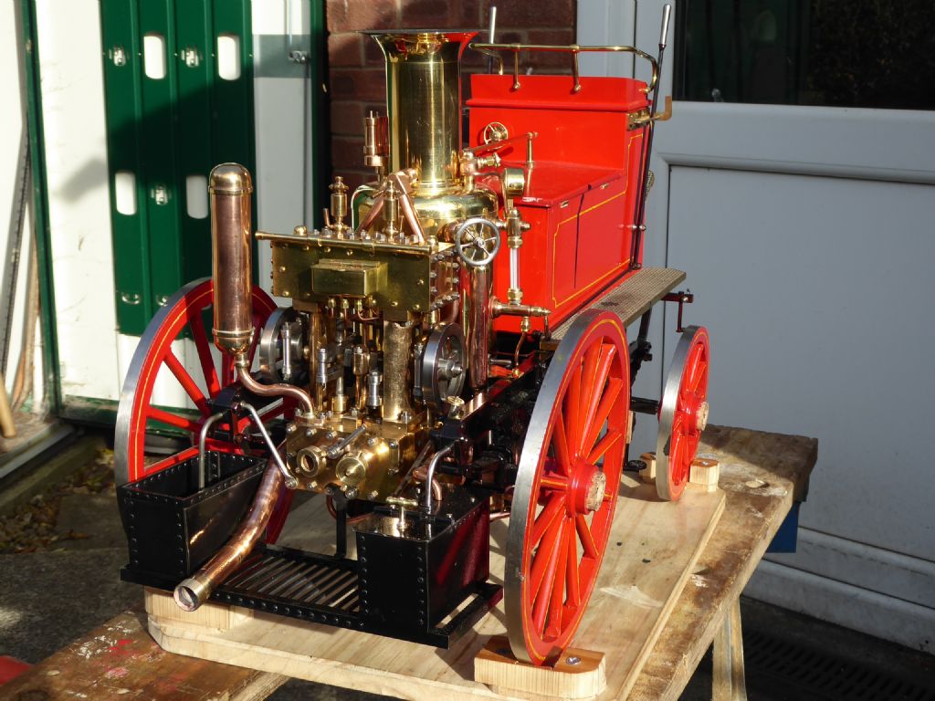

      Hi I'm new to this forum . Does anyone have a bright idea for cleaning diamond wheels without dressing them . They can clog over time and I do find dressing them to be a bit of a pain . Just finished a Shand Mason if anyone is interested .

          We're always interested Jeff; any pictures?

                      Thanks for the replies I will have a stab at cleaning said wheel . I ain't much of a computer man life , is too short , I will attempt to add some photos of the Shand Mason but anything may happen .
