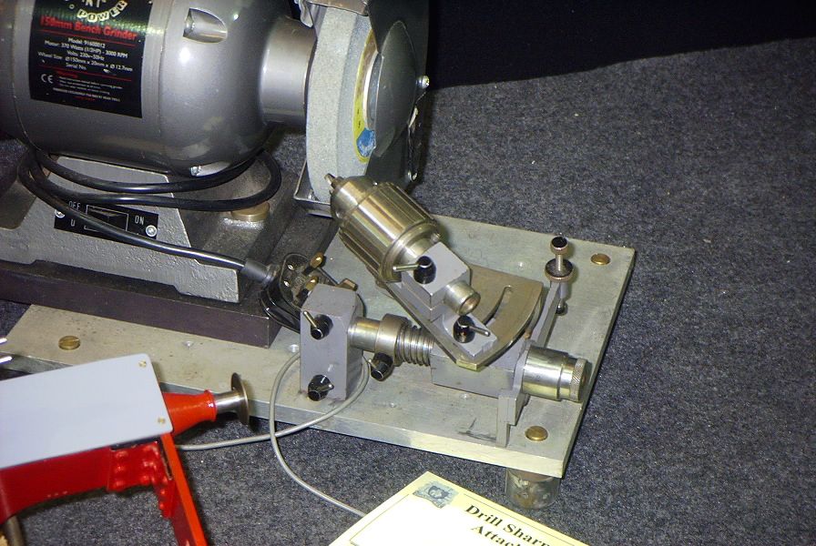

        @philh196021
        I have a Machine Mart style 6" bench grinder which isn't particularly brilliant for grinding HSS tool bits. I am thinking of using it as a basis for a simple but effective tool and cutter grinder. Has anybody done such a conversion. I did try a search on here but didn't find anything along these lines

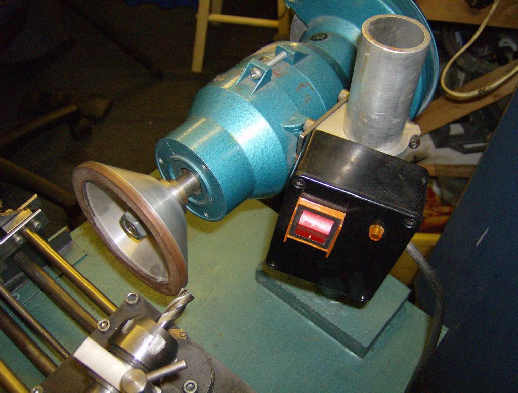

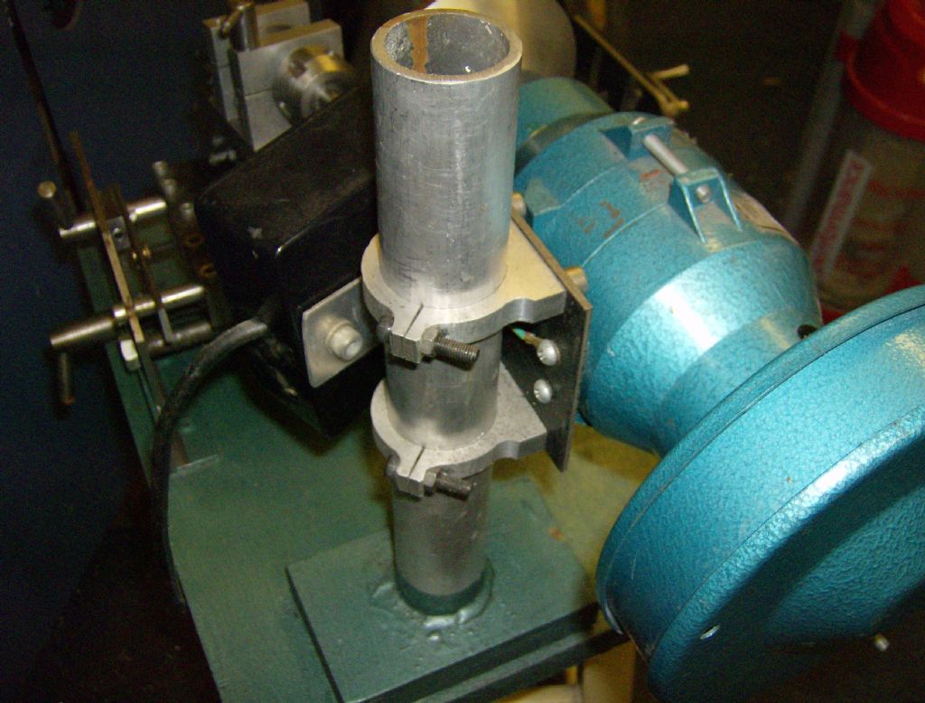

                  Bob Mc
                    @bobmc91481
                    I use one of those diamond grinding wheels on my cutter grinder (pic below) but don't use it for sharpening hss cutters .. they are only intended for carbide.
                    it clogs up and the wheel can't be dressed again…unless someone knows differently..!
                    …Bob…

                        The Caseley-Colier is a design that can be further simplified and is a sort of easy Quorn. More pics in my album to understand the concept, reduce to single rod and bar/tube pivoting upstand. Then you have the Tinker even simpler (no picture, google it)
                        here is another simple design, seen at a Bristol exhibition.

                          Or CBN for hard and High Speed steels – much better finish and control. Although if just putting the fine edge back, you can safely do tungstons on CBN, and HSS on Diamond. At very low DOC and if the wheel particles and tool are not allowed to get too hot, the Diamond will suffer no ill effects with HSS. I regularly mix and match with no problems.
                          Don't do low carbon steels on either wheel type – they just clog up.
                          If you are clogging a diamond wheel when grinding HSS, it is most likely due to high removal rate and heat – the diamond dissolves in the steel with high heat and the surface looses the cutting ability. Very difficult to recover. It's the heat at the particle cutting edge that is the issue, not the heat of the wheel – although that should not run at hundreds of degrees C anyway!
                          The particle bond method also plays a role – some have a resin bond that can soften under too much heat and smear over the particles – giving the impression of a clogged wheel – this applies to both diamond and CBN wheels.
