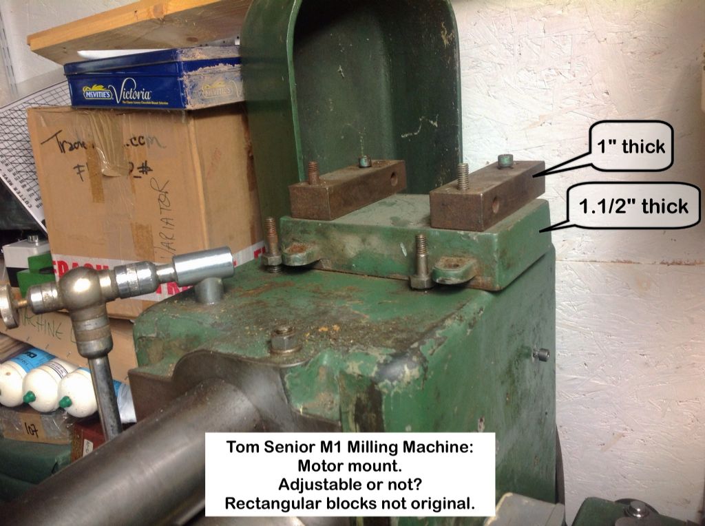

        Another project underway replacing the single phase motor with one of the 3-phase I have, they being a Stromberg 1.1kw and Power Plus Motor 1.5kw motors.
        One of them to be fitted to the Marlow mill, but not sure which yet – advice?
        The photo shows the original TS motor mount with packing blocks added to raise the 1-phase Clarke motor it came with.
        Advice please for the following:
        There is no mention in the manual about belt tensioning, but the photo copy, page 5, shows what appears to be the studs having been screwed out of the column to achieve this.
        Is this the correct way to tension that long power belt? Something doesn't quite gel.
        With the packing blocks, the belt was far too tight for my liking.

            If you just support the motor on long studs it will probably vibrate badly. Thinner blocks and 'shimming' to taste with decently arge washers would be better. The raising blocks could be made of wood to allow easier adjustment of thickness though it would look a bit 'naff'. Other possibilities that might be worth considering are some blocks of vibration dampening rubber, pluss washers to fit.
            wrt motor choice they do say use a bigger motor with VFD than you would straight. And a horizontal normally gets a bigger motor than a vertical so I would say use the 1.5 on the Senior and see how it goes. 2HP without a VFD is way over the top for a small mill though. The 1 ton Victoria horizontal is only a 3HP I think.

              If it were me, i'd remove the plates if they are not needed, and mount the motor on four short studs screwed into the machines top casting. I would mount the motor with nuts beneath it for adjustment. If you were to use one of the link type drive belts i think you would get the length nearly perfect and do any remaining adjustment with the nuts beneath the motor.
              If you are only going to use the machine for horizontal work i doubt you will need to drive the machine very hard at all. When i use my tom senior for horizontal cutting, i only run it at about 120 rpm or less and it removes plenty of material without any fuss.

                Thanks for the two suggestions.
                Will probably mount the motor directly onto the column.
                Suggestions please on what type/grade of link drive belt I should use.
