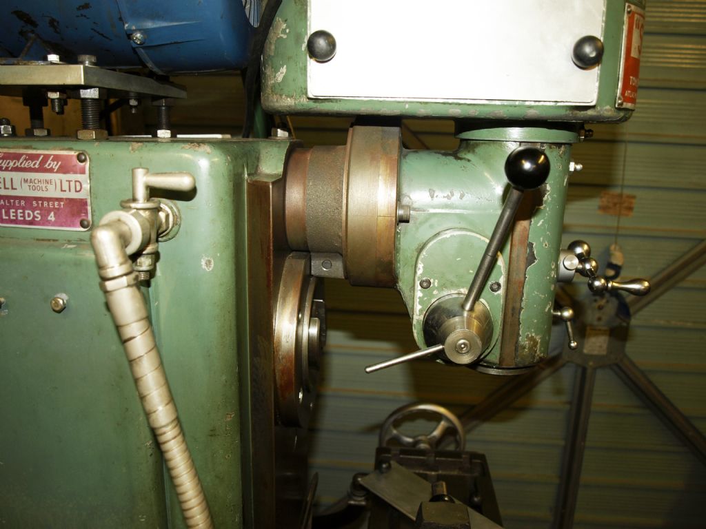

      Yipee, I’ve just taken delivery of a Tom Senior M1 with both horizontal and vertical features included. The vertical head is the S-type with its own drive motor.
      Steve Cox of Landylift collected it from Preston and brought it down to Essex this morning.
      Can’t recommend Steve highly enough..
      Now I’m even a more merrier miller., let’s get machining.

              #70378
              The Merry Miller
                @themerrymiller
                I don’t know if this helps David.
                Len. P.

                    David, some more info.
                    The head is a stepped four pulley arrangement with poly-vee belt drive.
                    I notice from an early manual they were three speed pulleys giving 750, 1450, and 2800 rpm using a conventional “A” section vee belt
                    #70381
                    The Merry Miller
                      @themerrymiller
                      Tom Walshaw in the ME from June 17 1977 gives a run down of the V head.
                      He says the 4-step pulley gives speeds of 500, 970, 1660 and 2800 rpm.
                      He doesn’t say what speed motor for those speeds but goes on to say that with a lower speed motor you will get 340, 600, 1000 and 1600 rpm.
