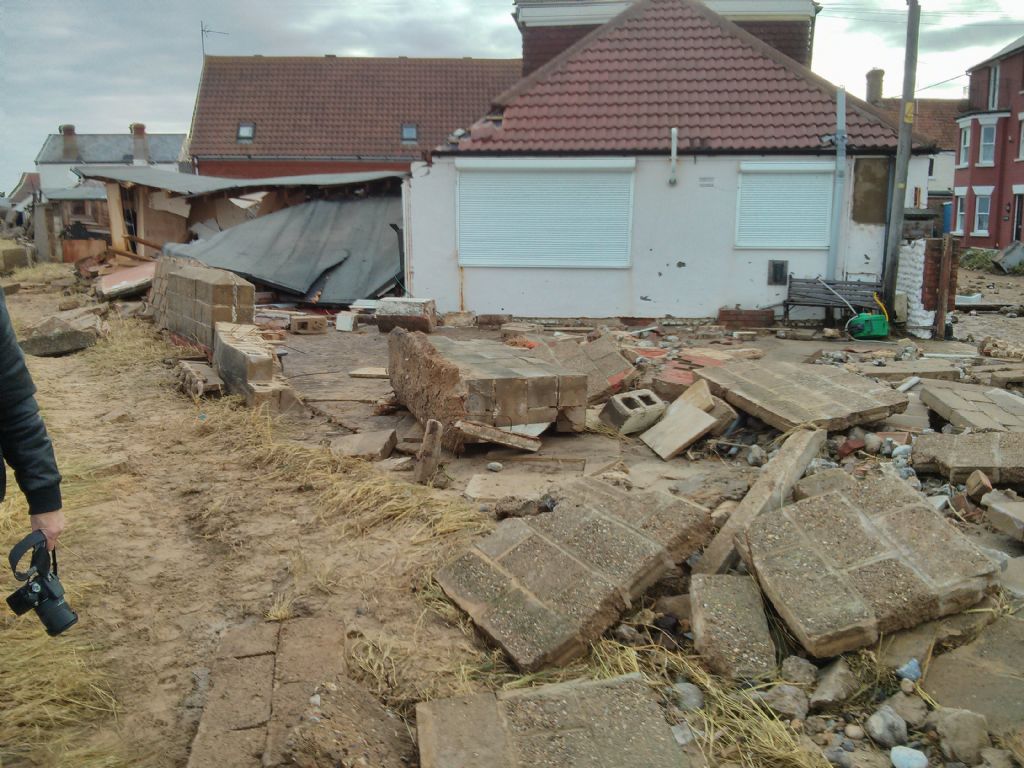

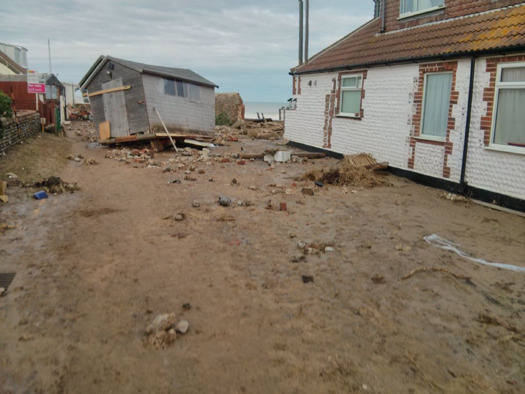

                      #141528
                      Cornish Jack
                        @cornishjack
                        This shows (large slab centre right approx) where the shed lived normally.
                        and this where it ended up, perched on the remains of the wall it destroyed on it journey. It was 'secured' by two strong tie ropes and 4 very long screws through the concrete slab base!
                        SWMBO and self were rescued from the very small bathroom window on the far end of the (just visible) upper floor. Moral – don't underestimate the power of Nature in a bad mood!!
                        Rgds
                        Bill
