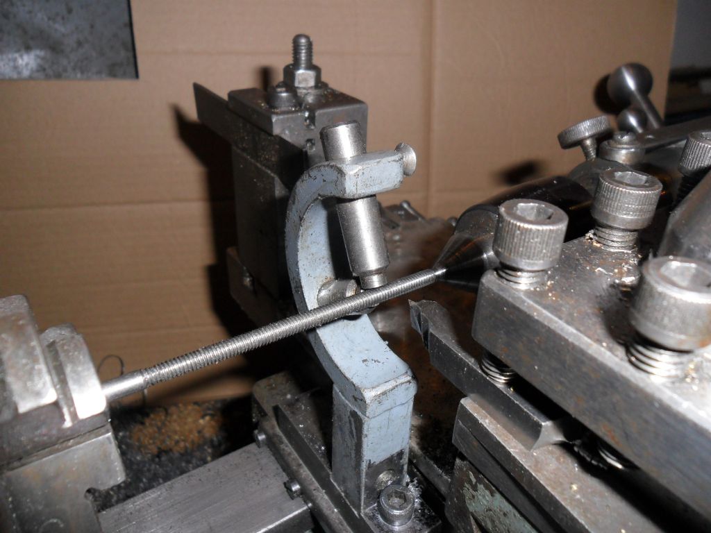

                    Or you could build John (Bogstandard) Moore's ingenius swing up toolholder and forget about disengaging OR winding the tool back.
                    Here's my version

                                                    #92077
                                                    Terry Lane
                                                      @terrylane
                                                      No lifting involved mate, the tool lifts of its own accord and rides back to the start position when you reverse the lathe motor. The only time you need to lift it clear is to inspect the work.
