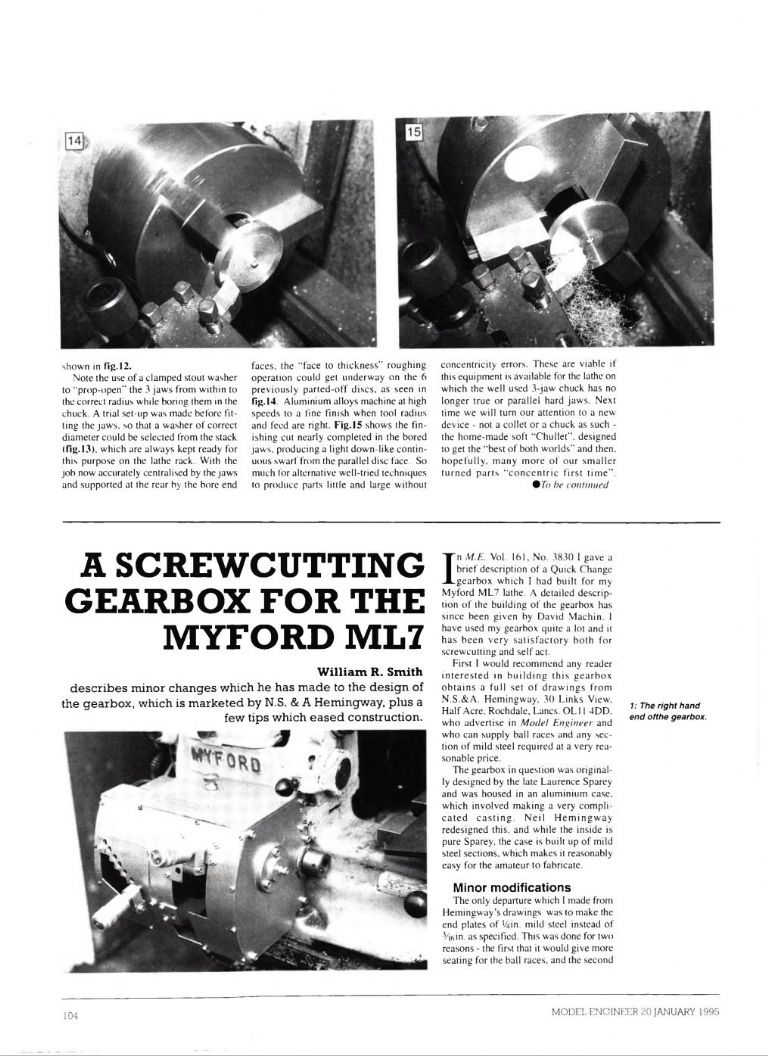

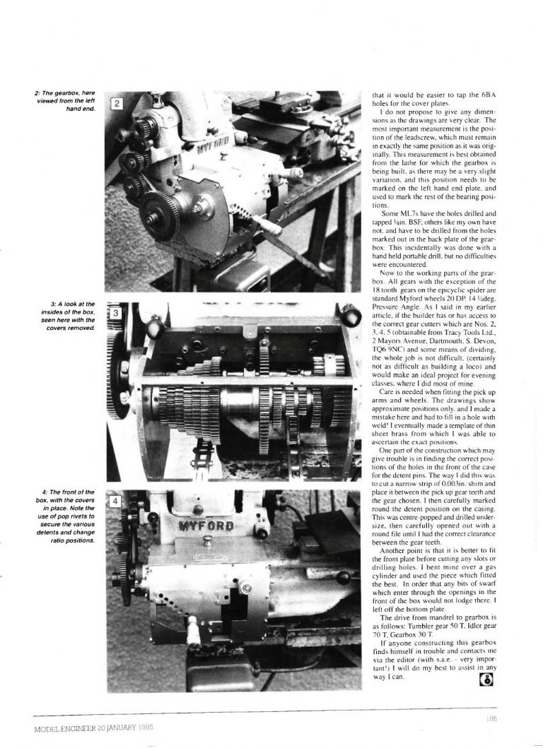

                            3985 also has a small article

                              I will scan the two articles and email them to you. It looks from Ady 1's post and yours that at least two of these were made.

                                According to one article there were a few hundred of them
                                In the post war period they would have been quite popular

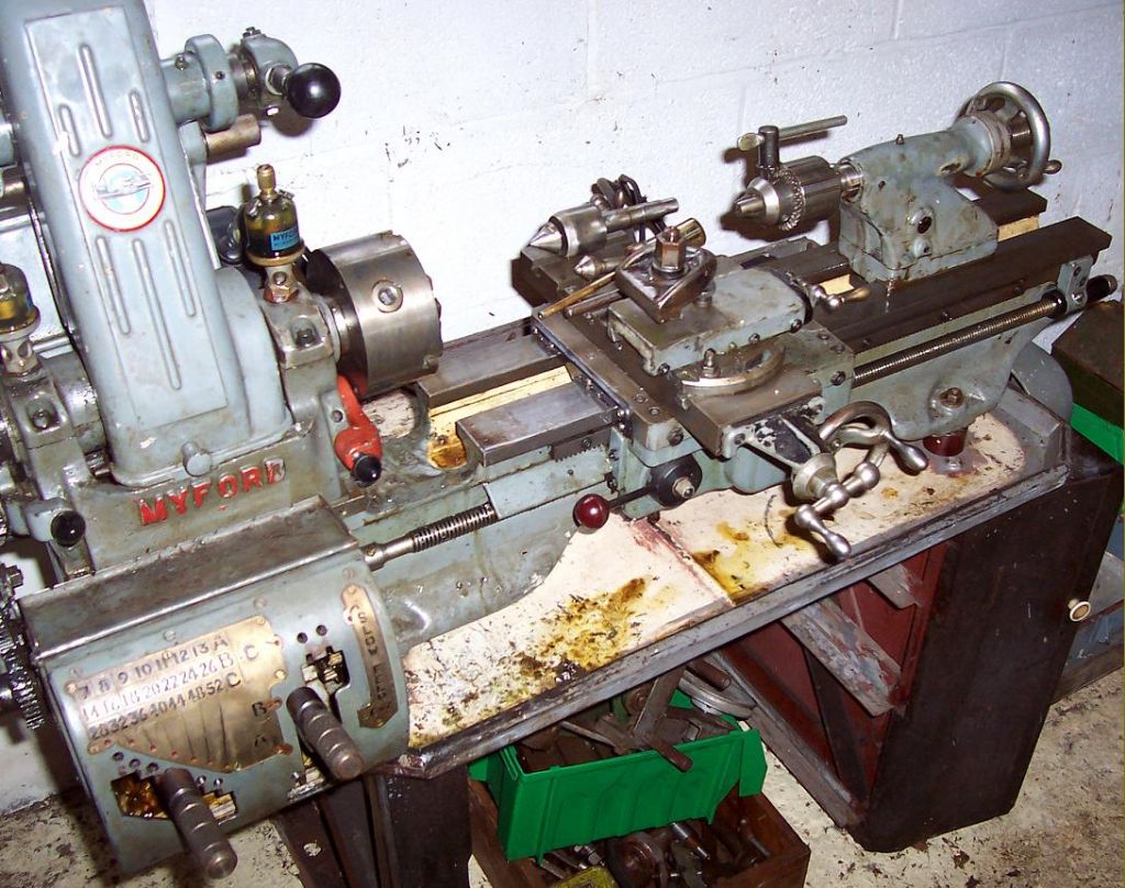

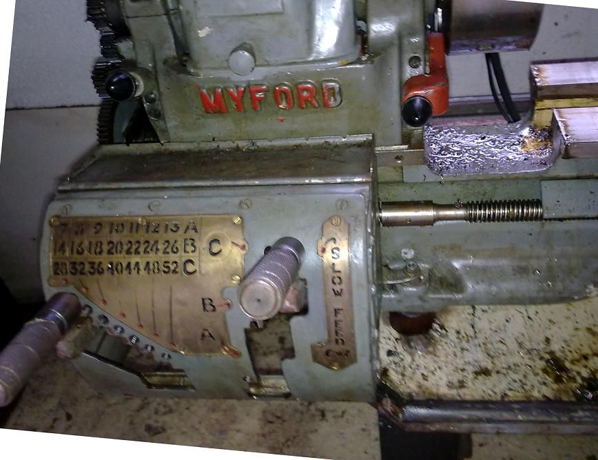

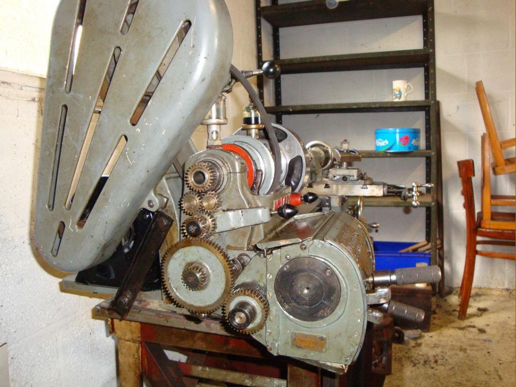

                                              sparey on ml7-r-3.jpgsparey on ml7-r-2.jpgI've just found these pics of a Sparey gearbox on an ML7 in one of my "hidden" folders.
                                              Oh the joys of old agesad.
                                              They may be of interest.
