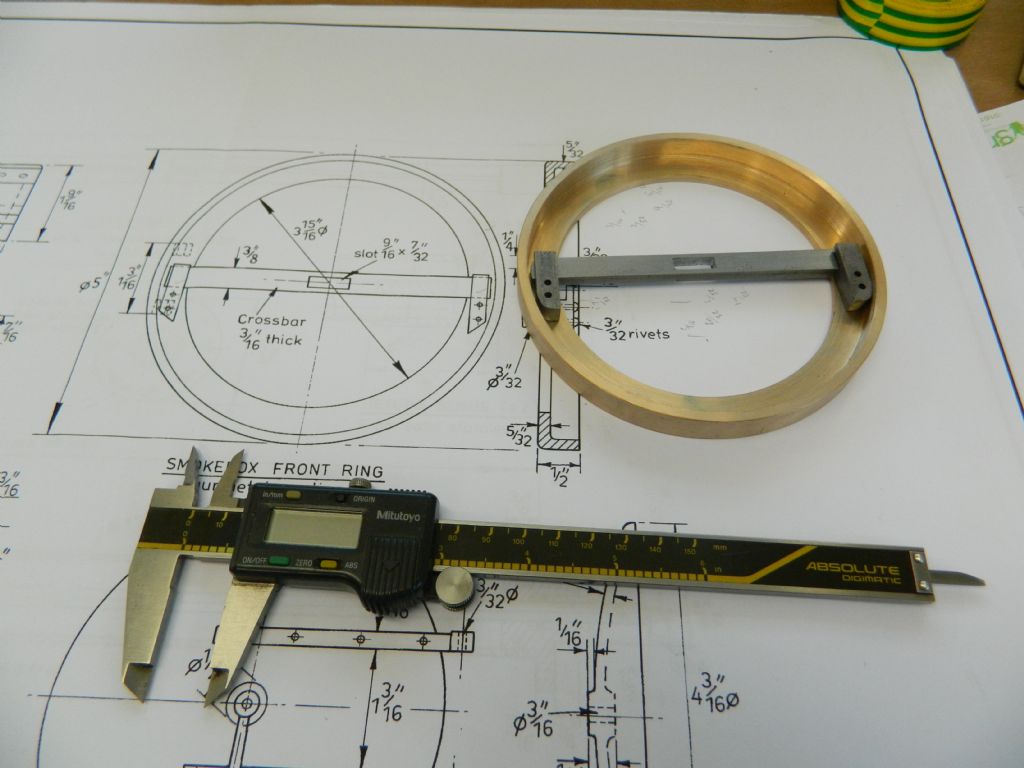

    Mike Lightfoot
      @mikelightfoot72419
      Not much but it's a start front smoke box ring for my super simplexdscn2093.jpg

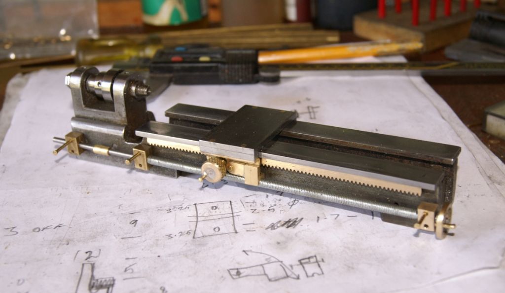

      john carruthers
        @johncarruthers46255
        …and smaller lathes make tiny lathes, so on ad infinitum…

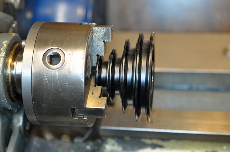

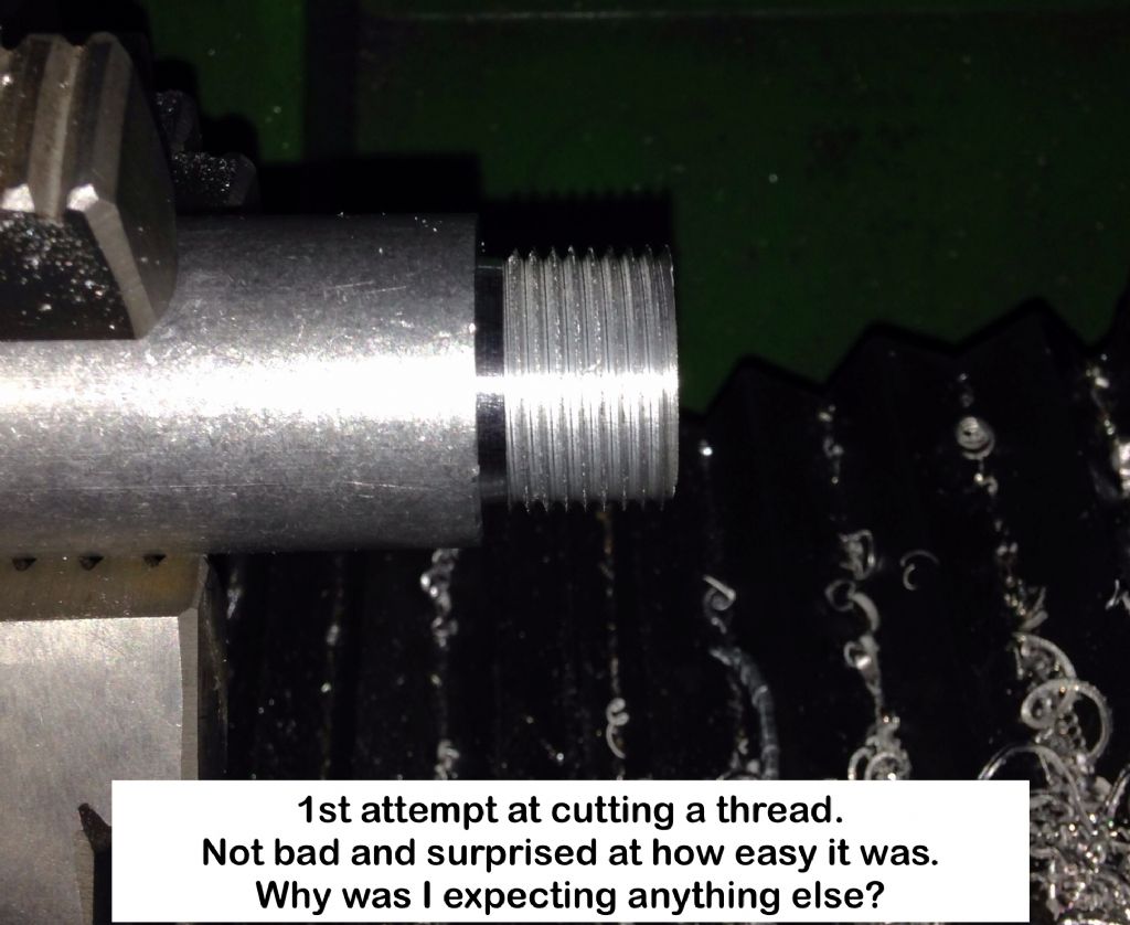

          @ouballie
          Screwcutting for the first time!
          Why oh why have I been funking doing it for so long!?
          Only aluminium, but still a milestone for me.
          First go at screwthreading

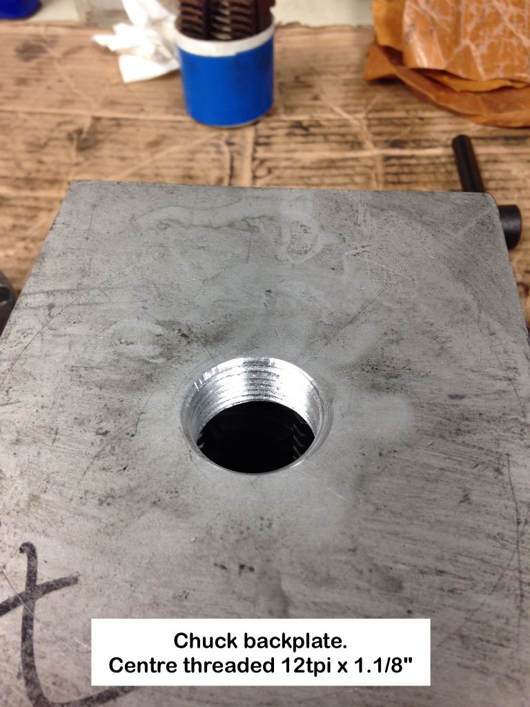

          Chuck backplate
          Geoff – Now for some Acme threads.

          MW
            @mw27036
            Posted by john carruthers on 23/10/2016 08:58:19:
            Very classy, this is coming along very nicely, keep up the good work! smiley
            Gets any smaller you'll need tweezers and a microscope to see what you're doing!

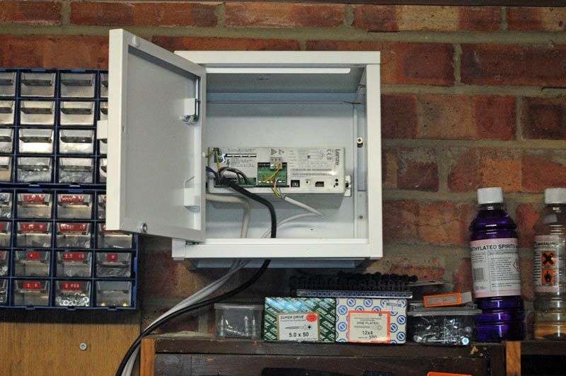

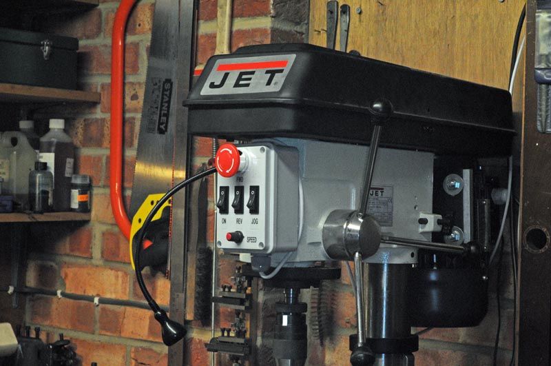

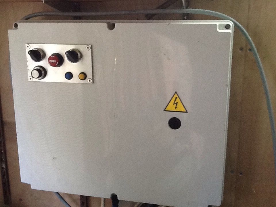

                        Living on the edge today. I've taken the plunge to convert my drill to 3 phase VFD, via some EBAY purchases. The 3 phase motor has 19mm shaft instead of the 16mm on the original motor, so the motor pulley needs boring out. This was the only way I could think of to hold it. Precarious or what? And it's an interrupted cut because of the key way.
                        Remarkably drama free smiley. Pulley is CI.
                        Inverter was a S/H industrial cabinet mounting unit, pre-programmed and wired to the remote. I've installed it in a tin box from IKEA mounted above head height.
                        The remote unit replaces the original ON / Estop
                        Motor appears to run at 900rpm at 50HZ and the inverter goes from 0-60HZ. Top speed is slightly less than before ( 2066 rather than 2580) but I can put a 1/2" drill through steel with the pulleys left on the highest speed so torque is adequate at the lower speeds. I use the Pillar tool for small drills anyway. So, dead chuffed.
                        And, further to previous discussions: The inverter doesn't trip the RCD smiley. However, with the drill powered up, I switched on the mill – lights out sad. Seems the earth leakage is adding up but I can live with that – I just have to remember not to switch them both on during Strictly.

                        martin perman 1
                          @martinperman1
                          Rod,
                          Make sure the cabinet is well ventilated as inverters create a lot of heat and when they get hot they pack up.

                          Roderick Jenkins
                            @roderickjenkins93242
                            Martin,
                            Thanks for the heads up. Half the unit is heat sink but I'll keep an eye on it.

                            #264277
                            martin perman 1
                              @martinperman1
                              We use Siemens inverters at work, they are in control boxes with fans pulling air through the box, if the fan packs up and is not noticed the inverters cook which then kills them.
                              Martin P

                                  Nice installation, Rod. Can you point me at that box? Is it a household safe?
                                  #264306
                                  Roderick Jenkins
                                    #264307
                                    Roderick Jenkins
                                      Forgot to mention: I was looking for a piece of scrap to make a 19mm plug gauge. A dog end of bright drawn 3/4" mild steel was the usual 2 thou undersized – exactly 19.00mm smiley
                                      #264310
                                        I'll look for that next time I'm in Ikea. Do people really use those to keep handbags and toys in?
                                        Easy to fit a small 240V fan in.
                                        #264311
                                        John Stevenson 1
                                          @johnstevenson1
                                          They do a bigger one at 350mm x 350mm for £19.
                                          Ideal for a CNC control box, as Neil says fit a fan and a set of drivers and it'd all neat and out the way.

                                          Steve Pavey
                                            @stevepavey65865

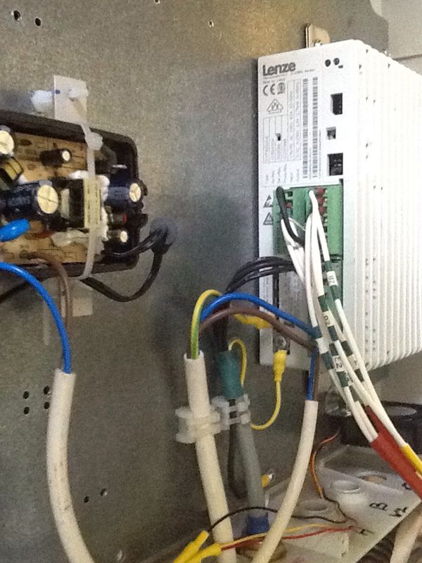

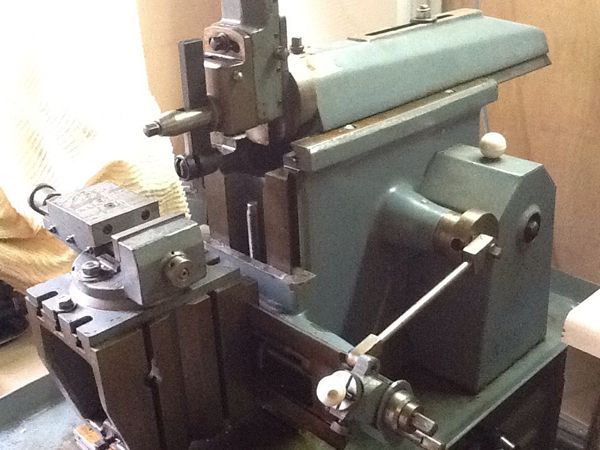

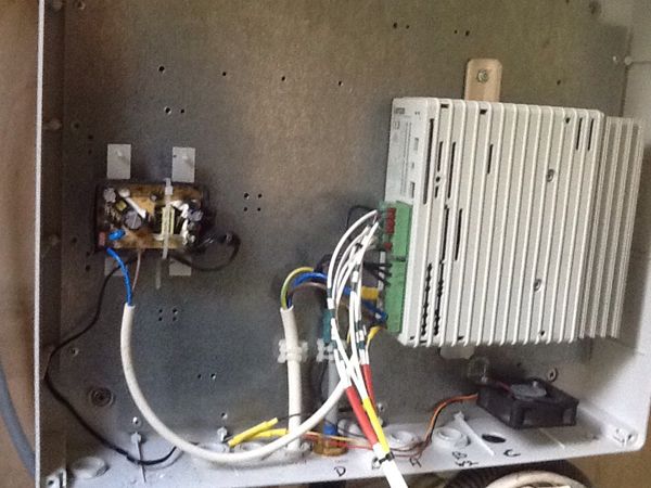

                                            Following on from Rod's post I too bought a (Lenze) vfd from eBay to run my shaper:
                                            My box was a secondhand enclosure from the local small-ads:
                                            For cooling I used a 12v computer fan running off a power supply liberated from an old router:
                                            The inverter was from eBay, very cheap but it came with the incorrect keypad, so I have no way of setting the parameters. It seems to run the shaper motor ok but time will tell. However, if I could find someone willing to lend me a Lenze emz8201bb keypad for a short while….

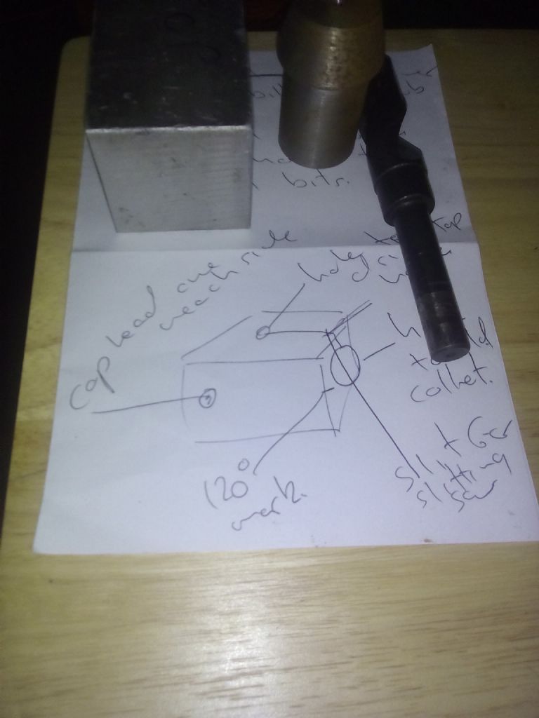

                                              got start made on making jig for putting slits in ml6 collets rather than slitting disc in grinder.
                                              drawing is very rough idea and will change as i start.
