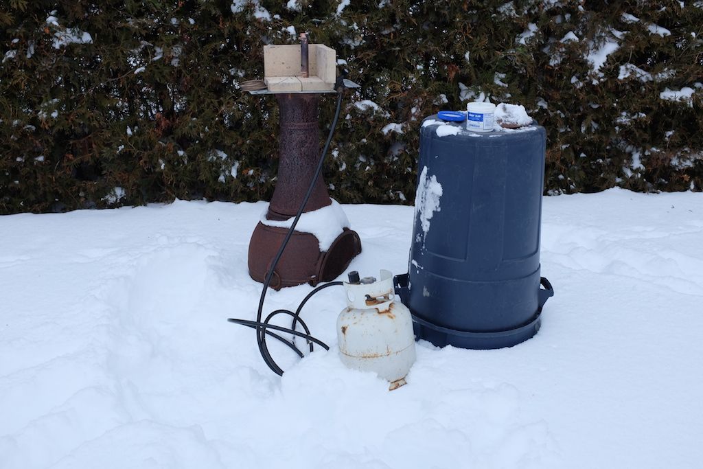

                                        More of a "how to". No outdoor workshop shed or garage; do not want large propane torches in the house.
                                        Traditionally, I have only done large parts, silver soldered, in the summer, with bricks placed on the steel barbeque.
                                        Here's a lubricator (displacement type) being silver soldered, the "stand" is an outdoor ornamental wood fireplace, with a bit of steel sheet on the top of the chimney, with bricks on that.
                                        Nice thing is, with the snow around, no problem with accidental fires!

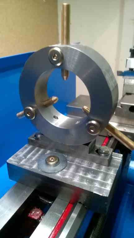

                                          My first real Project!
                                          A fixed steady for my 7×14 lathe – capacity of 60mm bar which is rather more than the supplier's steady. And really quite cheap (if you ignore the manym many hours of labour).
                                          I need to turn the ring round so I can get at the locking screws and also find a hex bolt as I can't get to the locking bolt with it near the chuck with an allen key.
                                          It could do with some better finishing, but I'm ridiculously proud of it, especially since I managed to make it without breaking either my mill or my lathe…
                                          Iain
                                          #219220
                                          Steven Greenhough
                                            @stevengreenhough56335
                                            Good job Iain. Good skills. Jealous…
                                            #219222
                                              Well done, Iain
                                              Nice job, & looks very useful.

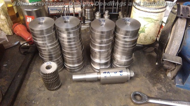

                                                  Got a few gear blanks machined up between rush jobs.
                                                  Two stacks of two sizes, both stacks are way oversize as each blank started life as an off-cut off the end of a sprocket.
                                                  I can hob eight at a time, eight 33 tooth have been done a while ago and tomorrow will start on the stack of 34's shown on the hobber mandrel
