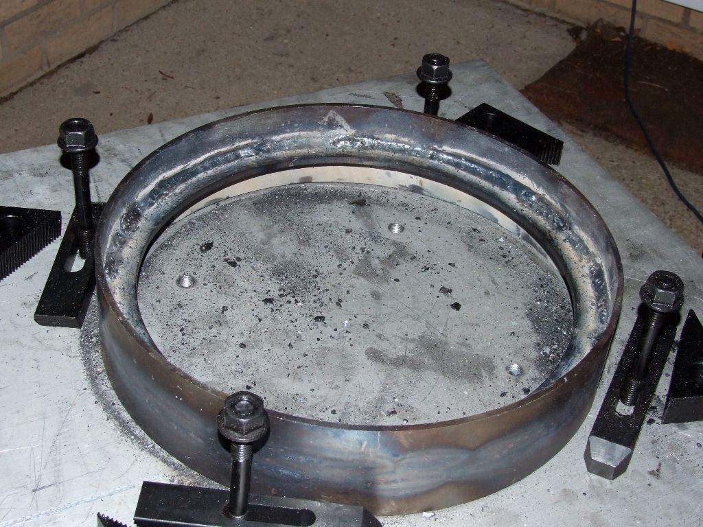

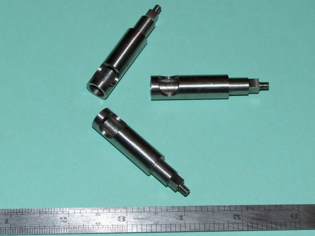

                Bit of a mixed weekend in the workshop, and carport. Yesterday I made the water pump bypass valves (303 stainless) and the parts for the operating handles:
                Today I had a first go at welding a T-ring into a front wheel with the arc welder. Not pretty, but I don't think it's going to fall apart. And I hope a whizz round with the angle grinder and some U-Pol will hide the worst bits:
                Andrew
                #220439
                  I take it that the bypass valve turns the water 90deg and sends it down towards the tender rather than passing straight through the spindle.
                  Wheel looks neat enough, was there much sign of distortion as the welding can sometimes cup the rim
                  Edited By JasonB on 10/01/2016 17:17:15
                  #220459
                  Anonymous
                    Posted by JasonB on 10/01/2016 17:16:51:
                    Correct.
                    The wheel rims are not flat, but are slightly cupped in some places, but not all. Looking at a wheel with a T-ring in place, but not welded, the rim is also slightly cupped in places. So the welding has made it a bit worse, but not markedly so. A quick measurement with a micrometer seems to indicate that OD of the welded wheel varies by about 20 thou. sad Given that the OD is 14.5" that's not bad in percentage terms.
                    Andrew

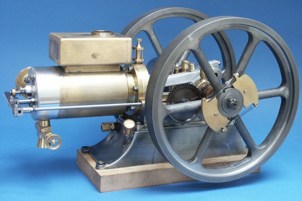

                        A short video of my now painted Farm Boy hit & miss engine with soundsmiley
                        Ian
                        Edited By ian j on 20/01/2016 20:59:34
                        #221954
                        Martin W
                          @martinw
                          Ian
                          Looks and sounds great
                          Martin
                          #221957
                            Ian, thats a very good runner and you have done a good job of blending in all the blocks of aluminium to make it look "cast". What are you using for fuel, petrol or Colemans?
                            #221958
                            ianj
                              @ians
                              Jason B
                              It's runs on Colemans fuel using the J. Ridders petrol vapour carb. The first few times I had it running I used a 30/70% mixture of methanol/colemans but for some reason it will not run on that now !
                              There's still a tight spot between the two gears but after approx. 8 hours running it's getting better.
                              I considered your suggestion of grinding paste but thought it may be a bit too aggressive.
                              Any suggestions on another hit & miss engine to build from bar stock ( I have no welding facilities )
                              Ian
                              Edited By ian j on 21/01/2016 08:04:34

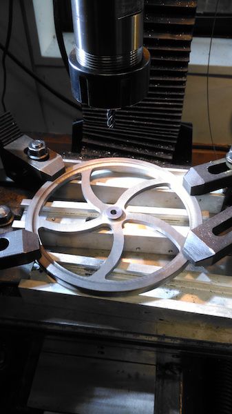

                                After spending a good portion of yesterday turning a chunk of CI into a flywheel blank I spent a couple of hours setting it up and setting the CNC mill to form this
                                Quite happy with how it turned out

                                    I like the flywheel but I thought CNC was supposed to be a quicker way? A couple of hours, good result though.

                                    Muzzer
                                      @muzzer
                                      Hi Jason
                                      Nice looking machine and a proper IC engine at that.
                                      What do the curious counterweight thingies on the end of the crank do? They almost look as if they could be part of a governor but I can't see any linkage that could connect them to a control valve, yet they are too small to do anything to increase the inertia of the flywheel noticeably. I'd put my money on a governor component but am puzzled how it would connect up through the flywheel.
                                      Murray
                                      #222020
                                        Muzzer they are indeed governor weights, have a watch of this similar Gade running, you can see how the L shaped levers attached to the weights move a "spool" on the crankshaft which in turn moves more levers that activate a latch which as the governed speed is reached will hold open the exhaust valve making the engine "miss"
                                        Static pics of the same engine
                                        There are several variation on the theam but they all basically use a weight of some sort to activate a latch.
                                        This one has a wedge shape to push the spool.
                                        And this one the weight lifts a cranked lever
                                        Edited By JasonB on 21/01/2016 16:35:57

                                        daveb
                                          @daveb17630
                                          Governing is what they do, it's a hit & miss engine, the linkage is behind the flywheel. Lovely job!

                                          Bruce Edney
                                            @bruceedney59949
                                            Posted by KWIL on 21/01/2016 15:27:47:
                                            Bruce,
                                            Kwil
                                            A lot of time spent in ensuring fixtures were not going to be hit by collet chuck – about 45min to machine.
                                            I am not sure I would want to tackle the curves on a manual machine
