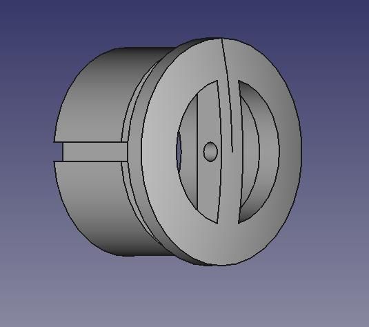

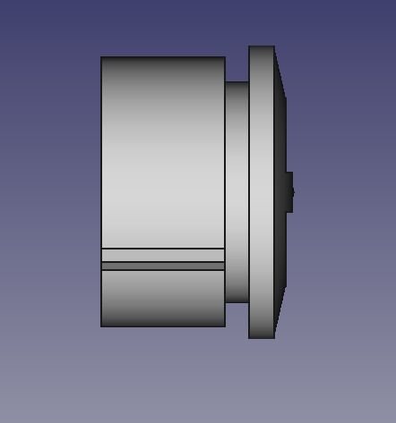

                Is there a Production Engineer in the house! She would be able to calculate the break even point.
                Where the break point is depends on many factors, but CNC competes well into the middle volume range. Multi-axis CNC machines are extraordinarily flexible and offer special efficiencies. Being general purpose, any machine that's available in the same factory, down the road, or overseas can be put to work. They can all take on a variety of different jobs. If a machine shop happens to have CNC machines idle, they can all be utilised until higher priority work arrives. High-utilisation helps overcome a serious manufacturing problem: any machine-tool that's not cutting metal is wasting loads of money! Labour costs are low because a single minder looks after many CNC machines and it might even be possible to run machines unattended overnight with the lights out. No expensive furnace, specialist staff, moulding floor, cranes, pattern-store or other foundry paraphernalia.
                Traditional cast-iron moulding is comparatively labour and energy intensive. Manually machining bar-stock with lathe and mill is probably the cheapest way of making one-offs, and I'd guess moulding is cheapest when tens of thousands are needed. CNC is in the middle somewhere.
                Would be interesting to stage a race at an Exhibition between CAD/CNC and Drawing Board/Pattern/Moulding both starting from the same moderately complicated object drawn from a hat. Like this sink overflow:
                #581257

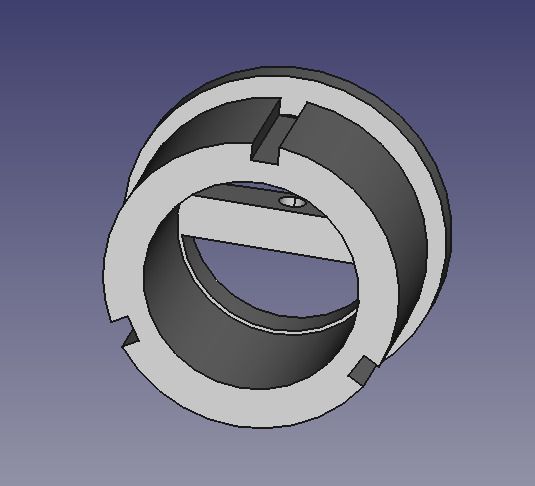

                  An interesting piece Dave but there are a few variables.
                  A you have already modelled it in CAD do I assume you will send it as an electronic file instantly over the net to one party in a modern format such as a STEP file in which case they would have a head start over the other party who would need a dimensioned drawing or your model of the prototype sent through the post and we know how slow that is these days.
                  As a CNC part its relatively easy for a machining centre to turn & bore the main shape, quick poke with a parting tool to do the undercut behind the flange before bringing in an active tool for the three slots along the side and the two half circle cut outs. The hole for the chain would be the tricky bit but a 5 axis would get in there fairly well. That s the part made and ready to go off the chrome plate. Probably 1 -2 mins a piece for mass production an 10 mins CAM for an experienced user.
                  The pattern maker will be at a disadvantage as the part will likely need machining all over externally to get it good enough to chrome, the groves and the undercut. Chain hole could be cored but that adds to initial pattern making. time and moulding time.
                  In the commercial world things like sink wastes were often a combination of the two with the rough part being cast and then visible surfaces and threads cut. Tradition would still loose out here as manually doing those even on a capstan machine is likely to be slower than second ops on a CNC and labour costs would make it uneconomic. These days they may just CNC the lot.

                    Posted by JasonB on 19/01/2022 19:09:05:
                    No, I meant a physical example to be handed over so both sides could measure it. No giving anyone a head start by providing STEP files! One team would reproduce the example from 3D-CAD to CNC, the other from a drawing board/2D CAD to mould via a pattern.
                    For extra mayhem, the mould team could challenge the CNC team to reproduce one of their mouldings and vice versa.
                    I wouldn't expect either CNC or moulding to produce completely finished items, but what was achieved would show what the two processes are capable of, pros and cons. Extra points awarded for making lots of reproductions.
                    The original sink overflow this thingy replaced was a plastic injection moulding, maybe two parts glued together.

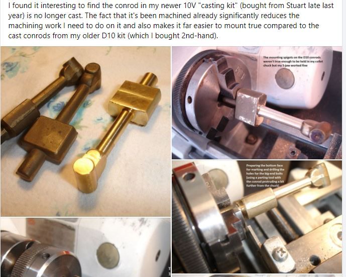

                      From a post elsewhere it's interesting to see Stuarts have dropped another cast part in favour of CNC

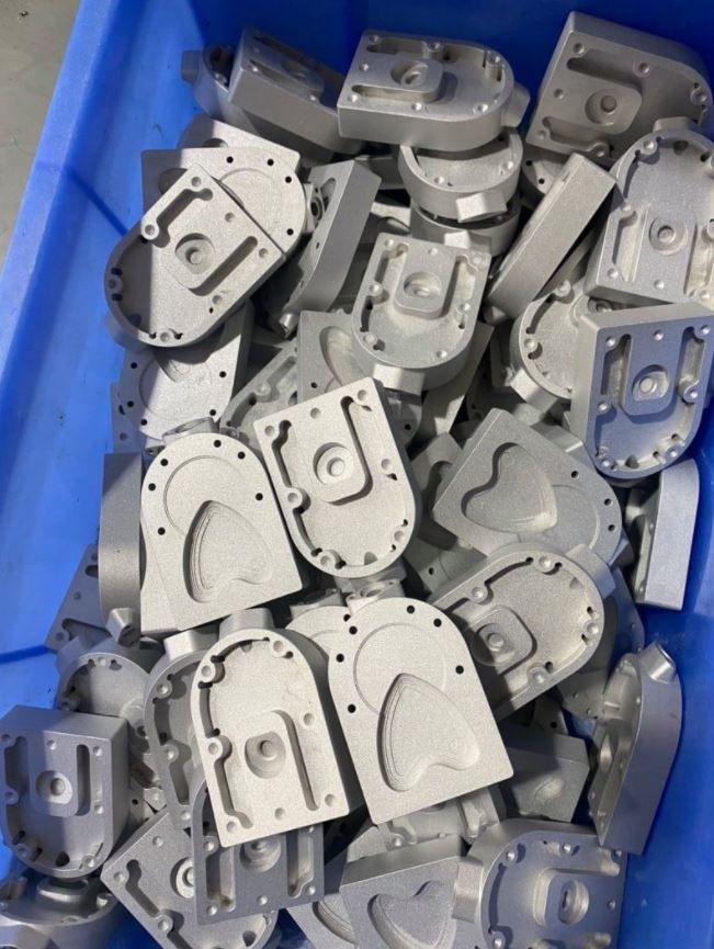

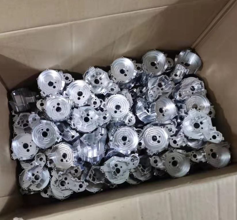

                        Commercial foundries have to make a profit. Traditional pattern and casting methods are time consuming, more so for small parts. Looking at a small static engine part there may be only pennies worth of material in it but many minutes of labour time, plus all the energy costs, and we know those only too well. When you compare that to continuously cast bar where many metres are produced in the same time. If you look at a simple static engine and take away all the fancy bits the actual bar material cost is far less than a bought set of castings. Some larger parts may need a bit of sideways thinking in order to machine them in the garage workshop, but that just adds to the experience. As an example I have a mini lathe and find it is a little shy of power when turning 5” wheels, so once roughed on one side and bored I mounted them on an arbor and used the mill to turn finish turn them.

                                  I wonder if someone at Stuarts did the production engineering calculations?
                                  It can't be because they are having difficulty finding a foundry as they have their own. Though I do see that as Bridport" they offer a CNC machining service, I'm not sure if that is in house or a local shop that they use but could explain the economics if they have a machine that won't be paying for itself if stood idle.
                                  They also do machined kits and ready to run and quite likely it is more cost effective to make these parts from a nice length of easy to hold bar than fettle and try to hold a small casting. It would be a simple matter to stop the program part way through and produce the "raw casting" and leave others to have the final ops of holes added to make them completed parts which is right back to the point in my opening post.

                                            Posted by JasonB on 23/01/2022 19:13:00:
                                            I believe that the brass components in the ST kits were originally "hot pressed" rather than cast. Possibly these items were outsourced by the the original ST and the Bridport people find it more economical to make them in house using CNC. The brass components that were hot pressed needed very little finishing and the Bridport guys seem to be continuing this tradition.
                                            Rod
